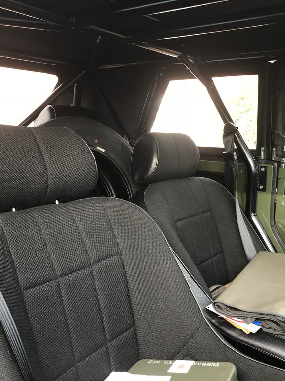

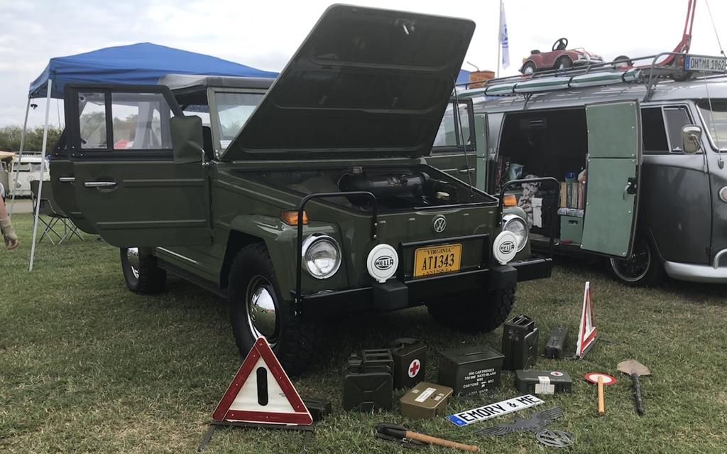

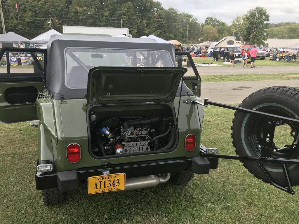

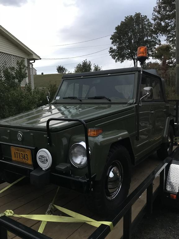

adsm08 5,214 #28 Posted November 7, 2019 On 10/24/2019 at 9:30 PM, dells68 said: Well, @pullstart checked in with me last week wondering if I’m ok. Well, I guess I’m doing ok. I’ve just been distracted by another one of my hobbies - vws. I’ve got a 74 VW Thing that I hadn’t moved in about 7 years. Emory was wanting to go for a ride as he doesn’t remember being in it when he was little. I was really surprised that the battery still had 10.75 volts and all I had to do was drain the old gas (had been treated with fuel preservative) and charge the battery and she was off. We took it to a VW show a couple of weeks ago and I’ve been slowly mounting military accessories I have for it and collecting a few more. Been kind of nice to mess with it again after all of this time! That's a slick ride, but I hear parts are hard to get. I know a VW guy who has a line on just about everything in this and several other realities, and he tells me he can't get radiators, water pumps, or thermostats for any of those old VWs. 4 Share this post Link to post Share on other sites

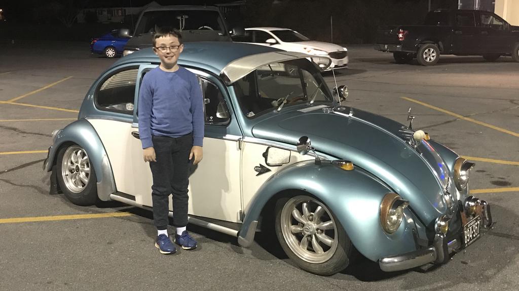

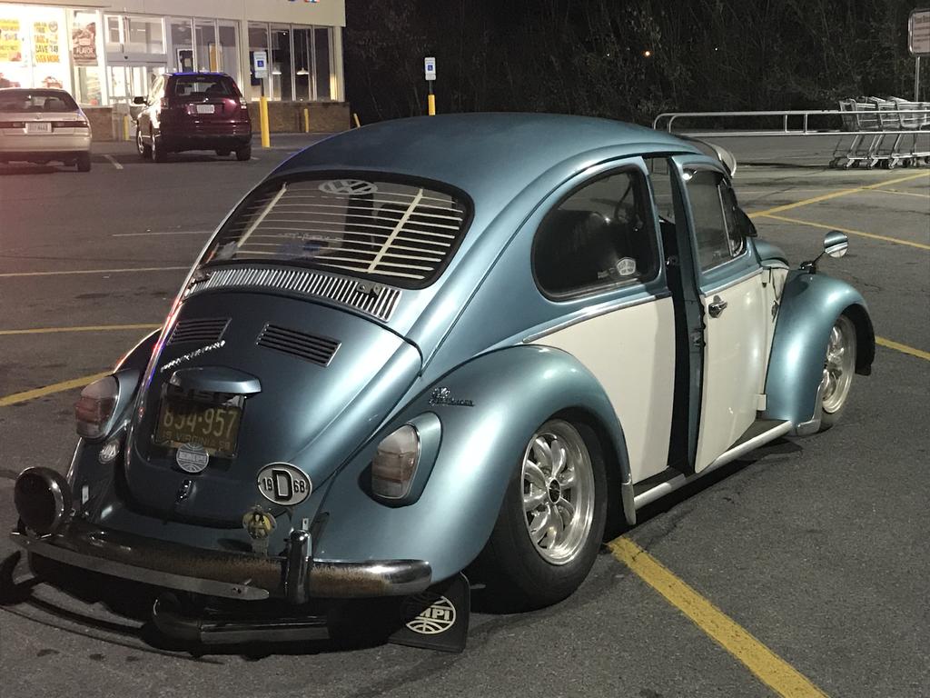

dells68 7,499 #29 Posted November 7, 2019 20 hours ago, adsm08 said: That's a slick ride, but I hear parts are hard to get. I know a VW guy who has a line on just about everything in this and several other realities, and he tells me he can't get radiators, water pumps, or thermostats for any of those old VWs. I knew I forgot something! I couldn’t find a radiator for it anywhere! Oh well, it does ok for now. Parts aren’t too bad to get - lots interchange with bugs, but the thing only parts can be a little high. Emory bugged me to finally get my bug going. These pics are of it laid out on air ride. Can’t drive it without raising it up a little😂! 2 2 1 2 Share this post Link to post Share on other sites
PeacemakerJack 11,080 #30 Posted November 8, 2019 That is a super cool little bug Dells! As you know, my kids and I really enjoy the time we get together while cruisin in our GTO. It sure looks like Emory is really enjoying your Volkswagen. Tell us some more about it. Did you buy it this way? Restore it? How long have you had it? Sweet little ride for sure 2 1 Share this post Link to post Share on other sites
dells68 7,499 #31 Posted November 10, 2019 On 11/8/2019 at 12:22 AM, PeacemakerJack said: That is a super cool little bug Dells! As you know, my kids and I really enjoy the time we get together while cruisin in our GTO. It sure looks like Emory is really enjoying your Volkswagen. Tell us some more about it. Did you buy it this way? Restore it? How long have you had it? Sweet little ride for sure Thanks Josh. Emory is old enough that he is getting into the VW’s. He’s the reason I’ve decided to wake them both up from their long slumber. He’s been really excited about riding in them and his interest has sparked mine again. I’ve actually had the bug about 21 years. It was all stock with the metallic blue paint. I’ve two toned it, replaced a few bent panels, added 67 and earlier bumpers, narrowed the front beam, notched the rear spring plates, added air ride, collected lots of accessories, then let it sit and rust after I lost interest with getting married, having Emory, and Mom getting sick and passing. They’re not going to replace my wheel horses, but rather give Emory and I something else to do together. That’s the best part!!! 3 Share this post Link to post Share on other sites
Pullstart 71,459 #32 Posted November 10, 2019 Notch the spring plates? Doesn’t that give it a lift? Share this post Link to post Share on other sites
dells68 7,499 #33 Posted November 10, 2019 21 hours ago, pullstart said: Notch the spring plates? Doesn’t that give it a lift? Nope. You can notch the bottom and reindex the plate on the torsion bars for a lift, but I had to notch the tops of the plates and reindex the plates to let it sit lower. It all depends on how many inner and putter splines you move in which direction. 1 Share this post Link to post Share on other sites
