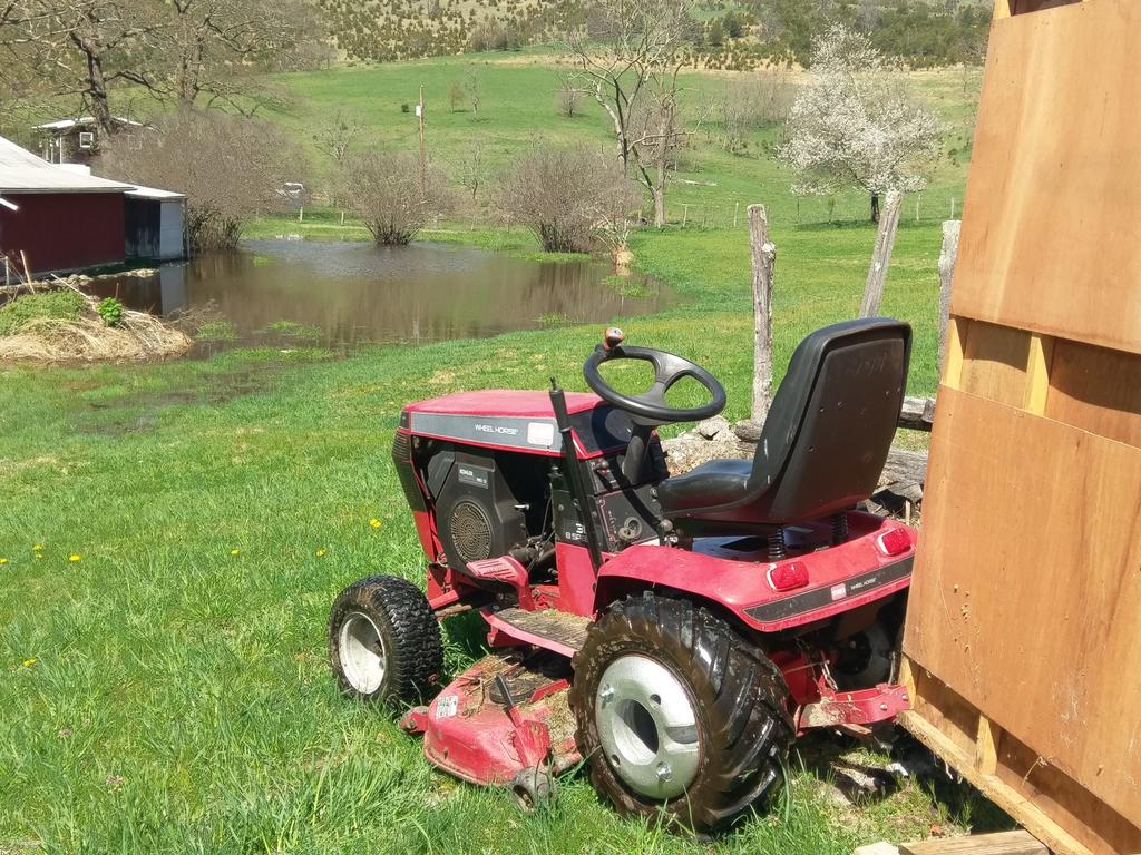

WVHillbilly520H 10,379 #9 Posted October 25, 2019 (edited) 7 hours ago, WildHorses said: The 23x10.50-12 really needs the bigger wheels from the 520 or they bow out the sidewalls too much imo. Not so with the "Deestone" or off brand ( @The Tool Crib said above) AGs like I have here on my 315-8... Edited October 25, 2019 by WVHillbilly520H 3 Share this post Link to post Share on other sites

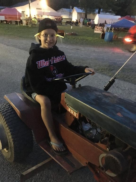

troutbum70 858 #18 Posted October 26, 2019 My commando 800 has 20 inch tires. How could I put 23 inch tires on without changing the wheels? My wheels only measure a little better than 11 inches across. Share this post Link to post Share on other sites
Pullstart 71,520 #19 Posted October 26, 2019 If they measure 11” across, are they X-XR10” tires? If they are a 10” wheel, 12” wheels will open up a whole new tire size world.. with the same bolt pattern Share this post Link to post Share on other sites
troutbum70 858 #20 Posted October 26, 2019 Tire size 20x8.00-10 on my commando 800 which I assumed are standard for it. Share this post Link to post Share on other sites
