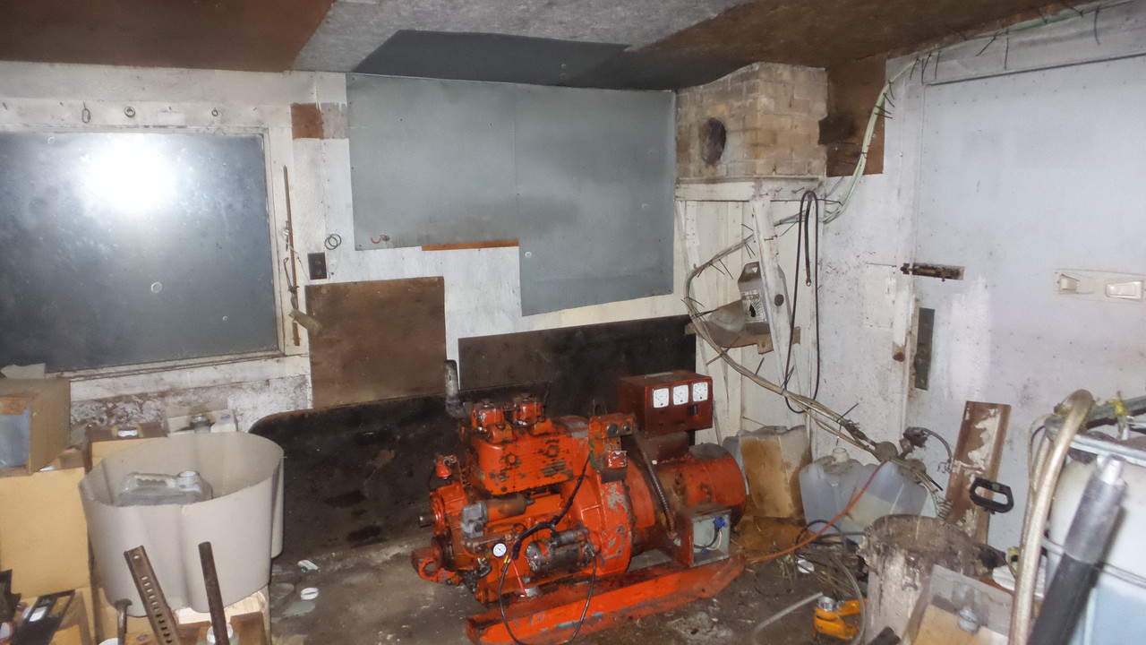

bc.gold 3,406 #13 Posted November 3, 2019 (edited) Petter is getting moved into a back room attached to my shop, this beast is heavy. Earlier to day I replaced a faulty oil pressure gauge that sat at zero, the new gauge shows 60 psi cold. If the pressure remains this high I'm going to make adjustments to the pump relief valve. Oil Pressure Too High https://highwayandheavyparts.com/n-12786-excessive-oil-consumption-explained.html When the oil pressure is too high, the engine can flood with an abnormally large amount of oil. This excess oil can get thrown into the cylinders, where it will be burnt away. Sometimes high oil pressure can be caused by an incorrect oil pressure setting or a faulty relief valve. This is from the Petter PH2 shop manual. Edited November 3, 2019 by bcgold Share this post Link to post Share on other sites
bc.gold 3,406 #14 Posted November 3, 2019 The generator has been successfully relocated into the back room the room is a total mess last summer a bear came on and tipped over a 45 gallon drum of used cooking oil. Share this post Link to post Share on other sites

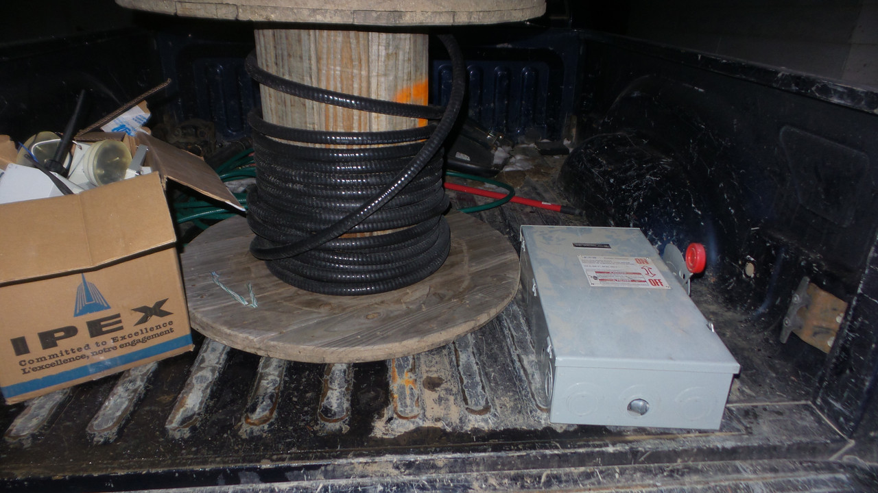

bc.gold 3,406 #15 Posted November 5, 2019 Made a trip over to my favorite electrical contractor, big savings over shopping at Home Hardware. I picked up that partial roil of Teck for $1.00 a ft. The Teck is the less expensive aluminum wire the shop gave me a tube of anti oxidant used for aluminum to aluminum or aluminum to copper connections. Made a stop at a muffler shop to pick up three feet of pipe with an expanded end along with a clamp, the generator should be ready for her load test by the end of the week. The box of junk next to the spool is full of infrared daylight sensors hooked up to a WIFI relay previously used to trigger lights to turn off once enough day light has been detected. Share this post Link to post Share on other sites

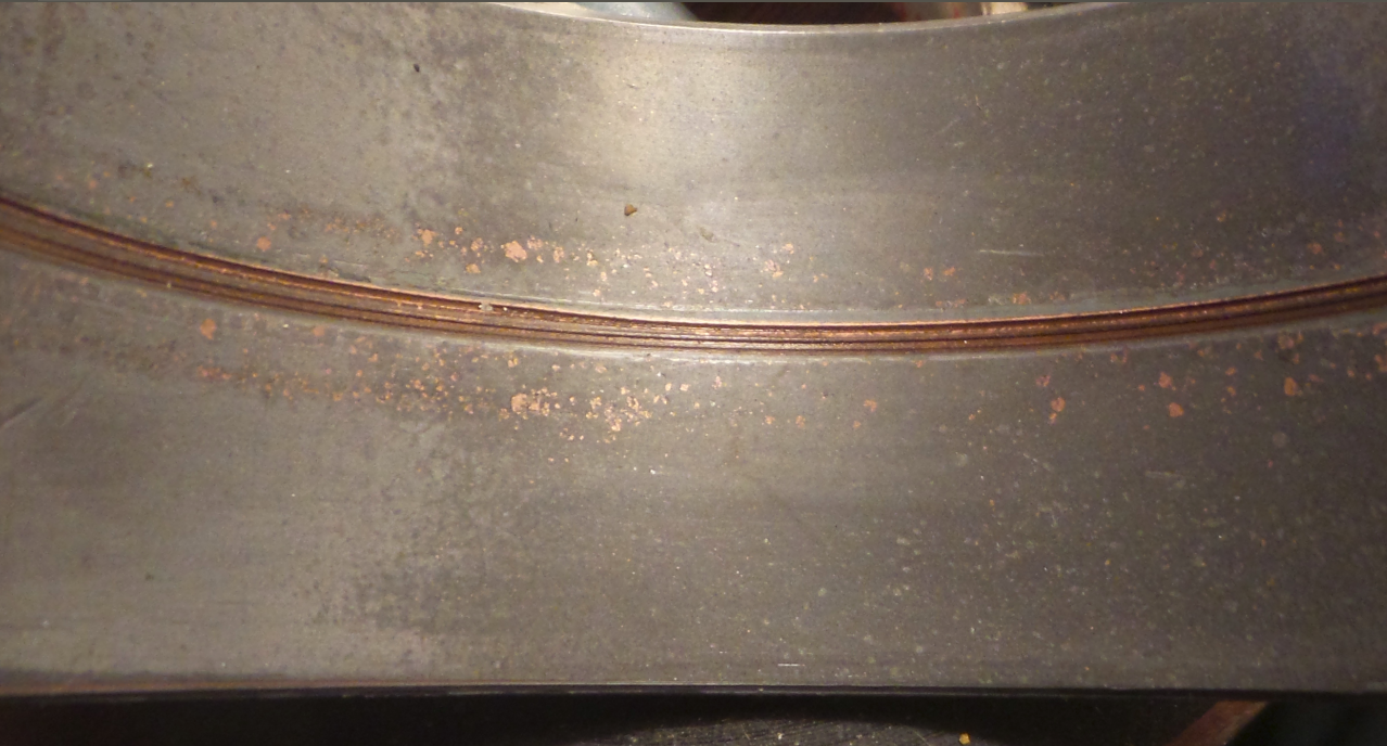

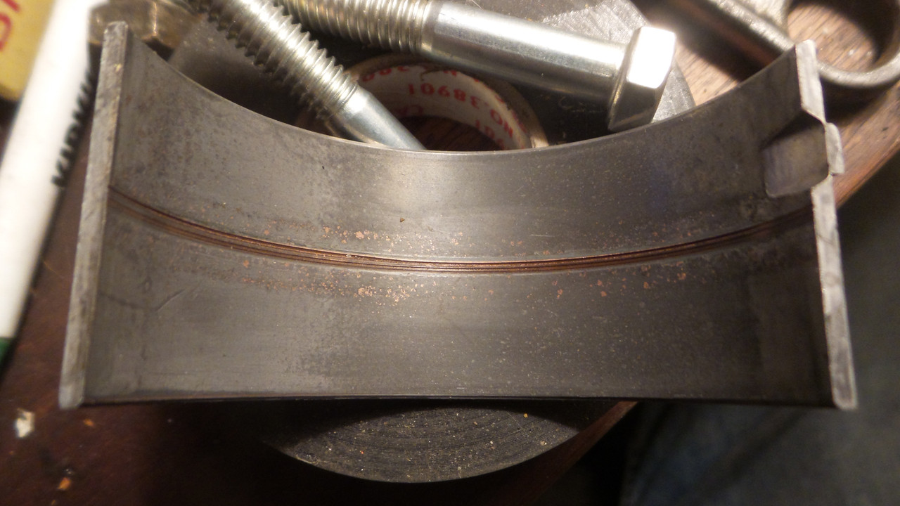

bc.gold 3,406 #17 Posted November 19, 2019 (edited) On 11/11/2019 at 8:06 PM, bcgold said: Petter PJ has new valves guides, valves and injector nozzles on the way for cylinder head overhauls. New old stock genuine Petter manufactured parts that are reasonably priced. Those parts were advertised to fit Petter PJ but according to part numbers they are for the Lister ST series engine which fortunately is what is on the Kohler generator. The seller also short changed me on two injector nozzles, which after a phone call now claims they're in the mail. Below is one of the connecting rod shells from number one cylinder, I've seen much worse. The bearing is standard so I know now that the crank has never been to a machine shop and it still looks to be in good condition. Connecting rod bearings as a rule of thumb wear out 2 to 1 on the mains Edited November 19, 2019 by bcgold Share this post Link to post Share on other sites
