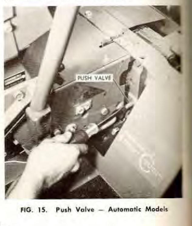

Pullstart 71,218 #4 Posted October 15, 2019 Hey @Don Byrd, you made it! Hopefully you’ll be able to find what you need here with the manuals on the site. Fellas I have a feeling from emailing with Don that he might need assistance with the tow valve on his tractor. I don’t think I have the same auto trans on any of mine so any help and assistance he’d greatly appreciate. The engine runs great but the motion control doesn’t do anything to get him moving. I forgot to mention on email, if the trans fluid is red, keep to ATF for good. If it’s amber/brown, stick with 10W30 motor oil whenever you do fluid and filter changes. They used both from the factory but they shouldn’t be mixed. Share this post Link to post Share on other sites
The Tuul Crib 7,354 #5 Posted October 15, 2019 to !! Share this post Link to post Share on other sites
pfrederi 21,145 #6 Posted October 15, 2019 Left side should be a screw driver to close it (Turn clockwise.) Share this post Link to post Share on other sites
Pullstart 71,218 #7 Posted October 15, 2019 3 minutes ago, pfrederi said: Left side should be a screw driver to close it (Turn clockwise.) Do you turn it until it stops? Share this post Link to post Share on other sites

pfrederi 21,145 #10 Posted October 15, 2019 52 minutes ago, pullstart said: Do you turn it until it stops? Yes but do not put a lot of toque on it snug is good. 1 Share this post Link to post Share on other sites

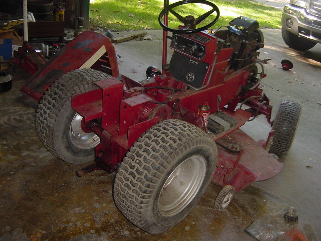

gwest_ca-(File Mod) 12,485 #14 Posted October 15, 2019 I think this may be a 1979 C-121 Auto. Post all the numbers off the engine data decal including the serial number. What is in this circle in your photo - just below the dash panel? Garry 1 Share this post Link to post Share on other sites
Sparky-(Admin) 26,327 #15 Posted October 16, 2019 The larger dash tower looks like the 1978-1979 C series to me. 1 Share this post Link to post Share on other sites
roadapples 6,987 #16 Posted October 16, 2019 Yes, newer than 74 with gas tank under the seat.. Share this post Link to post Share on other sites
gwest_ca-(File Mod) 12,485 #17 Posted October 16, 2019 This 1979 service manual is appropriate for your tractor. I'm thinking your model name will be C-121 Automatic and model number will be 91-12KS01. Click on the picture. Garry 1 Share this post Link to post Share on other sites
Pullstart 71,218 #18 Posted October 16, 2019 I received this email from Don last night. I think we done good! I got lots of replies to my post about manuals and even dowloaded a parts manual.I know for sure I need a headlight lens #103771, and a clutch brake #104730 and a lower steering shaft bushing # 637. No hurry tho, I have plenty time to locate them. The tow valve did the trick,it screws in and out instead of pushing. I drove it around the house, I like it a lot. Thanks again for all your help. Don 1 1 Share this post Link to post Share on other sites
