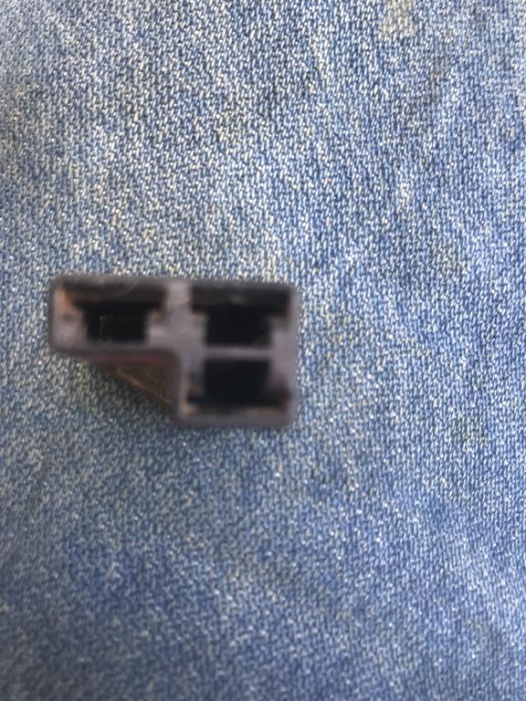

oliver2-44 10,397 #1 Posted October 9, 2019 (edited) I need a new 3 prong connector housing for the stator to regulator connection on my 1974 C160. I know the connector uses the Delphi 56 connector, but need help finding the plug housing. My plug looks like this. I found on on the jungle site with the 3rd hole rotated 90 degrees, but not this one. Any help is appreciated Edited October 9, 2019 by oliver2-44 Share this post Link to post Share on other sites
ZXT 2,401 #2 Posted October 9, 2019 (edited) Hey Jim! I believe the part # you're looking for is 02965164. Copy that number into eBay and you'll find one listing showing a picture. I copied it to google and found a few sites selling them for $2-3 a piece. Edited October 9, 2019 by ZXT 1 Share this post Link to post Share on other sites
oliver2-44 10,397 #3 Posted October 9, 2019 Thanks I’ll give that a try Share this post Link to post Share on other sites
pacer 3,176 #4 Posted October 10, 2019 Go to the bay and just type in Delphi Packard series 56 and you will see many of this type thing - of which our horses use quite a few! Share this post Link to post Share on other sites
ZXT 2,401 #5 Posted October 20, 2019 On 10/9/2019 at 2:36 PM, oliver2-44 said: Thanks I’ll give that a try Hey Jim - any luck? I appear to need a new one as well for my dad's C-141. Curious where you wound up buying from. 1 Share this post Link to post Share on other sites
pacer 3,176 #6 Posted October 20, 2019 By the way --- if you cant find the 3 hole one, a 4 hole will still fit just leaving one empty (or cut the extra one off with a dremel) 1 1 Share this post Link to post Share on other sites
oliver2-44 10,397 #7 Posted October 21, 2019 @ZXT Iast week I scoured ebay and amazon with no luck. However I've seen the 4 hole plug @pacer mentioned, and I almost ordered one, but tried searching and found the three prong on Ebay vendor Small Engine Warehouse. Search for kohler 237429s. They had 6 and I've got 2 on the way to me. 1 Share this post Link to post Share on other sites
ZXT 2,401 #8 Posted October 21, 2019 15 minutes ago, oliver2-44 said: @ZXT Iast week I scoured ebay and amazon with no luck. However I've seen the 4 hole plug @pacer mentioned, and I almost ordered one, but tried searching and found the three prong on Ebay vendor Small Engine Warehouse. Search for kohler 237429s. They had 6 and I've got 2 on the way to me. Cool! Thanks! Share this post Link to post Share on other sites

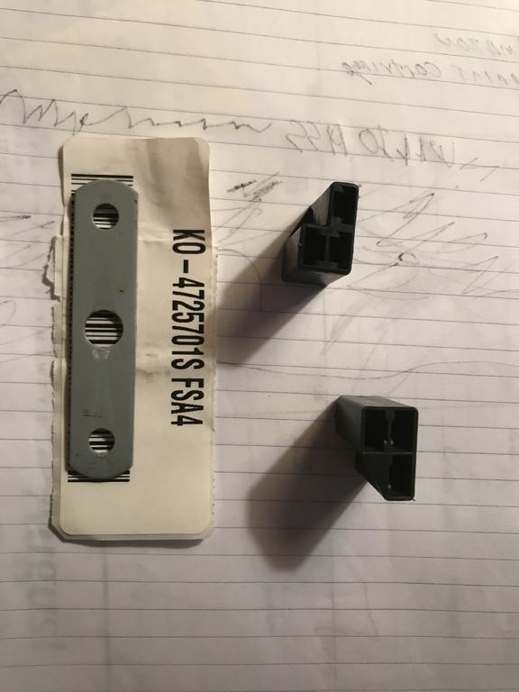

oliver2-44 10,397 #9 Posted October 24, 2019 (edited) Look what Just delivered, my C160 will run again Edited October 24, 2019 by oliver2-44 1 1 Share this post Link to post Share on other sites
