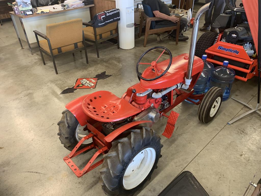

Ronniejr 19 #1 Posted October 5, 2019 Help me out I'm just trying to figure out what I have. The engine is incorrect and she slips out of third and rear axel seal leaks. What is a good oil to put in transmission?? Thanks Ronnie 8 1 Share this post Link to post Share on other sites
troutbum70 858 #2 Posted October 5, 2019 What you have there is a real beauty. Share this post Link to post Share on other sites
Retired Wrencher 7,037 #3 Posted October 5, 2019 Ronniejr It appears to a nice tractor but I do not think that engine belongs in there. Nice fit though. Fix what needs to be done and enjoy it. Share this post Link to post Share on other sites

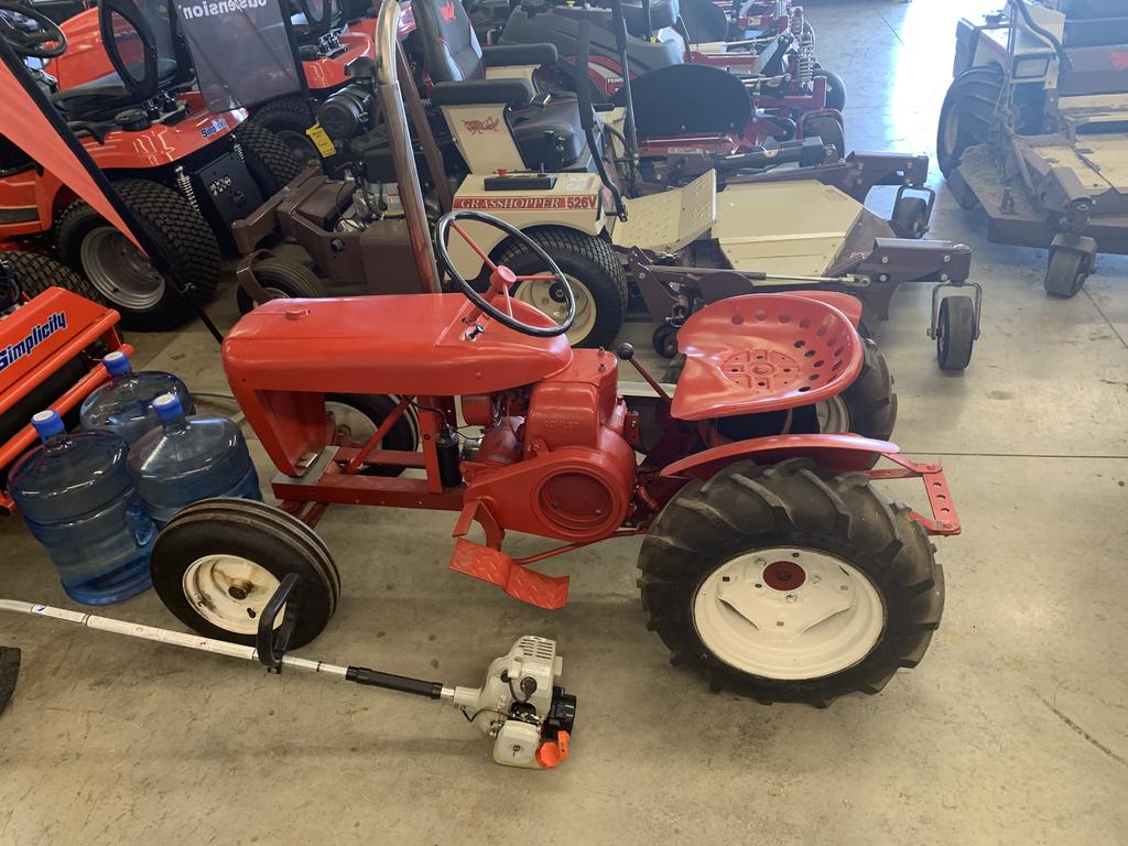

Racinbob 13,286 #5 Posted October 5, 2019 Based on the foot rests and clutch/brake pedal it's a 1960. I'm thinking the tell-tell hole in the hood, round or rectangular, has been filled and a throttle added. As mentioned, the engine isn't original but a nice fit. Rear axle seals are easy to replace and available from one of our vendors here. Make sure the axles don't have slop, forward/back, up/down play or the new ones will leak. Slipping out of 3rd gear is due to a worn 3523 gear and the input gear/shaft might also be guilty. Put the transmission in 3rd with just the detents holding it. Then check for any in/out play at the input shaft. If there is any open it up and put the proper thickness thrust washer on the input shaft behind the input gear. Play with the thickness until ALL the play is gone. That might help or even fix it for a non-worker. 3 Share this post Link to post Share on other sites

AMC RULES 37,260 #9 Posted October 5, 2019 Obviously a custom there...aka a Franken-Horse (just in time for halloween). Nothing wrong with that as long as it was tastefully done, and it keeps your horse alive to see another generation. You could always make a project out of returning it back to stock if that is your thing, just need to definitevely determine how it was configured when it left the factory. Try like Bob said above...looking from underneath, was the original hole for the throttle/choke controls a round or square hole in the hood. Share this post Link to post Share on other sites

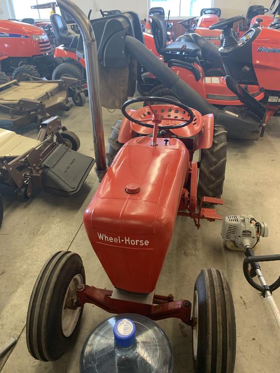

Ronniejr 19 #12 Posted October 6, 2019 Thanks for the info on this. There is a round hole that someone has filled on the hood. I tried to lift it and wiggle the rear tires. Seemed pretty tight but rolled the lawn today and had oil all over the inside of the rim??Who is the vendor I can get the deal from?? Thanks Ronnie Share this post Link to post Share on other sites

Racinbob 13,286 #15 Posted October 6, 2019 7 hours ago, Ronniejr said: Thanks for the info on this. There is a round hole that someone has filled on the hood. I tried to lift it and wiggle the rear tires. Seemed pretty tight but rolled the lawn today and had oil all over the inside of the rim??Who is the vendor I can get the deal from?? Thanks Ronnie The round hole indicates a 61 but the foot rests and pedals are 60 but you can bet that any leftover from 60 went on the 61's. 1 Share this post Link to post Share on other sites
