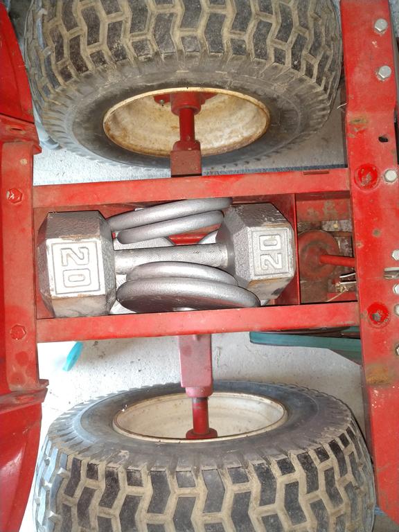

troutbum70 858 #1 Posted October 2, 2019 Don't have wheel weights for my commando 800 and want to use it with the 36 inch snow blower I got from Bigmike last weekend, so this is my way of adding some extra weight along with my 220 lb. Butt and of course chains. It equals 45 extra lbs. 9 2 1 Share this post Link to post Share on other sites

JoeM 10,318 #14 Posted October 3, 2019 wow, I thought those dog bone looking things were door stops! Nice, I like that idea bum. Share this post Link to post Share on other sites
troutbum70 858 #15 Posted October 3, 2019 Yep OILUJ52 I have a couple serving as door stops and every time I kick one I say that thing needs a new purpose and so I repurposed this one. I am going to try and drill a couple of the 20 lb. round flat disk and turn into wheel weights as I have several lying around that need repurposed. Share this post Link to post Share on other sites

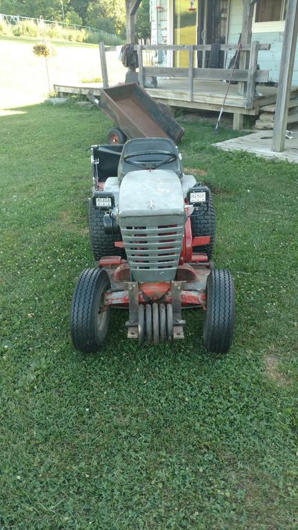

gt14rider 1,283 #16 Posted October 3, 2019 Added these after a rollover, 4 Share this post Link to post Share on other sites
troutbum70 858 #17 Posted October 3, 2019 An attempt to avoid any future wheelies I assume. 1 Share this post Link to post Share on other sites
gt14rider 1,283 #18 Posted October 3, 2019 Was thinking of wheely bars too, put me in hospital 2 weeks, took me out for 3-4 months. Share this post Link to post Share on other sites

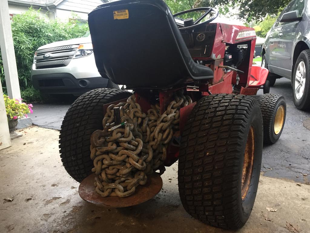

Stormin 9,988 #20 Posted October 4, 2019 On 10/2/2019 at 10:52 PM, troutbum63 said: Yes I could load the tires if I could find some used anti freeze, that may add another 15 to 20 lbs. I don't care to use calcium, makes to big a mess. May have to mix some concrete and make a couple. This is what I did. Share this post Link to post Share on other sites
troutbum70 858 #21 Posted October 4, 2019 You done very well with your weights Norm, only thing I see bad is not being able to get to the valve stems. But maybe yours are on back side of wheels, I have some heavy plates that are just the right size for the wheels, but would also cover the valve stems unless I cut out those areas and put extensions on. Share this post Link to post Share on other sites
Stormin 9,988 #22 Posted October 4, 2019 The valve stems are on the inside/back of the wheels. I'm surprised your aren't. That's where they are on my three Wheel Horses and the Sears/Roper. Share this post Link to post Share on other sites

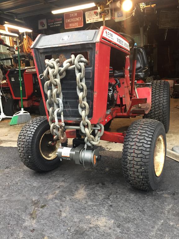

SylvanLakeWH 32,823 #24 Posted October 5, 2019 Saved from the scrap pile... Lots of weight...looks kinda cool... 1 Share this post Link to post Share on other sites
troutbum70 858 #25 Posted October 5, 2019 Fer sure the wind won't blow that away. That's a horse of a load. Share this post Link to post Share on other sites
