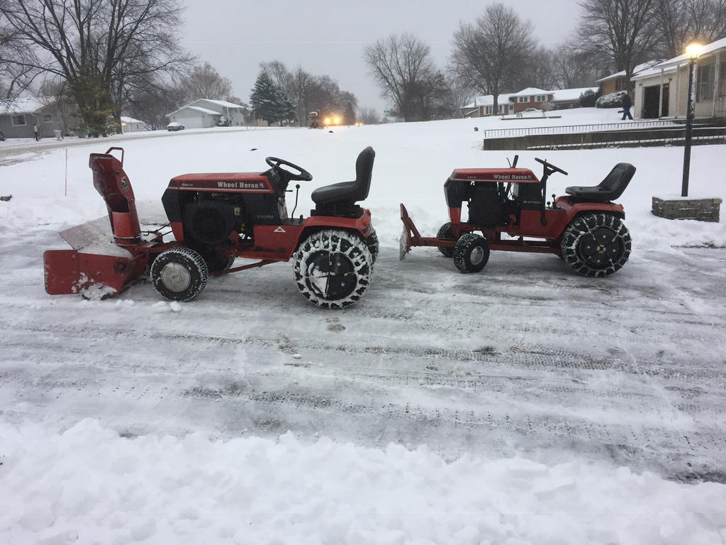

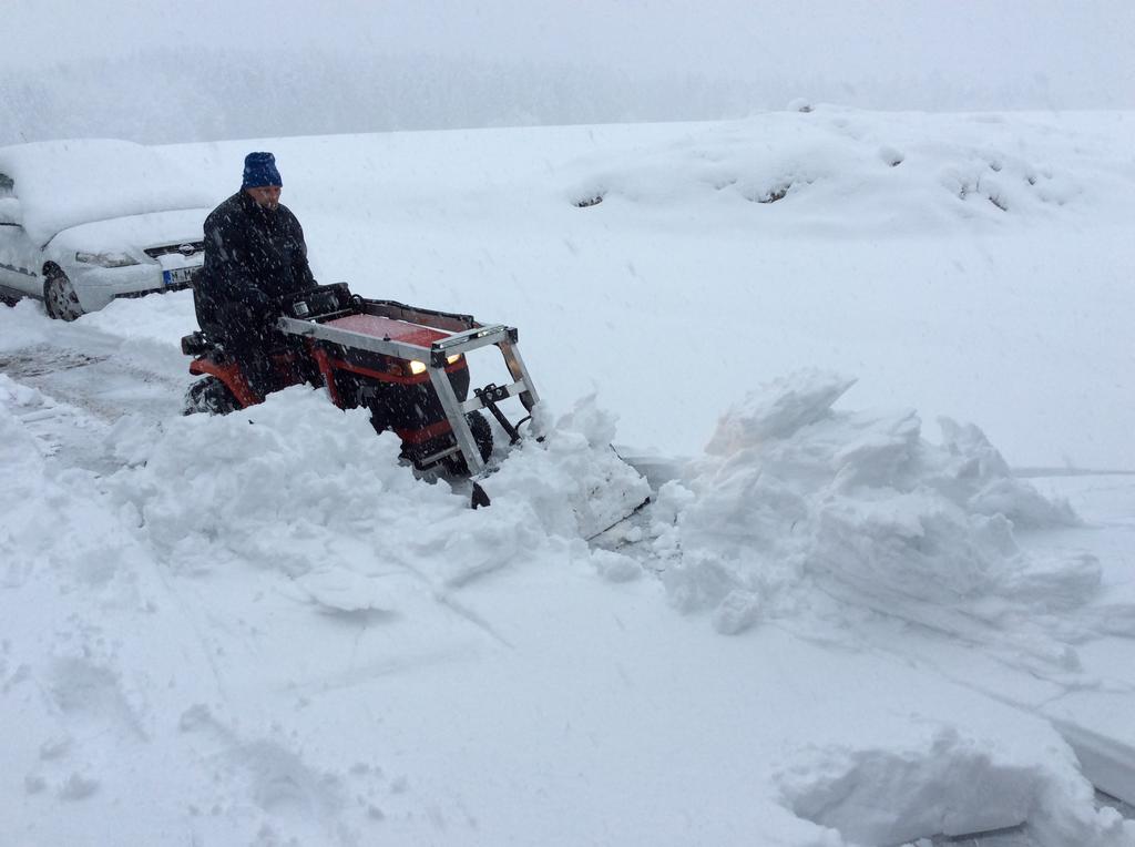

Tractorhead 9,217 #13 Posted October 1, 2019 This was my first Chain Setup. this was V chains, but they slipped sometimes in cleat. We had this year extreme Wet and Heavy Snow. plow allone was not an option to get the driveway Clean, so i must handle it with my little FEL to remove. Later i reworked the Chains to a x-Style, but o have actual no pics from. It was the best improvement i did this Winter. As weight on the Rearaxle, i used a old and defect 120Ah Car battery with a mounting Bracket i build quickly, with about 39 Kilos at all behind The Axle. This year i will do it in combination with my 4WD Iseki. The horse with Snowplow for the light snow ( to protect the Axles) and the Iseki with FEL and 4WD to move it away, out in the Fields. Curious how this Thing works with 4WD but without chains. 2 1 Share this post Link to post Share on other sites

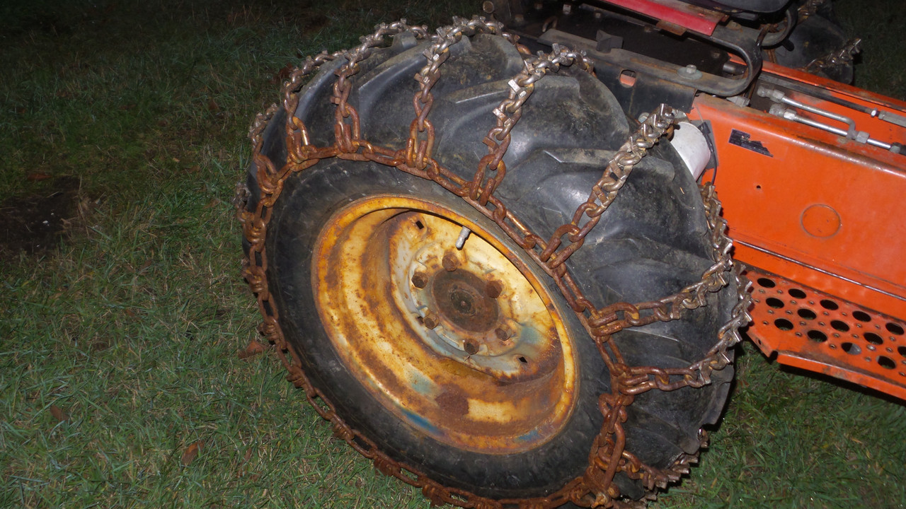

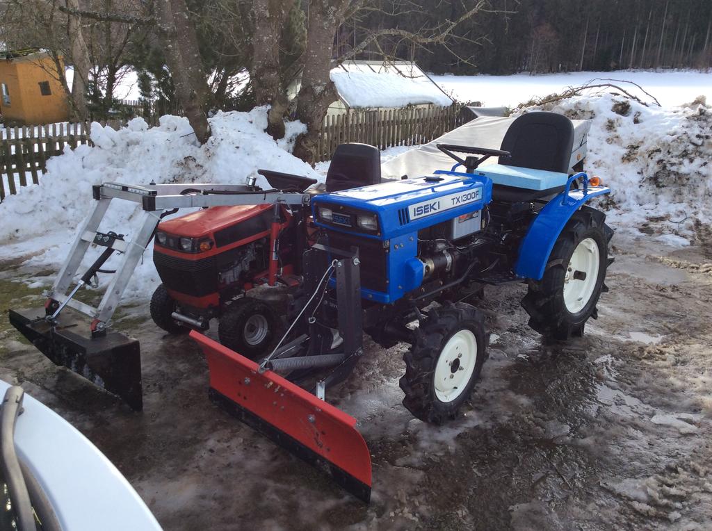

Tractorhead 9,217 #17 Posted October 1, 2019 (edited) I‘m curious, because i didn‘t have normal AG‘s, that‘s the Ricefieldtyres with the longer paddles. I just tried last year a small ammount, because just fiddeling quickly the Plow onto it’s Front. My first try was impressive enough in 36cm deep snow. Oh, got a pict short before i did ..😎 But this pict was taken before this Action and after the Pic while the Horse working.😎 I just made this Test, because i been curious to see if and how it’s work. 😎 I mounted quick 2 Angleirons 36cm long with 4cm Angleside by 3 mm thickness i had in scrap, as a simple bracket. ( all screwed with M10 Bolts). The stiffener‘s was made parently with same material and the planed weakpoint (silver) was just an proof of concept and 2mm thick, but it lasts.😇 To be able to lift that simple construct, i using a steelrope on the Front, just to see if this will work. The Steel rope will be acting as a winch and was attached on Rear 3Point Lift with few levers. The basic function was nicely given, until i tried how deep it can plow out in the fields. i wanna Try, if and when this Beast hungs or stuck. Take that story short, after plow 500 meters in the Fields, i hear a loud Crack, and the steel rope rips, the Angleironbrackets bends like a few matches.😱 but that beast still pushes forward. 😂 Honestly i didn‘t try to drive rewards, but in forward i make a circle and be back on the street, but with a now unusable Plowshield.😎 This Beast seemd to be unstoppable with this Tyres, 4WD and Diff Lock, so im curios after the improvements and few Kilos more, how it will do it‘s job now. I will show my experiences, promised. Added text @Darb1964 thanks for your Note with the Shoveling on Stuck, that is a good point ! but because i didn‘t want to shovel by hands, i have build 2 FEL‘s.. 😂 -just in Case- Edited October 1, 2019 by Tractorhead Added Text 1 1 1 Share this post Link to post Share on other sites

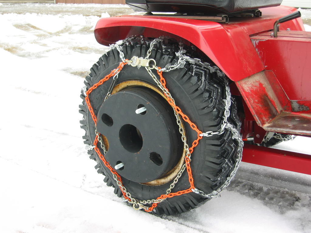

bc.gold 3,406 #18 Posted October 2, 2019 (edited) Two link on loaded Ag's with limited slip diff, 1975 Simplicity 9020 with original Onan. No cross ties necessary, To get the chains on snug you can deflate the tire bu a few psi then reinflate once the chains have been installed. Chains are bidirectional, the pair I'm using were repurposed from a set of commercial truck chains that were made for use on Canadian ice roads. Ice Road, https://en.wikipedia.org/wiki/Ice_road I keep the fenders off as a broken chain can ruin one in a hurry and someday I may want to restore this tractor back to its original condition. Edited October 2, 2019 by bcgold 1 1 Share this post Link to post Share on other sites
67 WH 877 62 #19 Posted October 2, 2019 4 hours ago, bcgold said: Two link on loaded Ag's with limited slip diff, 1975 Simplicity 9020 with original Onan. No cross ties necessary, To get the chains on snug you can deflate the tire bu a few psi then reinflate once the chains have been installed. Chains are bidirectional, the pair I'm using were repurposed from a set of commercial truck chains that were made for use on Canadian ice roads. Ice Road, https://en.wikipedia.org/wiki/Ice_road I keep the fenders off as a broken chain can ruin one in a hurry and someday I may want to restore this tractor back to its original condition. I am considering doing the same with the truck chains..set on market place for $20 1 Share this post Link to post Share on other sites
Tractorhead 9,217 #20 Posted October 2, 2019 19 hours ago, ebinmaine said: Keep us posted on that. Our neighbor across the street has a four-wheel-drive farm tractor with no chains and he slips quite a lot on the ice. Hi Eric, On pure ice i bet it also will slip, that‘s for shure. But it depends, if 4WD and diff lock can do the trick a bit better. if not, i guess i will sit on this Beast while slipping with an earworm “dancing in the Street“ by David Bowie.. 😂😂 1 Share this post Link to post Share on other sites
