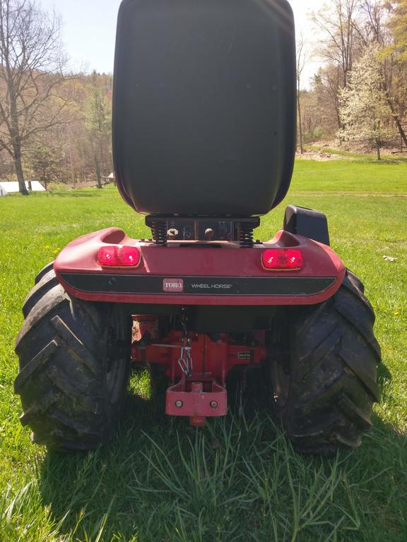

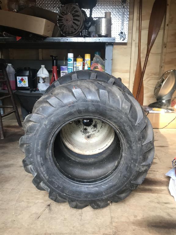

WVHillbilly520H 10,379 #4 Posted September 26, 2019 Tire brand also dictates ACTUAL tire size as to what's printed on the side walls... 1st pic 23x10.50-12 Deestone on 7" (300 series) rims or 2cd pic same size Lawn Trac R1 on 8.5" 520 wheels. 3 Share this post Link to post Share on other sites

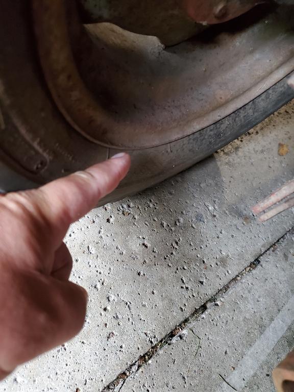

Achto 32,853 #5 Posted September 26, 2019 (edited) 9 hours ago, DadsPuller said: I want to upgrade the factory skinny rear wheels to a wider stock wheel so I can hang either a a set of 23 x 10.50 x 12 or 23 x 12 x 12 tractor tire shoes on it. 23 x 10.50 x 12's will fit on the rims that you have, but there will be some side wall bulge. This will cause some loss of contact to the ground. 8.5" wide rims will work better for this size tire. I would suggest looking for a set of rims from a 520 to fit this bill. I don't think that they make a tire in a 23 x 12 x 12. 26 x 12 x 12 is a common size and the max size allowed at most GT pulls. A 26 x 12 x 12 tire calls for a 10.5" wide rim, for pulling a 12" wide rim would work even better. Rim options for 10.5" wide rims 1. Find a set of rims from a Cub Cadet 982 or other super Cub 2. Buy the blanks and centers from https://www.millertire.com/categories/wheels-by-size/ and weld them together. 3. Take four 7.5" wide rims, cut them apart, weld the pieces together to make two rims the width that you need.I did this option on one of my tractors to get 11.5" wide rims. If you want 12" wide rims you will either have to go with aluminum rims or make your own like I did. Edited September 26, 2019 by Achto 2 2 Share this post Link to post Share on other sites

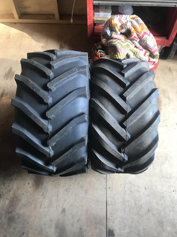

Super-C 4 me 612 #6 Posted September 26, 2019 (edited) I just picked up a set of Deestone 26x12x12 I already have a set of Carlisle tru-power 26x12x12 big difference in size Left side is Carlisle Right side is Deestone Edited September 26, 2019 by Super-C 4 me 2 Share this post Link to post Share on other sites
