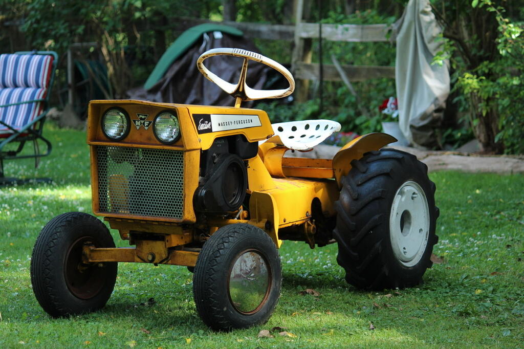

Burnerman 759 #8 Posted September 23, 2019 He says it’s the same as this one only not in such pristine condition. Lol 1 Share this post Link to post Share on other sites

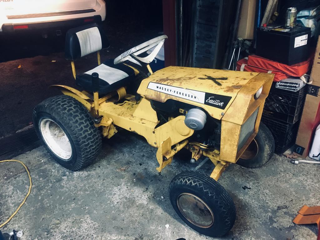

Burnerman 759 #11 Posted September 23, 2019 I’m going to be freeing up rusted stuff for weeks! Share this post Link to post Share on other sites

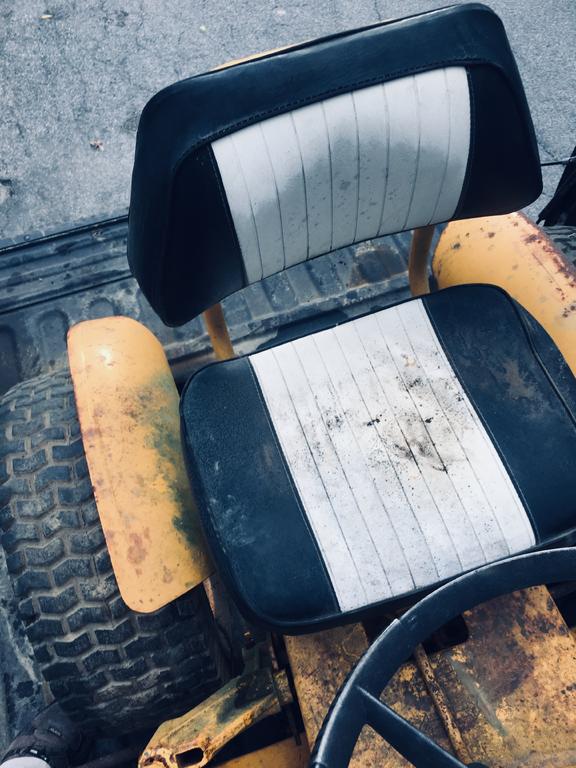

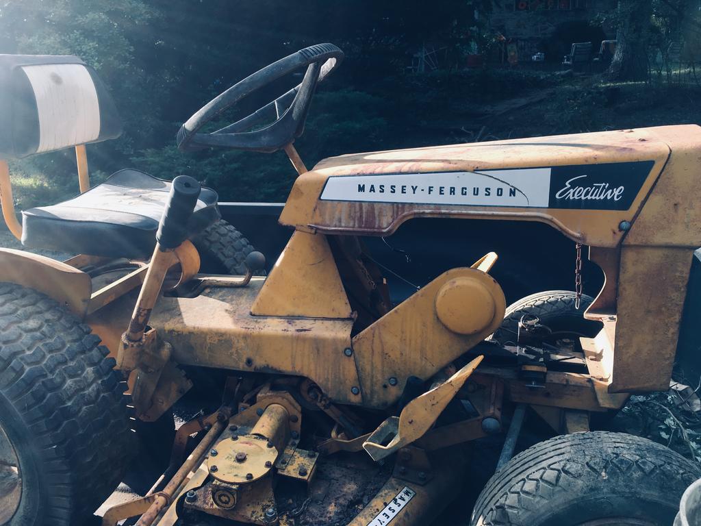

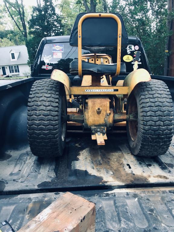

Burnerman 759 #12 Posted September 23, 2019 Don’t have the OEM rear rims and tires. These are WH rears I had laying around. Are they special rims and are they worth looking for? It’s all there otherwise. Implement raise lower arm is busted and all the pivots seized so I don’t think I can get the deck off. Brake and clutch pedals are seized. I love the seat and for some reason I feel I met one of these tractors when I was very little. 🧐 Share this post Link to post Share on other sites

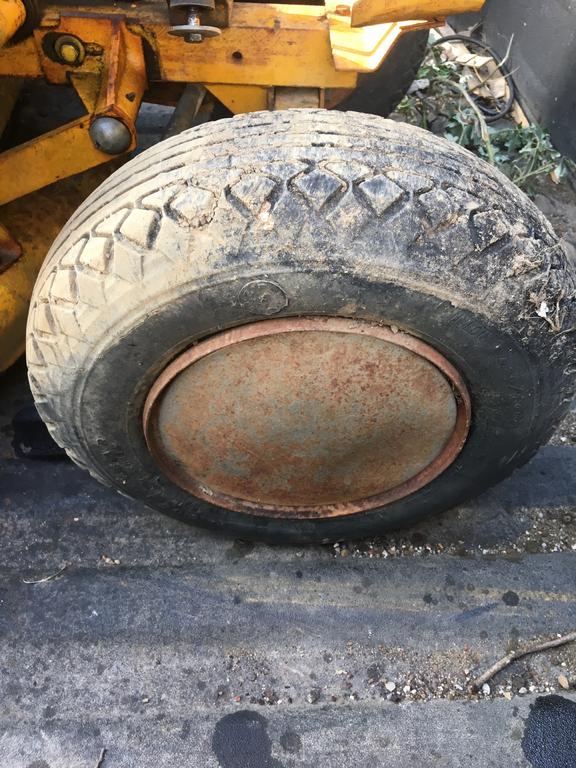

Burnerman 759 #13 Posted September 23, 2019 It’s got hubcaps. And a cigar lighter. Love it! 2 Share this post Link to post Share on other sites
WHNJ701 4,173 #14 Posted September 23, 2019 (edited) that's a steal right there. the rims would just be a 6-12. it's got the belt guard too which usually missing. this machine should clean up/buff up real nice. I would keep it as an original as possible and put that kohler back in it the seat is an amazing condition Edited September 23, 2019 by jabelman 1 Share this post Link to post Share on other sites

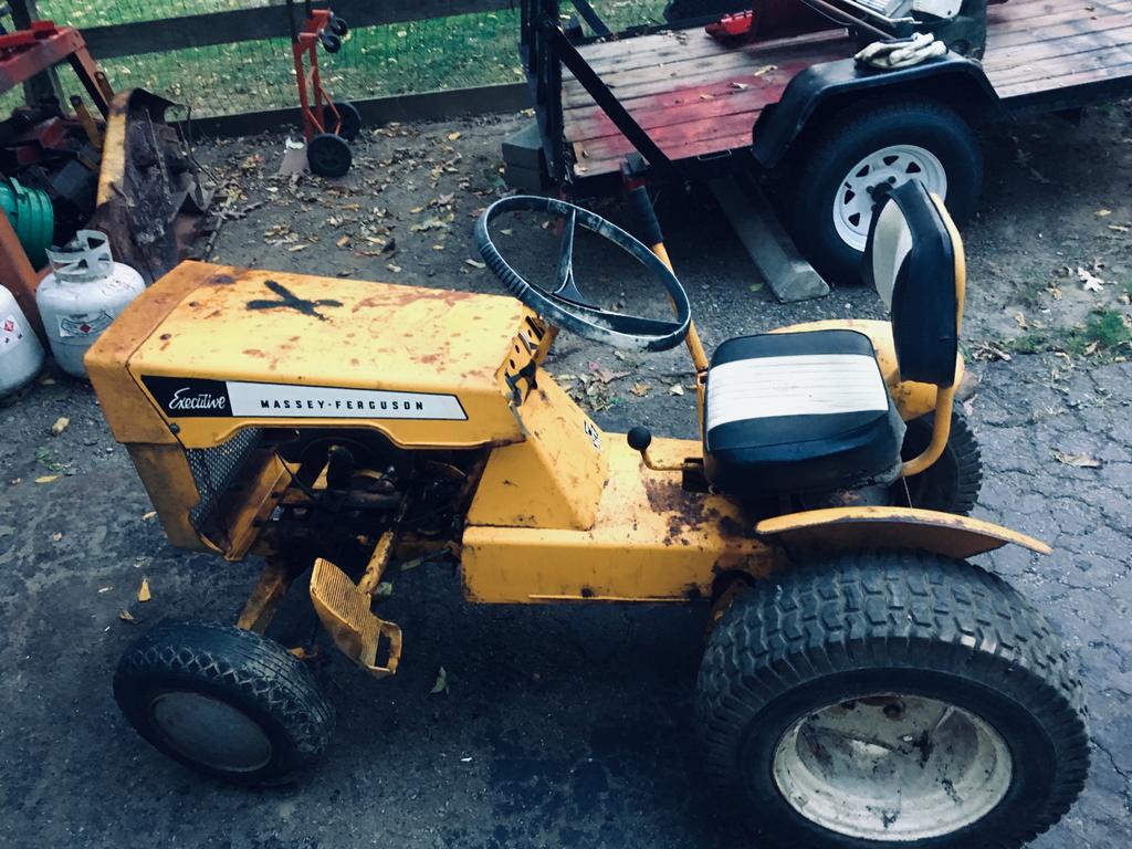

Burnerman 759 #15 Posted September 23, 2019 15 minutes ago, jabelman said: the seat is an amazing condition Kinda. Lol. The plywood is starting to dry rot and the vinyl has shrunk. I got most of the stuff freed up. It’s in pretty amazing condition for its age. The Kohler is going back in. It runs very well and my son was running it in his WH tonight. Both of the tractors were picked up at the same scrapyard. Iv got to make a new brake band so it’ll stop and go through it yet. We managed to get the deck off. That has to weigh 100#’s. I plan on washing it up and keeping it as is. The X mark (to signify the crusher) on the hood and all. 2 Share this post Link to post Share on other sites
new2horses 288 #16 Posted September 24, 2019 It is indeed a very nice original Executive. I am jealous, you're going to do right by it, and are to be commended. David 1 1 Share this post Link to post Share on other sites
WHNJ701 4,173 #17 Posted September 24, 2019 15 minutes ago, new2horses said: It is indeed a very nice original Executive. I am jealous, you're going to do right by it, and are to be commended. David dave - is that the correct steering wheel? i see its got the early foot pedals, should it have the cast aluminum wheel? I think the mf changed steering wheel types for each year if I remember correctly Share this post Link to post Share on other sites

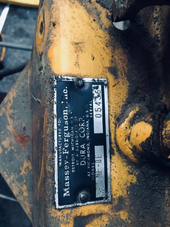

Burnerman 759 #18 Posted September 25, 2019 22 hours ago, jabelman said: dave - is that the correct steering wheel? i see its got the early foot pedals, should it have the cast aluminum wheel? I think the mf changed steering wheel types for each year if I remember correctly The wheel is white plastic. It’s got black on it that comes off easy. The tractor looks to be in all original condition. Nothing looks messed with or replaced. I’d love to know it’s true age. Share this post Link to post Share on other sites
WHNJ701 4,173 #19 Posted September 25, 2019 2 minutes ago, Burnerman said: I’d love to know it’s true age. my guess is 65, the first ones still had the aluminum steering wheel, the later ones changed the foot pedals shape. it was a short run 64 to 66 1 Share this post Link to post Share on other sites
new2horses 288 #20 Posted September 25, 2019 1 hour ago, jabelman said: my guess is 65, the first ones still had the aluminum steering wheel, the later ones changed the foot pedals shape. it was a short run 64 to 66 '65 it is indeed. And yes it was a short run, being '64-'66. The first 500 or so were 7E's and had the aluminum steering wheel in '65 they had the white wheel that yours has and the '66's had a black wheel that was produced by Sheller. A very interesting note on these was the system used to start the tractor, all had a neutral safety switch mounted under the shift lever for starting, pretty clever way to enforce safety in the middle '60's I think. Supposing this switch needs replaced, new ones are still readily available, on the web or at your local MF dealer. 2 Share this post Link to post Share on other sites
Burnerman 759 #21 Posted September 28, 2019 It all works. It’s pretty cool. 1 Share this post Link to post Share on other sites
