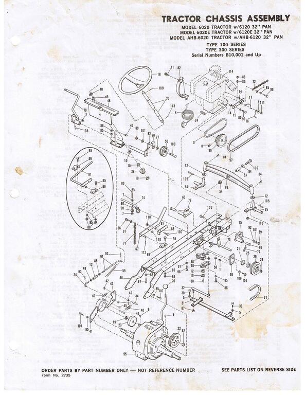

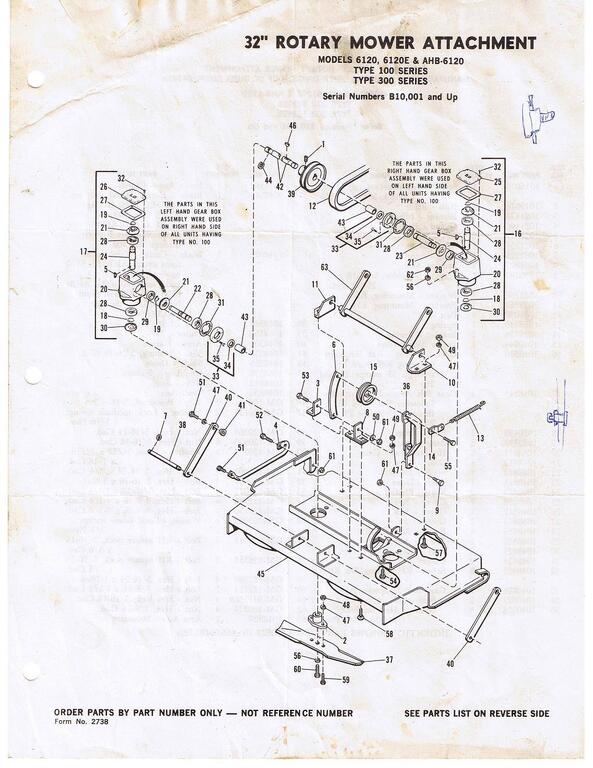

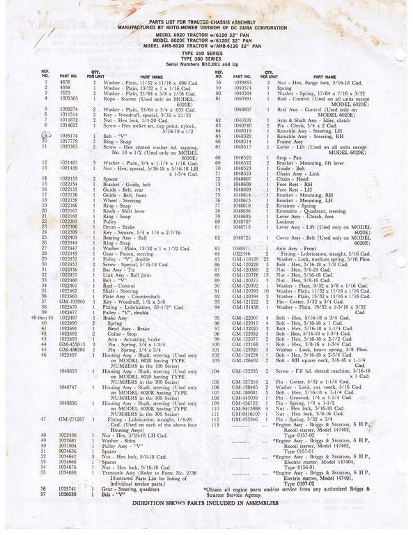

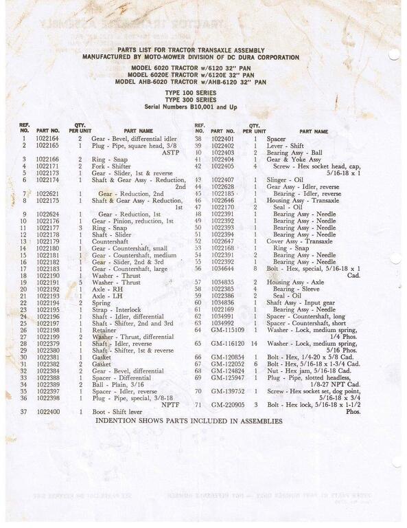

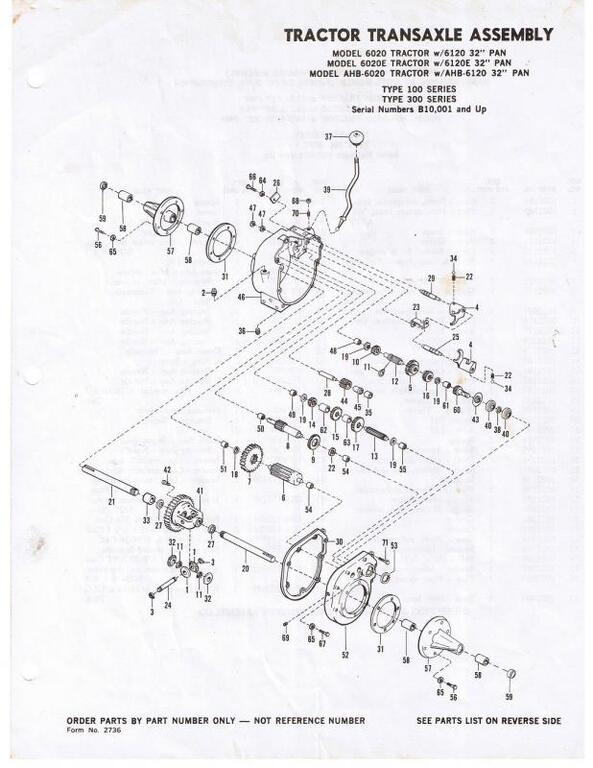

@beardedyeti85  @Kkirbs Here's some information Ive been collecting. The 8E was built and the same as a Moto Mower, but different sheet metal.
18453-Massey Ferguson8Executive Owners (1).pdf
Massey Ferguson 8e Transmission bearing and Seal Numbers.ods
The above files will not open directly, but will download as a pdf.
@gwest_ca Your welcome to save these files if appropiate.
1237480328_MotoMowerTransmissionPartsList.jpg.d8154db0d07789da53793c7b10709612.jpg112071637_motomowertranspg2of2.jpg.b0ad55ee40777c837e9e4493faa5f845.jpg1820499902_motomowertransmissionpg1of2.jpg.c8f71ea536990a6f5f4ddddb488b72fe.jpg796638862_motormowerpage.jpg.410254bca2a90506e51e32568a6406c0.jpg1291245016_motomowerdeckpartsschematic.jpg.f95a286e380f7544b55506e081a3c984.jpg
