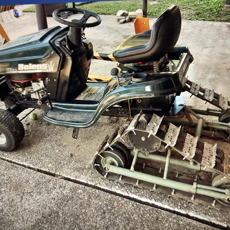

The Tuul Crib 7,354 #1 Posted September 22, 2019 Thumbing through facebook came across This interesting machine. I would like to see something like this done for my wheel horse. Has this ever been done? 4 Share this post Link to post Share on other sites

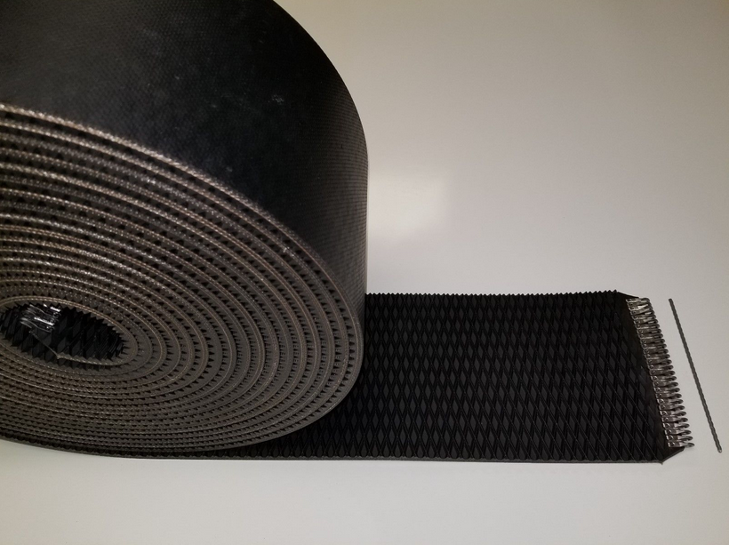

bc.gold 3,406 #2 Posted September 22, 2019 Cool idea, looks like our do it yourself-er used belting from a round baler. Share this post Link to post Share on other sites
AMC RULES 37,260 #3 Posted September 22, 2019 Definitely looks to be fabbed at home. Share this post Link to post Share on other sites
The Tuul Crib 7,354 #4 Posted September 22, 2019 Just think of the traction you could have in the snow! Wow! 1 Share this post Link to post Share on other sites

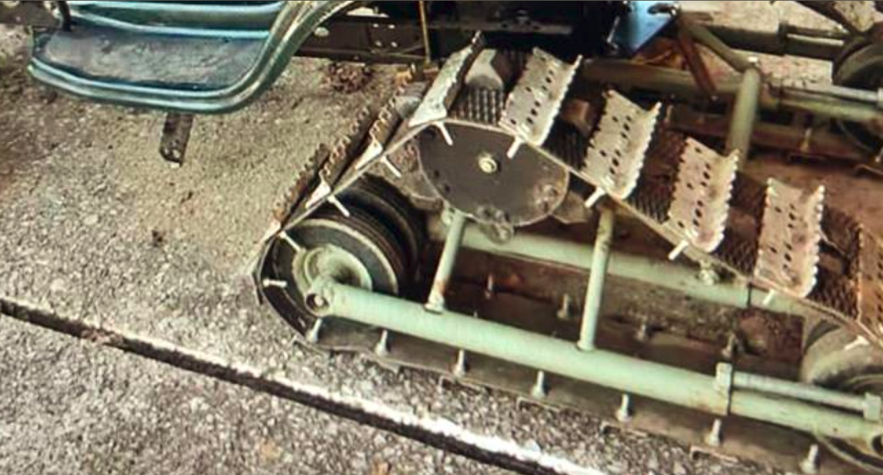

bc.gold 3,406 #8 Posted September 22, 2019 IMHO this track machine needs a bogie to stop the track from meeting up with the supporting rail when passing over a large stone or a lump of ice. Share this post Link to post Share on other sites
