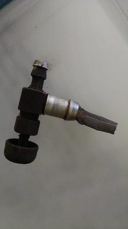

Paul Boy 31 #31 Posted October 14, 2019 Decided to pull the gas tank today and see if there was something there. Did find a screen at the under tank shutoff seemed very clogged up. The gas that I drained out appeared to be an orange color. Thought that a bit strange. Now I am stuck as I need a new shutoff valve as the one I tried to jimmyrig, leaked. So went ahead and ordered a new part #104048. Will be the end of the week before I get it so if tomorrow is a good day I will put the fuel pump back together and wait it out. If thIs attempt fails I may try an electronic fuel pump as I am just not sure what is really going on with this. Does anyone have another idea? 1 Share this post Link to post Share on other sites
953 nut 69,595 #32 Posted October 15, 2019 13 hours ago, Paul Boy said: The gas that I drained out appeared to be an orange color. That could have been your problem all along. 2 Share this post Link to post Share on other sites

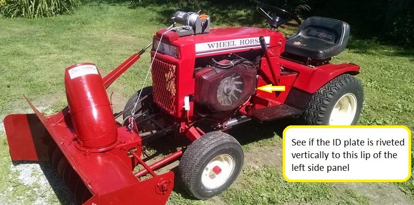

Phil902 70 #39 Posted October 16, 2019 Paul Boy, if you still have the front tins on the tractor, right beside the front spark plug, next to the oil fill, there should be model, type, and code numbers stamped in the tin. If it's been painted over, some solvent and elbow grease may expose them. Do you know the model or year of the Horse? Mine is a 1979 C-161 Hydro, with the Briggs opposed twin, model 402417, type 1021 01. 1 Share this post Link to post Share on other sites

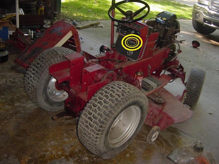

gwest_ca-(File Mod) 12,489 #42 Posted October 16, 2019 Did you remove the valve from the tanK? Is there a filter on the valve inside the tank? Sorry - missed the 2nd page of this thread. I would suggest you remove the tank and flush with hot water and detergent. Let it sit in the sun to help dry it out. If you don't do it the sludge will contaminate the filter on the new valve. A short length of light chain tossed in will help scrub the inside surfaces and easy to fish back out after. Save what you remove from the tank so you can see just how bad it was. Garry 1 Share this post Link to post Share on other sites

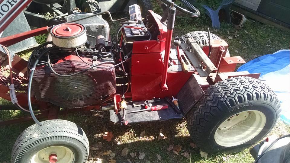

Paul Boy 31 #43 Posted October 16, 2019 I have the the numbers from the front tins and they are as follows. Model 401417 Type 0130101 Code 780424112. I was told when I bought it that it was a 78 or 79 Wheel Horse C-161. A previous owner had welded some heavy wire over the front of an older model hood and fitted it up with a blower I have the original 161 black hood that was originally on it but felt that this setup was a better fit for what I want to use this for. I had not thought about using hot water and detergent and had washed it out with clean gasoline. I will try the soap and water clean out as I have a few days before the new valve arrives. Thanks for all of the suggestions. Sure do appreciate it. Share this post Link to post Share on other sites

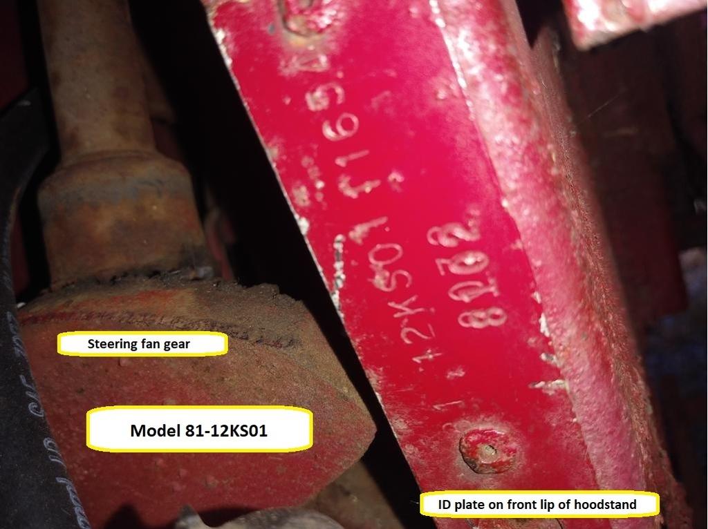

gwest_ca-(File Mod) 12,489 #44 Posted October 16, 2019 Your engine was used in 1978 and 1979. Tractor data plate could be in one of two places. Garry Share this post Link to post Share on other sites

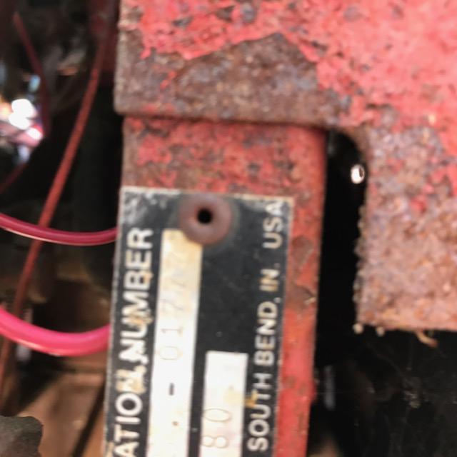

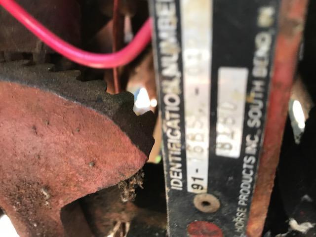

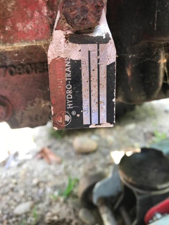

Phil902 70 #47 Posted October 16, 2019 The ID plate on my 1979 C-161 is located where Garry has the arrow pointing. I stuck my iPhone camera in and took a few pics to get the info. Share this post Link to post Share on other sites
gwest_ca-(File Mod) 12,489 #48 Posted October 17, 2019 9 hours ago, Phil902 said: The ID plate on my 1979 C-161 is located where Garry has the arrow pointing. I stuck my iPhone camera in and took a few pics to get the info. Any chance you can post the pictures? When I discovered the 1978 models had the plate at the arrow and some 1979 models had them under the dash housing wondered if this was a way to separate the 1978 and 1979 models but guess not. Paul Boy's B&S Code 780424112 is April 24, 1978 so that could land on a 1978 or early 1979 tractor. Garry Share this post Link to post Share on other sites
Phil902 70 #49 Posted October 17, 2019 (edited) Garry:I included the tranny tag as well in case that's helpful. Numbers are all hard to read. ID number appears to be: 91-16BS. - 01777 , lower BI80; 80 for sure, not sure on BI. Tranny tag has three lines: 3012910-04 90-12910-1173 LH 04-UE 1906 ( and then one more which could be 9,8,6, or 3) I failed to include the code on the Briggs number I posted . Here is the full number: 402417 1921 01 87012012 Hope this helps Phil Edited October 17, 2019 by Phil902 Share this post Link to post Share on other sites
gwest_ca-(File Mod) 12,489 #50 Posted October 18, 2019 Numbers are all hard to read. ID number appears to be: 91-16BS. - 01777 , lower BI80; 80 for sure, not sure on BI. I think the model number is 81-16BS01 with a 8180 build date - June 29 1978 Thursday Tranny tag has three lines: 3012910-04 90-12910-1173 LH 04-UE 1906 ( and then one more which could be 9,8,6, or 3) I don't know how to read the hydro numbers. I failed to include the code on the Briggs number I posted . Here is the full number: 402417 1921 01 87012012 Are you sure the 87012012 is not 78012012? January 20, 1978 sounds correct for a tractor build date of 8180 If the tractor model number is 91-16BS01 making it a 1979 model the tractor and engine build dates are possible. That first 9 printed on the tag could be an 8. Have no 1979 serials for this model to compare to. They often made mistakes in the build dates. They would start building 1978 models in mid-1977 so the Julian build date should be 7xxx but since they were building 1978 models they used 8xxx. They caught their mistake when January 1978 rolled around. Someday we may learn when they went from vertical ID plates to horizontal. Garry Share this post Link to post Share on other sites
