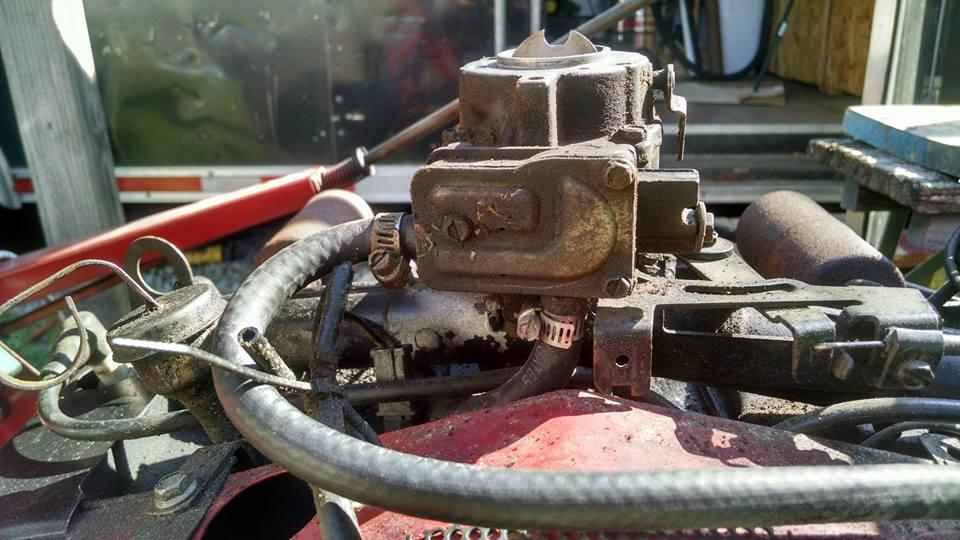

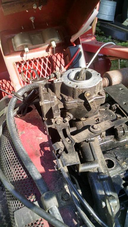

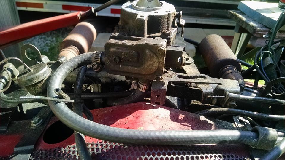

Paul Boy 31 #1 Posted September 20, 2019 Spent the day working on a stubborn horse. Trying to get our snow thrower tractor running. Its a Briggs 16HP and I would rather work on a Kohler any day. I've eliminated a plugged gas line. Cleaned the carb and the only way it will run a few seconds is on starter fluid. Acts like its not getting gas above the gas line filter. What can it be? What else should I try? Share this post Link to post Share on other sites

lynnmor 8,915 #5 Posted September 21, 2019 Apparently you have just the fuel pump built into the carburetor. When you switched carburetors, did you switch the entire assembly which includes the fuel pump? It is possible that you had two bad or dirty ones in a row. Pull the fuel line off and blow back thru it while listening for air bubbling in the gas tank. That should verify that the line is open. Also, check that there is no air leak between the tank and the carburetor, that will allow air to be drawn in and not allow gas to be pumped. If you have a good supply system, then get into the carburetor for cleaning and adjustment. Share this post Link to post Share on other sites

Paul Boy 31 #7 Posted September 21, 2019 Well, its been a disappointing day. Pulled carburetor apart and front panel of fuel pump. Not a drop of gas is being pumped. I suspect that I will need to locate the entire unit, Here's the problem, I don;t know which carburetor to order for this model Briggs & Stratton 16HP twin. There are no model numbers on the motor, no numbers identifying the Wheel Horse on it anywhere. Bought it from a guy who did a paint job (poorly) and removed everything. Any suggestions would sure help me with this. What to do next? Share this post Link to post Share on other sites

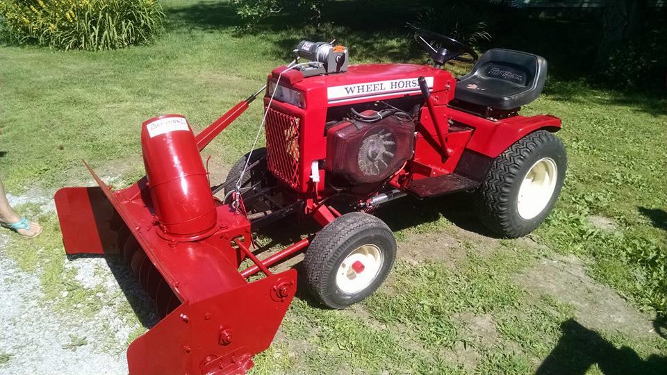

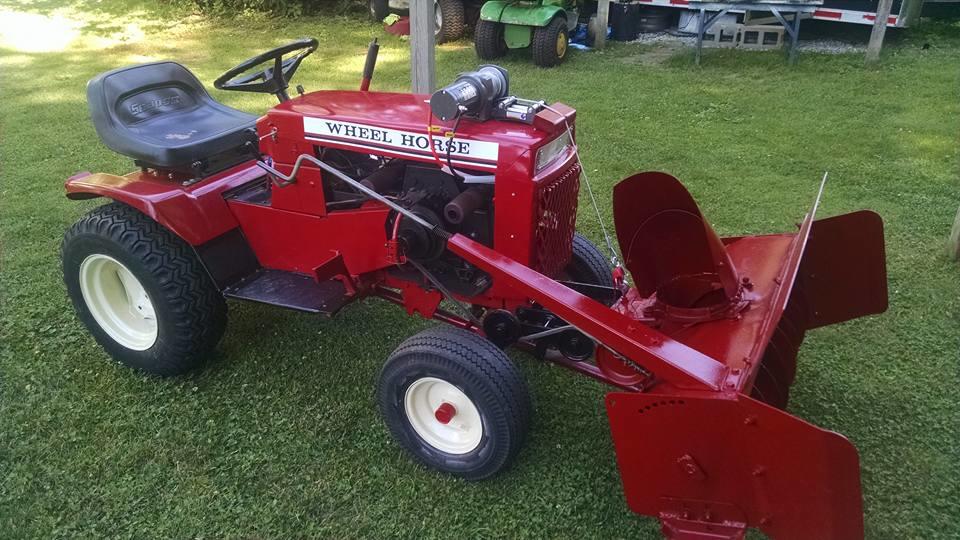

Paul Boy 31 #8 Posted September 21, 2019 Here is a photo of the tractor with the blower installed, when it was running It has a B&S 16HP twin engine. 2 Share this post Link to post Share on other sites
ZXT 2,402 #9 Posted September 21, 2019 57 minutes ago, Paul Boy said: Well, its been a disappointing day. Pulled carburetor apart and front panel of fuel pump. Not a drop of gas is being pumped. I suspect that I will need to locate the entire unit, Here's the problem, I don;t know which carburetor to order for this model Briggs & Stratton 16HP twin. There are no model numbers on the motor, no numbers identifying the Wheel Horse on it anywhere. Bought it from a guy who did a paint job (poorly) and removed everything. Any suggestions would sure help me with this. What to do next? The diaphragm should be replaceable. Were you cranking it and checking for fuel while you had the front panel off of the fuel pump? I wouldn't suspect it would pump while it is apart. Did you check to see if the hose running to the fuel pump is in good shape to ensure that there are no leaks? The pump operates off of crankcase pressure and if that hose is bad, has a blockage, etc., it won't pump fuel. If the pump is indeed bad and you can't find a replacement diaphragm, you could get away with installing another fuel pump in line with the old one - this would be about a $7 solution. 1 Share this post Link to post Share on other sites

lynnmor 8,915 #12 Posted September 21, 2019 Would this one fit? Perhaps these parts are more than you need. If the current carburetor(s) have no damage, I would simply clean, adjust and replace gaskets as needed. Rarely does the entire carburetor need replaced. 1 Share this post Link to post Share on other sites
