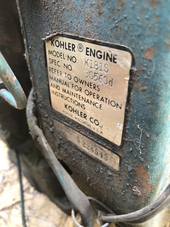

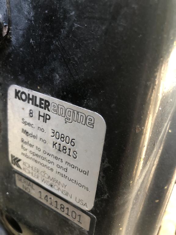

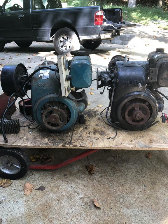

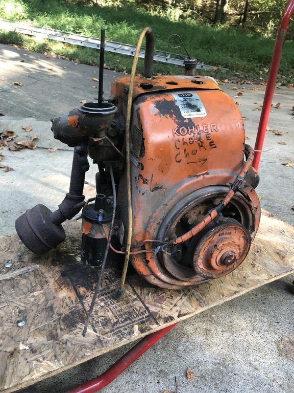

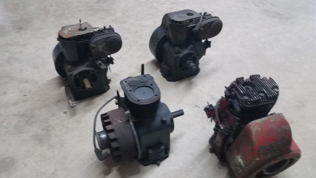

The Tuul Crib 7,354 #1 Posted September 17, 2019 Found these on Facebook from a local guy that was needing some cash. He just received word that he has some sort of cancer and was trying to clear out some of his collection. Buy just spinning they seem to have compresion but I will know more once I start dismantling. The K301 has a gear reduction on it which maybe I could find someone who needs it. The two k181s l can probably get running. Nice to have some back up in stock 6 1 1 1 Share this post Link to post Share on other sites

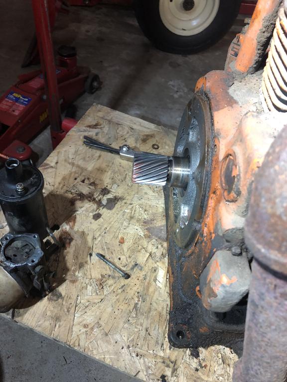

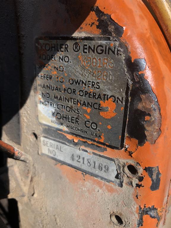

The Tuul Crib 7,354 #2 Posted September 18, 2019 So I got home today and decided to tear into the K301 and when I got the gear reduction off I had realized that this crank in this motor is designated for the gear reduction usage. Which would've been for a concrete mixer. This is definitely a learning curve for me. I did contact the guy that I got these motors from and he does have an extra crank that will work. 1 Share this post Link to post Share on other sites

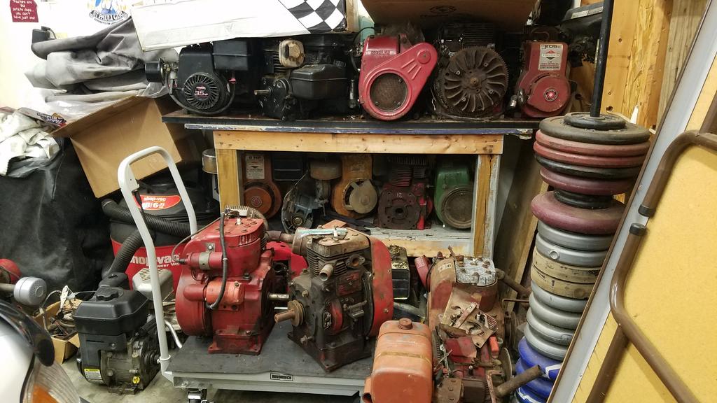

WHNJ701 4,172 #4 Posted September 18, 2019 (edited) any chance you get to buy old kohlers or older briggs take it. always good to a shelf full of engines ready for something. nothing wrong with gear reduction parts. they seem to sell quick when I come across them, guys want them for old walk behinds or ?? Edited September 18, 2019 by jabelman Share this post Link to post Share on other sites
oldredrider 2,553 #5 Posted September 18, 2019 Got a few myself...and there's more. 1 Share this post Link to post Share on other sites
WHX?? 56,846 #6 Posted September 19, 2019 (edited) Any time a guy comes across an K or M for a decent price take em Cribs. Old Red knows.. parts is always parts and you can often build a good motor off a couple some would pass as scrap. Cranks are fairly common yet for a 301. I recently scored these 90/91s cheap figuring I I could get one out of them plus some parts to make some friends. The shrouds alone were worth it. I ain't forgotten Jim @oliver2-44 you got dibs on a crank. Now just time to disassemble, clean & sort! Edited September 19, 2019 by WHX24 Share this post Link to post Share on other sites
WHNJ701 4,172 #7 Posted September 19, 2019 20 minutes ago, oldredrider said: Got a few myself...and there's more. don't mess with this guy... he bench presses all those weights 3 Share this post Link to post Share on other sites
WHX?? 56,846 #8 Posted September 19, 2019 What weights Jason. .I'm too busy eyeballin that SG K on the bench! 161 maybe 181??? Share this post Link to post Share on other sites

richmondred01 2,372 #11 Posted October 9, 2019 (edited) On 9/18/2019 at 6:25 PM, The Tool Crib said: So I got home today and decided to tear into the K301 and when I got the gear reduction off I had realized that this crank in this motor is designated for the gear reduction usage. Which would've been for a concrete mixer. This is definitely a learning curve for me. I did contact the guy that I got these motors from and he does have an extra crank that will work. It’s a Gravely configuration. for it to work on your wheel horse, as you stated a replacement crank and also shims to mount the pto lever to account for the lip in the block. Edited October 9, 2019 by richmondred01 Share this post Link to post Share on other sites
