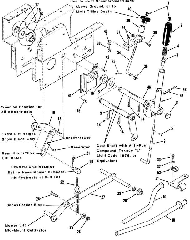

ebinmaine 78,488 #27 Posted September 13, 2019 6 hours ago, troutbum63 said: where do you hook up the helper spring @Ed KennellKennell Do you have pics of that? 7 hours ago, troutbum63 said: way more power than traction I have 4 oversized tires and fluid-filled ALL 4. Fluid weight is about 255 lbs. Also have over 100 lbs of steel on the rear. Also run ags and winter ice chains. All that weight makes a HUGE difference. 7 hours ago, troutbum63 said: Will just have to sneek it home without wife knowing hi hi. I dunno honey...... Horses are a herd animal.... I came home and there it was.... 1 Share this post Link to post Share on other sites

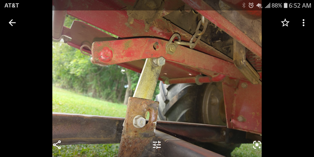

WVHillbilly520H 10,378 #28 Posted September 13, 2019 In this pic you can see where the rear clevis hitch cable is attached this is where the snow blower lift flag attaches then above that is of the round bars through the frame for the foot boards if where the other end of the helper spring goes... 1 Share this post Link to post Share on other sites

Ed Kennell 45,878 #30 Posted September 13, 2019 3 hours ago, ebinmaine said: @Ed KennellKennell Do you have pics of that. Jeff has the answer for the WH spring. When I had my three home made garage door springs on mine, I hooked them to a bar fixed in the mid attach-a-matic. 1 Share this post Link to post Share on other sites
