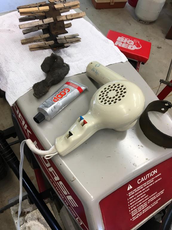

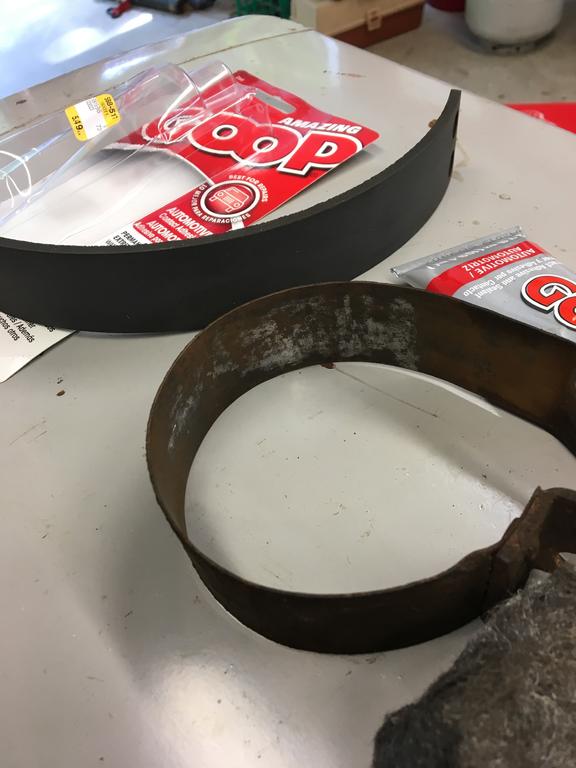

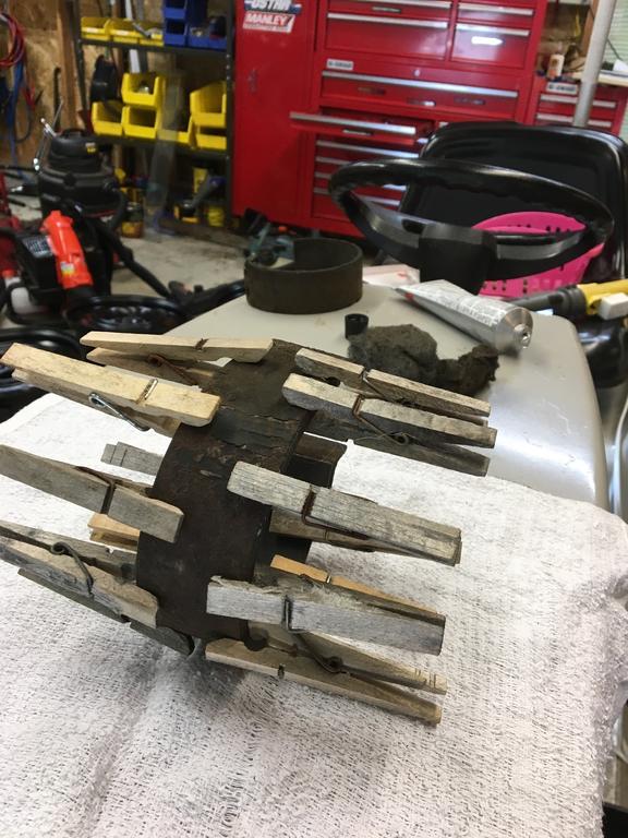

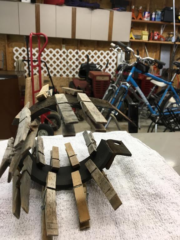

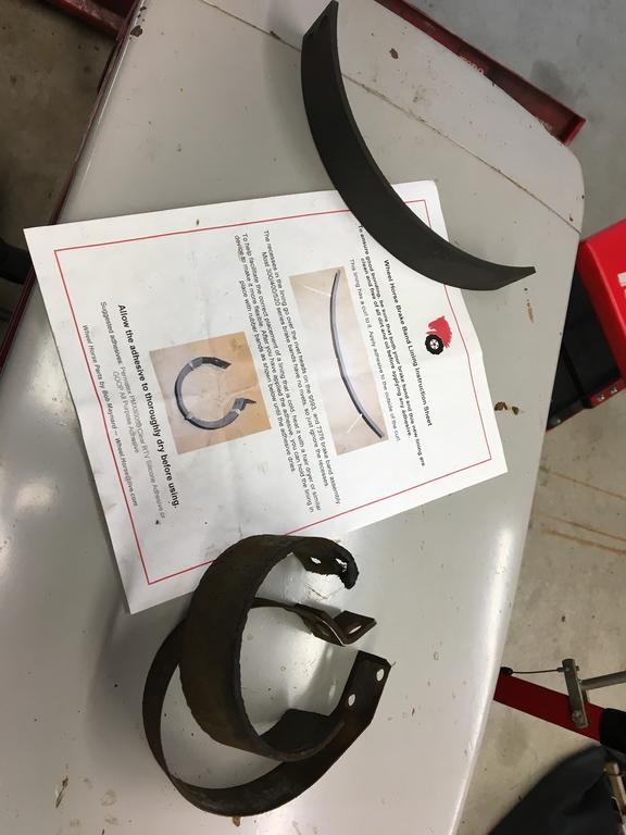

Sparky-(Admin) 26,299 #1 Posted September 8, 2019 What the heck kinda WH do-dad is this?? Used my Work Horse yesterday and noticed reduced braking. Finished up the landscape project, got it home, washed it off and found the brake lining had separated from the brake band. It was in crummy shape so re-adhering it was not an option. Just so happens that while at the 2017 or 2018 WH show I bought a new brake lining off our very own beloved Bob Maynard @rmaynard ...didn’t need one at the time but I like supporting our RS members when I can. Well today that purchase is paying off! Followed Bobs instructions, went with the Goop brand adhesive, warmed up the brake band with a hairdryer to increase flexibility and clothespins to hold it while it sets up. 9 5 2 Share this post Link to post Share on other sites

Sparky-(Admin) 26,299 #3 Posted September 8, 2019 6 minutes ago, OILUJ52 said: did one on the tractor, set it in place and set the brake. left it over night to cure, (used JB weld) my wife would not give up any cloths pins! My wife was out shopping...so I used her clothespins AND her hair dryer ! 5 1 7 Share this post Link to post Share on other sites

clueless 3,438 #8 Posted September 8, 2019 1 hour ago, Sparky said: What the heck kinda WH do-dad is this?? Used my Work Horse yesterday and noticed reduced braking. Finished up the landscape project, got it home, washed it off and found the brake lining had separated from the brake band. It was in crummy shape so re-adhering it was not an option. Just so happens that while at the 2017 or 2018 WH show I bought a new brake lining off our very own beloved Bob Maynard @rmaynard ...didn’t need one at the time but I like supporting our RS members when I can. Well today that purchase is paying off! Followed Bobs instructions, went with the Goop brand adhesive, warmed up the brake band with a hairdryer to increase flexibility and clothespins to hold it while it sets up. That last picture looks like was taken at my wife's hair salon . 4 Share this post Link to post Share on other sites
953 nut 69,133 #9 Posted September 8, 2019 20 minutes ago, clueless said: That last picture looks like was taken at my wife's hair salon . They use "GOOP" at her salon! ! ! ! I have used "Loctite Power Grab Ultimate" with good results. I bolt the cleaned brake backing into place on the , apply the Loctite to the lining and slip it into the backing then connect the brake rod, set the parking brake and adjust the rod. Doing this assures equal pressure on the lining and once it sets you are done. 4 2 1 Share this post Link to post Share on other sites

Sparky-(Admin) 26,299 #15 Posted September 8, 2019 43 minutes ago, Docwheelhorse said: Another trick is to clean the original as best as you can, coat in red rtv (oil resustant) and set parking brake like others have said. Its worked several times for me Tony Original is shot...very thin with pieces missing. Share this post Link to post Share on other sites

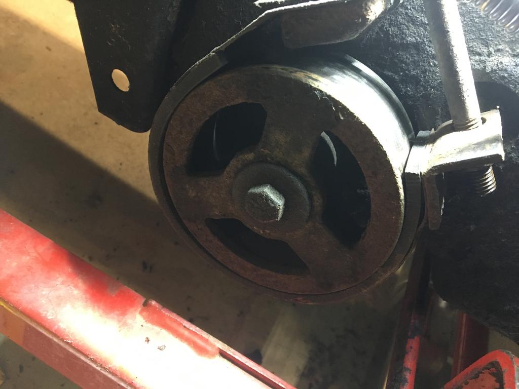

Sparky-(Admin) 26,299 #22 Posted September 13, 2019 So I’m back in Connecticut, time to finish up the brake job. Installed, tested, adjusted and tested again and WHAM! This sucker stops on a dime! Rear tires lock right up on pavement, going to have to get used to it. 3 Share this post Link to post Share on other sites
