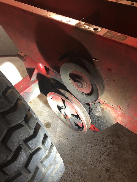

The Tuul Crib 7,354 #1 Posted September 7, 2019 I'm working on this 8 horse no name And I'm trying to find some information on drive belt size. Been looking through the manuals and haven't located much of anything. Would like to find out more information about the tractor such as what transmission it has and it's electrical system. Share this post Link to post Share on other sites

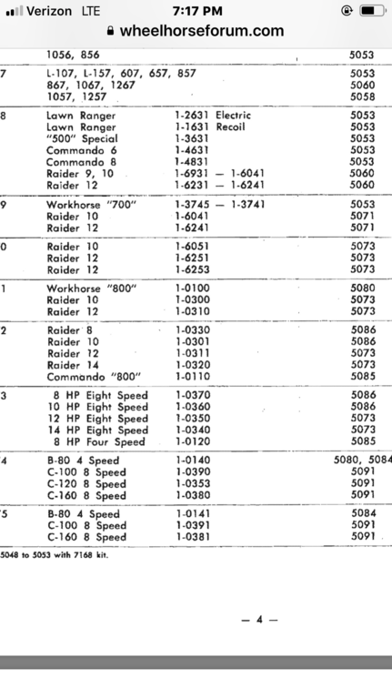

The Tuul Crib 7,354 #11 Posted September 7, 2019 1 minute ago, ebinmaine said: Randy I think those ONLY came with a 4-speed. No other options. OK then if the no-name eight speed was a 5086 what was the four-speed number ? That's what I'm trying to figure out. 1 Share this post Link to post Share on other sites

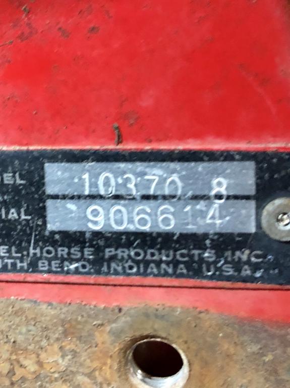

The Tuul Crib 7,354 #18 Posted September 8, 2019 Just now, ebinmaine said: I don't know if it is rare or not but as we all know Wheel Horse company would use what they had left over every year. If yours was a 1972 it should have been a named horse. Charger, electro, raider, etc.... Does the side of your horse have any stickers that indicate 4 speed or 8-speed? No there is nothing to indicate that at all. I'm looking at this chart my model # 10370 should be an 8 spd. 1 Share this post Link to post Share on other sites

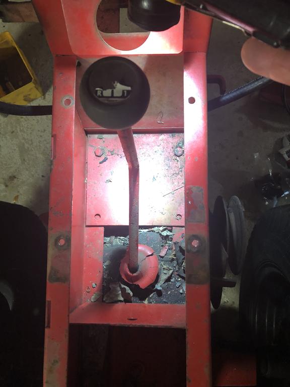

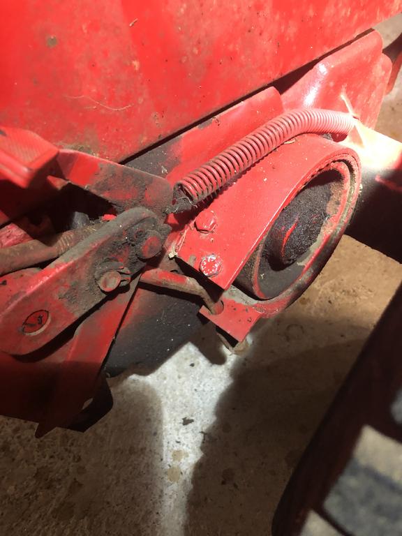

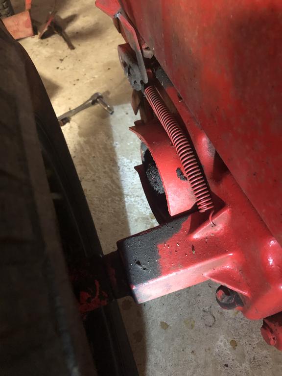

stevasaurus 23,746 #23 Posted September 8, 2019 I'm a little confused about what is being said in this thread. 1-0370 should be a 1973 8 hsp with the #5086 8 speed, 4 pinion with 1" axles. If this does not have the hi/low shifter or a place for it then it was replaced with a 4 speed. Give me a picture of the top of the trans by the shifter and a good picture of where the brake drum is. 1 Share this post Link to post Share on other sites
The Tuul Crib 7,354 #24 Posted September 8, 2019 1 hour ago, stevasaurus said: I'm a little confused about what is being said in this thread. 1-0370 should be a 1973 8 hsp with the #5086 8 speed, 4 pinion with 1" axles. If this does not have the hi/low shifter or a place for it then it was replaced with a 4 speed. Give me a picture of the top of the trans by the shifter and a good picture of where the brake drum is. This is not making sense to me either by the chart it should have an eight speed with that model number. The shaft on the pulley on the drive side seems wrong as well. Does not stick all the way out to the end of the Pulley. I'm just trying to figure out which transmission it might be 1 Share this post Link to post Share on other sites
