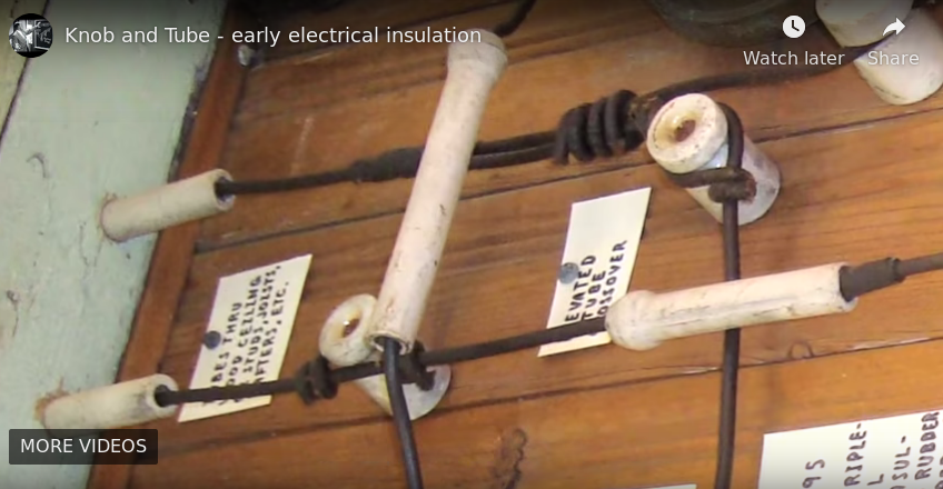

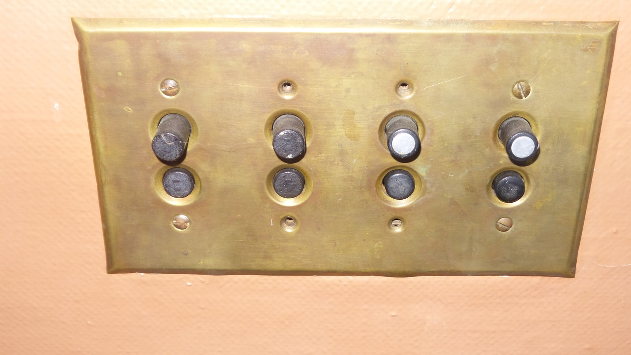

bc.gold 3,406 #1 Posted September 1, 2019 If you see light switches like these in that new house your thinking of buying be prepared to rewire to meet code. Knob and post wiring. There is a following of those who collect this old stuff. 7 Share this post Link to post Share on other sites

stevasaurus 23,544 #6 Posted September 2, 2019 Actually, that knob and tube wiring is pretty safe...until you try to use it for more then it was designed. Takes a big rat to lay across those wires to short them out. You also have to remember that those were 60 AMP days. The issue was up;dating to 100 or more AMP service, and if you tried to open one of those little, tiny boxes to put a 3 prong plug in...there was no ground. My Mom's house is a "Balloon Framed" house and is full of knob & tube. Anybody remember what a "ballooned framed" house is?? It is about 100 years old and can be protected as is. The city would rather have a fire, but the town is old enough to have a bunch of them still standing. I actually had some knob and tube in my attic, when I up-graded that. It is all gone now...my house was build in about the early 40's. 6 Share this post Link to post Share on other sites

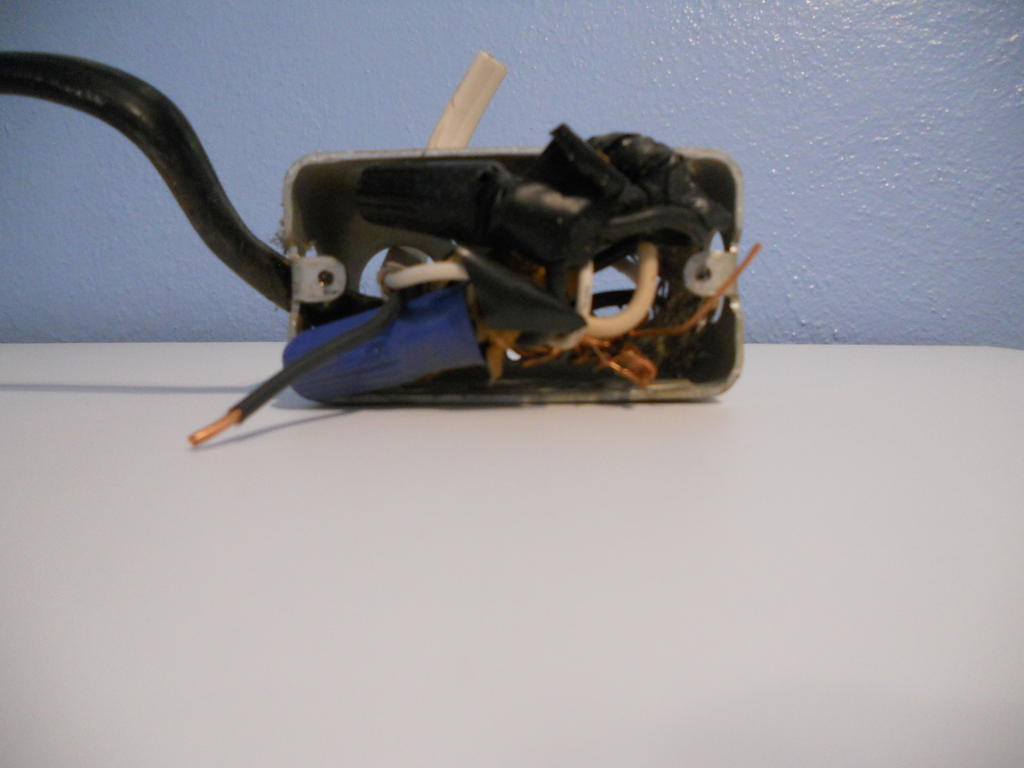

Racinbob 12,552 #8 Posted September 2, 2019 Our house was built in 1935 with an addition that doubled the size added in 2002. My original plan was to just go through things and make it safe but quickly discovered that wasn't good enough. Over the years and probably mostly when the addition was built a contractor came in and butchered things so bad my best bet was a complete demo and rewire. That same contractor (I have the receipts) did the addition and the two garages. The wire itself was OK but the circuiting and workmanship was horrendous. Both garages got rewired and every circuit in the addition was thoroughly checked and made safe. As far as the original house, it was like Chip Gaines DEMO DAY. Everything went in a dumpster and all new wiring, plumbing, some HVAC, walls, ceilings and flooring were done. Even relocated a stairway. The bottom line is that the knob and tube, BX and the older cabling is usually safe when installed but becomes outdated for todays power requirements. Then add the idiots that come in and cobble things so bad as to make a very dangerous situation. 3 Share this post Link to post Share on other sites
Racinbob 12,552 #9 Posted September 2, 2019 For example: The home inspectors solution? "Install cover plate" Similar and even worse examples were all over the house. Home inspectors should NOT be allowed to inspect the electrical. 2 2 Share this post Link to post Share on other sites

JERSEYHAWG / Glenn 4,516 #12 Posted September 4, 2019 Those old push buttons brought back memories of my grandparents home. Glenb 1 Share this post Link to post Share on other sites

Sparky-(Admin) 24,415 #14 Posted September 5, 2019 Completely removing all knob/tube and rewiring is tough, actually nearly impossible if the walls and ceilings aren't opened up. Steve @stevasaurus is correct that if left alone knob/tube isn't bad wiring. But nowadays we have so much stuff that needs to be powered that those old circuits and wires are getting taxed way beyond what they should be. Unless your forced by an insurance company or building inspector to rewire all of a house the best fix is to simply run new circuits for all the larger loads. Rather than just plug in a couple window AC units to existing wall outlets run a dedicated circuit or two right to those windows. Run a dedicated circuit to the fridge and the microwave, both are high amperage draws. Dedicate a circuit for the bathroom outlet where your wife (or maybe you ) runs a 1200 watt hair dryer each day. That hair dryer alone is a 10-11 amp draw! Taking these loads and others like them off the existing knob/tube will ensure that the old wiring doesn't get overloaded. 2 1 Share this post Link to post Share on other sites
