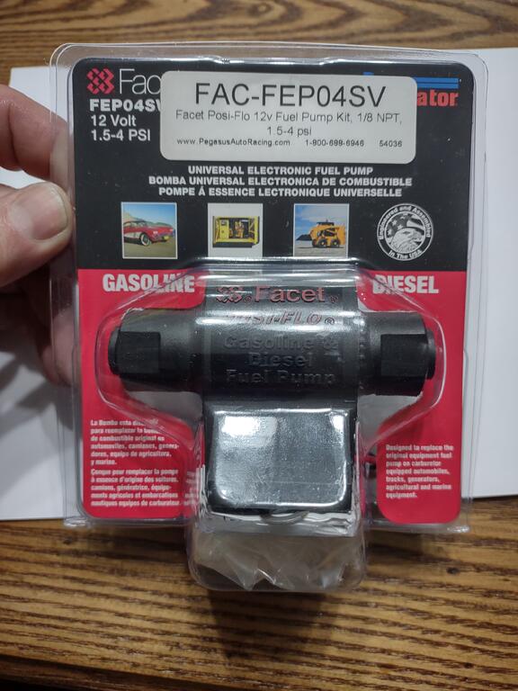

ebinmaine 79,767 #1677 Posted February 24, 2022 The fuel pump on the Kohler does work but it's a little "loose". Likely fine but I don't like it. I decided to go electric. 6 2 Share this post Link to post Share on other sites
Oldskool 6,678 #1678 Posted February 25, 2022 1 hour ago, ebinmaine said: The fuel pump on the Kohler does work but it's a little "loose". Likely fine but I don't like it. I decided to go electric. Hi-tech. I like it. 1 Share this post Link to post Share on other sites
ebinmaine 79,767 #1679 Posted February 25, 2022 1 minute ago, Oldskool said: Hi-tech. I like it. Might well be the only "modern" thing on this rig. 1 1 Share this post Link to post Share on other sites

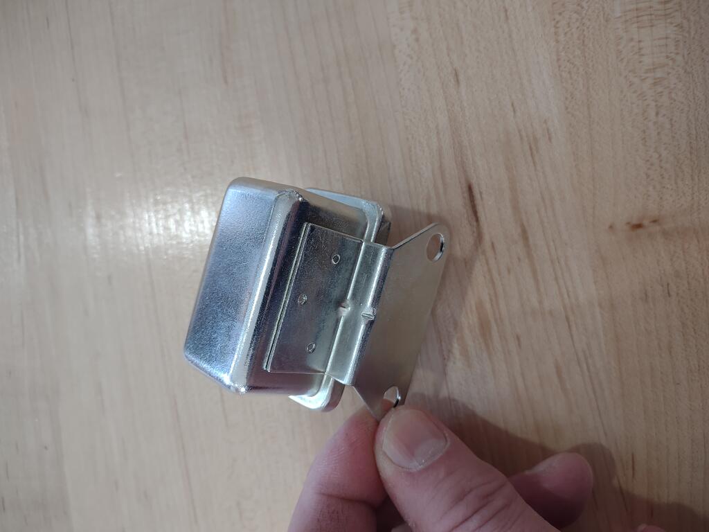

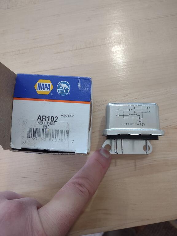

ebinmaine 79,767 #1680 Posted March 5, 2022 Got a nice metal fuel pump relay. This'll fit in the build much better than a plastic housing relay. Thanks to @squonk for the part number! 5 3 Share this post Link to post Share on other sites
wallfish 20,245 #1681 Posted March 5, 2022 What's the advantages of using a relay instead of just wiring it directly? Electronics is not my strong suit so just wondering if mine should get a relay 2 Share this post Link to post Share on other sites
Achto 32,128 #1682 Posted March 5, 2022 (edited) 4 minutes ago, wallfish said: What's the advantages of using a relay instead of just wiring it directly? If the switch is heavy enough for the load a relay is not nessasary. Relay's are usually rated higher. Use a small load to close the relay switch, let the relay carry the heavy load. Edited March 5, 2022 by Achto 4 4 Share this post Link to post Share on other sites
wallfish 20,245 #1683 Posted March 5, 2022 T 2 minutes ago, Achto said: If the switch is heavy enough for the load a relay is not nessasary. Relay's are usually rated higher. Use a small load to close the relay switch, let the relay carry the heavy load. That's kind of what I was thinking like a starter solenoid does but are those pumps too heavy of a load for a regular key switch? 2 Share this post Link to post Share on other sites
ebinmaine 79,767 #1684 Posted March 5, 2022 4 minutes ago, wallfish said: T That's kind of what I was thinking like a starter solenoid does but are those pumps too heavy of a load for a regular key switch? The pump I'm using should be fine but I figured I'd give it a little insurance. 3 1 Share this post Link to post Share on other sites
wallfish 20,245 #1685 Posted March 5, 2022 Do they also work as a fuse too? I prefer less wire connections and devices if possible. But --- I have a parasitic drain issue on one and just can't seem to hunt it down. It seems to be one of the motors for the chute controls so maybe throwing a couple of relays inline should do the trick to disconnect them. 4 1 Share this post Link to post Share on other sites
lynnmor 8,921 #1686 Posted March 5, 2022 36 minutes ago, wallfish said: What's the advantages of using a relay instead of just wiring it directly? Electronics is not my strong suit so just wondering if mine should get a relay I don't know how @ebinmaine is wiring it in, but a relay can be useful in systems using safety switches so that nearly all of the load is removed from them. 3 Share this post Link to post Share on other sites
Achto 32,128 #1687 Posted March 5, 2022 5 minutes ago, wallfish said: Do they also work as a fuse too? They do not work as a fuse. But if you use a relay to send power to your shoot it would be a positive disconnect for those accessories. 3 Share this post Link to post Share on other sites
squonk 47,464 #1688 Posted March 5, 2022 (edited) Take apart one of those Indak key switches and look at the contacts in them. That's why I use a relay. Not necessary but I rather have the relay handle a constant load. Used to use relays in refrigeration equipment all the time. The thermostats would have these tinny contacts that were handling full compressor draw. And of course like everything else they are made cheaper now days. So after a few time where a stat would weld itself shut and ruin a cooler full of product we would wire a relay so when the stat closed it would just power the relay coil and the heavy contacts of the relay would handle compressor amps. Yes another item to fail and more cost but it was better than losing thousands of dollars of product. And we used good relays. No Dayton junk. Edited March 5, 2022 by squonk 3 2 Share this post Link to post Share on other sites
ebinmaine 79,767 #1689 Posted March 5, 2022 5 hours ago, squonk said: Not necessary but I rather have the relay handle a constant load That was my thought process as well. 7 hours ago, lynnmor said: I don't know how @ebinmaine is wiring it in, but a relay can be useful in systems using safety switches so that nearly all of the load is removed from them. Most likely I'll be running the low amp side off the ignition switch so the relay, and hence the fuel pump, is powered when the key's on. 1 Share this post Link to post Share on other sites
