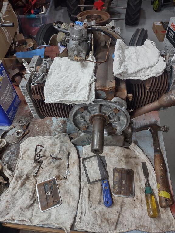

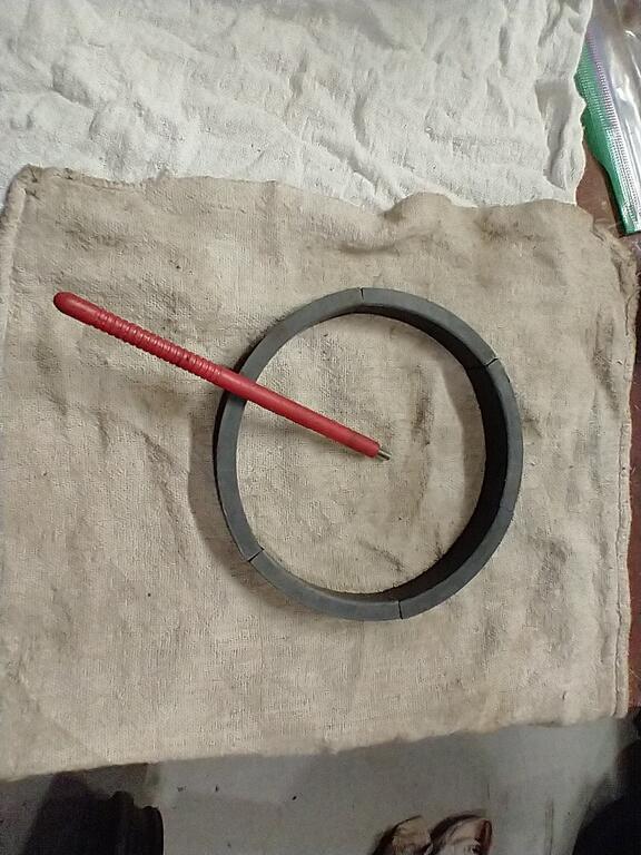

ebinmaine 80,423 #1489 Posted January 21, 2022 (edited) The BBT spent more time cleaning up the nasty off the powerplant for this beast. Tossed a goodly bit of acetone around. We looked at an old thread about flywheel magnets and how to reattach them. ALL 6 of these were easily removed. 2 were loose. We checked the polarity and lined them up to be glued in sometime soon. Edited January 21, 2022 by ebinmaine Added pic 4 Share this post Link to post Share on other sites
Gregor 4,848 #1490 Posted January 21, 2022 7 hours ago, ebinmaine said: We checked the polarity and lined them up to be glued in sometime soon. Just for the heck of it, break one in half, put it back together, and see if the polarity stays the same. I'm curious. 3 Share this post Link to post Share on other sites
ebinmaine 80,423 #1491 Posted January 21, 2022 5 minutes ago, Gregor said: Just for the heck of it, break one in half, put it back together, and see if the polarity stays the same. I'm curious. Much as I'd love to experiment with you I'll go ahead and let you try it. 😂 For the record, it wouldn't work just like that because these magnets are poled either N. S. N. or S. N. S. Line em up end to end in a circle ⭕ and that's 18 changes of polarity which I assume perhaps gives one 36 volts???? 1 Share this post Link to post Share on other sites
Lee1977 7,750 #1492 Posted January 21, 2022 5 hours ago, ebinmaine said: Much as I'd love to experiment with you I'll go ahead and let you try it. 😂 For the record, it wouldn't work just like that because these magnets are poled either N. S. N. or S. N. S. Line em up end to end in a circle ⭕ and that's 18 changes of polarity which I assume perhaps gives one 36 volts???? You should have 18 post on the stator 15 amp. output. I have tested as much as 41 voilts AC. 2 1 Share this post Link to post Share on other sites
Handy Don 17,356 #1493 Posted January 21, 2022 5 hours ago, ebinmaine said: Line em up end to end in a circle ⭕ and that's 18 changes of polarity which I assume perhaps gives one 36 volts???? The number of magnets in combination with the stator coils determines the number of current reversals per rotation of the flywheel. I'm guessing 18 coils on the stator so 9 "plus" and 9 "minus" pulses per rotation. In tech-speak, that's 9 hertz at 60 RPM (vs. 60 hertz for your household AC current). The size of the magnets and number of windings in the coils determines the voltage/amperage of the output. 3 1 Share this post Link to post Share on other sites

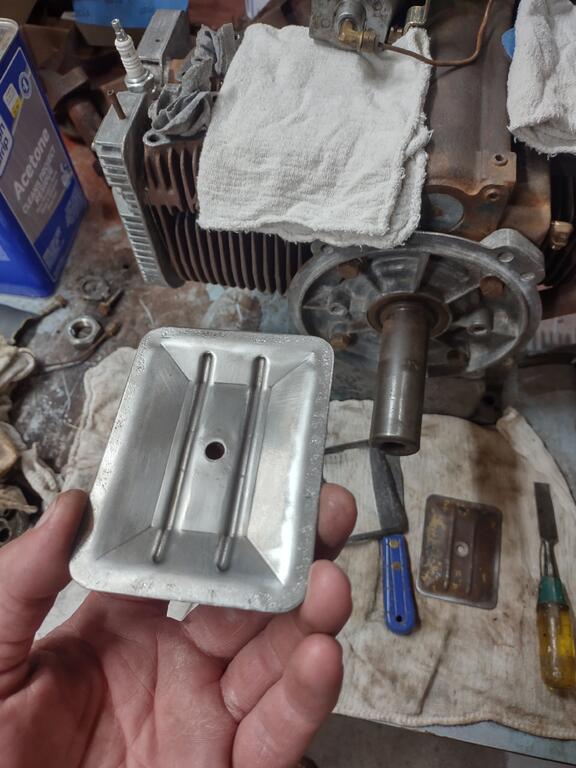

ebinmaine 80,423 #1497 Posted January 22, 2022 Got a gasket kit today from isavetractors. I chose his because it was the kit WITH FIRE RINGS on the cylinder head gaskets at the best price. I did take a few minutes to remover the valve covers and clean up the gasket surfaces. I'll figure out how to check the valve lash tomorrow. If anyone knows where I can find an engine manual I'd appreciate it. 2 2 Share this post Link to post Share on other sites
