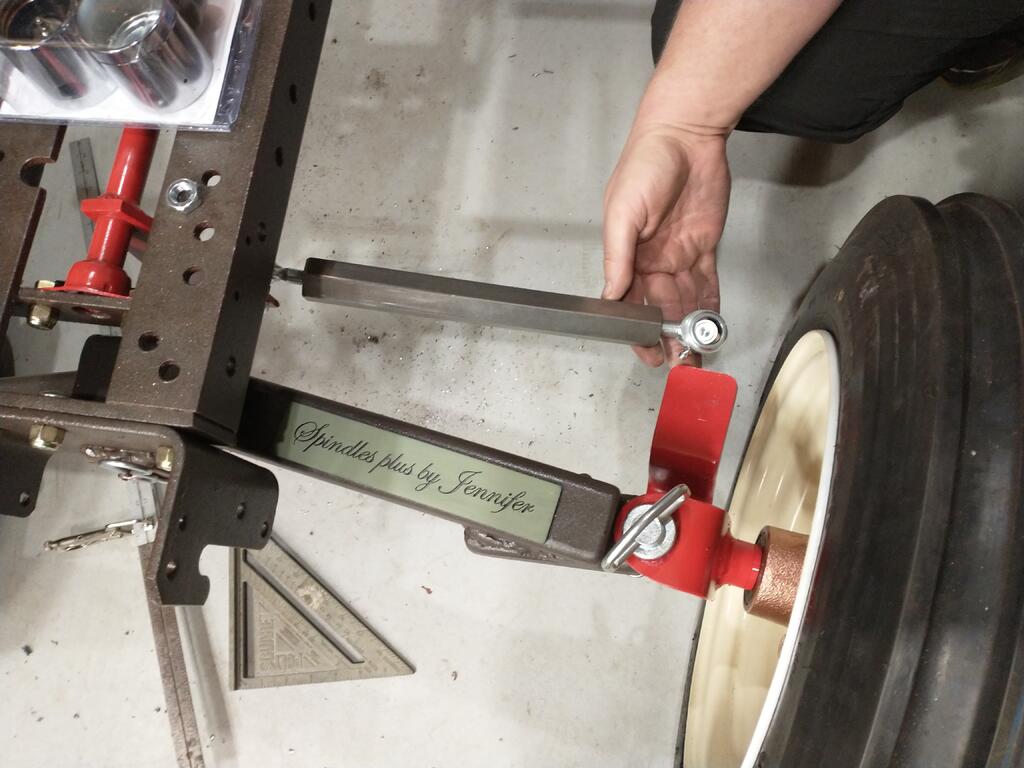

ebinmaine 80,424 #1176 Posted April 17, 2021 8 minutes ago, OldWorkHorse said: Seems like a pretty good idea! Looks good man! Yessir it sure was. Ya done good. Next time I'll measure the proposed needed length and slice off the other side with my new toy bandsaw. Another great idea from you. 👍👍👍 I'm thinking I'll use a grinder or angle chop saw to narrow down the ends a little. 1 1 Share this post Link to post Share on other sites

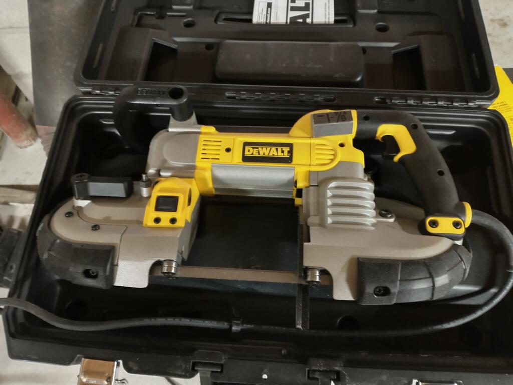

ebinmaine 80,424 #1198 Posted April 20, 2021 Ok first of all. New DeWalt bandsaw. UTTER. BEAST. What an incredible piece of equipment. Everyone who ever reads this should tell everyone they know and 2 dozen they don't know that Eric me Bear 🐻 says this is THE BEES KNEES. Well the reason I got that at all is for the new found interest in heat sticking metal together. I tried it tonight to cut that 1-1/8" mild steel hex rod. Just. Butter. I sliced up one of the tie rods to size. Drilled and tapped it. Tried it out. Seems to be a usable length with good adjustment. Oh yes and a bonus pic. This is a young barred owl that was hanging out in the road this morning. I backed up past it to check welfare. It flew about 5 feet to the edge of the road so it was likely ok. For scale it was around 10 or 11 inches as standing. 7 Share this post Link to post Share on other sites
