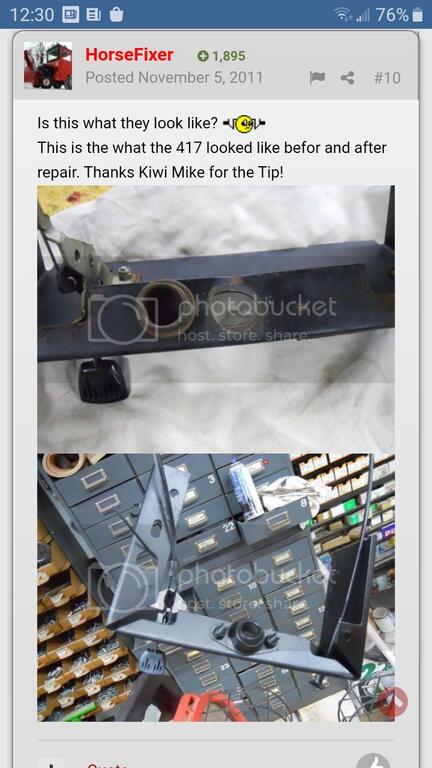

Stormin 9,988 #901 Posted January 31, 2021 (edited) That's the type of bearing I was meaning. Some one on here has done the mod. Just can't think who. Peter Lena maybe?? Edited January 31, 2021 by Stormin 1 Share this post Link to post Share on other sites

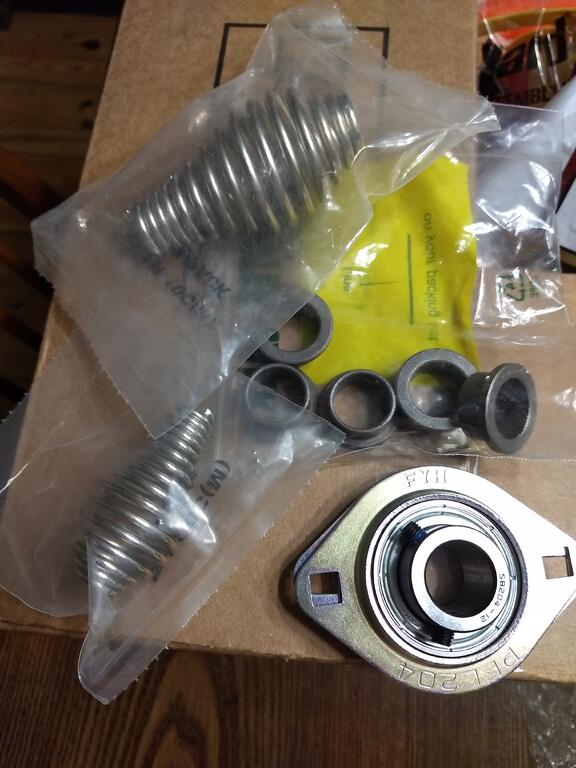

ebinmaine 80,711 #904 Posted January 31, 2021 1 hour ago, Stormin said: That's the type of bearing I was meaning. Some one on here has done the mod. Just can't think who. Peter Lena maybe?? Yessir. @peter lena I found one on Mcmaster Carr. Ordered a few other things as well.... 2 Share this post Link to post Share on other sites
peter lena 10,065 #905 Posted January 31, 2021 oldskool , this the bearing type I use on steering columns , https://www.vxb.com/3-4-UCFL-204-12-2-Bolts-Flanged-Housing-Mounted-p/Kit16836.htm?gclid=Cj0KCQiAx9mABhD0ARIsAEfpavQPxQNpN--9ub7Y6bGSrVcURccHmWmUS1YWYbX0hWQ8WrgqUj3KXoAaAqimEALw_wcB internet pricing is about 7 $ , there are a number of this type of flange bearings on this site , flange is so solid , that you can build a brace off of it , which is what I did , firmed up the entire dash area, pete 4 1 Share this post Link to post Share on other sites
Stormin 9,988 #906 Posted January 31, 2021 My memory is better than I thought. 1 3 Share this post Link to post Share on other sites

ebinmaine 80,711 #908 Posted January 31, 2021 2 hours ago, peter lena said: this the bearing type I use Hey thanks for posting that Pete. 2 Share this post Link to post Share on other sites

Oldskool 6,678 #912 Posted February 4, 2021 8 minutes ago, ebinmaine said: I missed something. What's up with the springs? Share this post Link to post Share on other sites
ebinmaine 80,711 #913 Posted February 4, 2021 14 minutes ago, Oldskool said: I missed something. What's up with the springs? Think stove door...... 1 Share this post Link to post Share on other sites
Pullstart 71,253 #914 Posted February 4, 2021 2 hours ago, Oldskool said: I missed something. What's up with the springs? 2 hours ago, ebinmaine said: Think stove door...... Handle for.... I’m still missing something! 1 Share this post Link to post Share on other sites
elcamino/wheelhorse 9,363 #915 Posted February 4, 2021 @pullstart think wood stove. Share this post Link to post Share on other sites
Pullstart 71,253 #916 Posted February 4, 2021 17 minutes ago, elcamino/wheelhorse said: @pullstart think wood stove. Ahh, Ok. What now? 3 Share this post Link to post Share on other sites
ebinmaine 80,711 #917 Posted February 4, 2021 4 hours ago, Oldskool said: I missed something. What's up with the springs? 2 hours ago, elcamino/wheelhorse said: @pullstart think wood stove. 2 hours ago, pullstart said: What now? Boys... Them there handles are my shifter "knobs". 7 1 1 Share this post Link to post Share on other sites
Oldskool 6,678 #918 Posted February 4, 2021 6 hours ago, ebinmaine said: Boys... Them there handles are my shifter "knobs". Neat idea. I like it 2 1 Share this post Link to post Share on other sites
ebinmaine 80,711 #919 Posted February 4, 2021 6 minutes ago, Oldskool said: Neat idea. I like it Thanks Mike. I was on McMaster Carr looking for something else and I saw that they sold handles and knobs so I scrolled down through their assortment.... 2 3 1 Share this post Link to post Share on other sites
