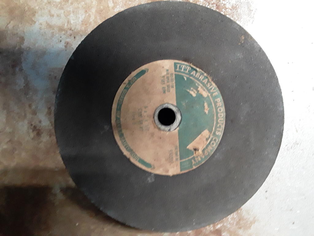

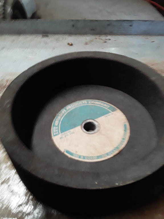

Stike 204 #1 Posted August 20, 2019 Got these grinding wheels from a machine shop my son worked at, the owner told him trash them or take them home, so like me he brought them home, gotta stop taking home those "I can use it for something" things. Lol. I've never seen a wheel like this before, and thought this is the place to ask, anyone have any thoughts? I have 6 of them nos, if anyone has a use for them I'll ship for the cost of shipping, my pedastill grinder is 5/8 arbor so I can't use them, they are 2 inch wide by 1-1/2 recessed by 1/2 thick. 1 Share this post Link to post Share on other sites
Stike 204 #2 Posted August 20, 2019 Forgot they are 6 inch. 6x2x1/2. Share this post Link to post Share on other sites
JAinVA 4,638 #3 Posted August 20, 2019 (edited) Might have been sold for tool a grinder mount.The ones I have used were metal with a Borazon or Carbide grinding surface.That style of wheel was also used on stationary valve grinders.Put a metal rod in the mounting hole and tap the disk lightly with a metal object.If it doesn't ring slightly, junk them. Edited August 20, 2019 by JAinVA 3 Share this post Link to post Share on other sites
Ed Kennell 47,692 #4 Posted August 21, 2019 Just a heads up. Make sure the max RPM is not exceeded. Always a good idea to do a remote start up of any newly mounted wheel ….especially one that is not being used or mounted as designed. 1 Share this post Link to post Share on other sites
