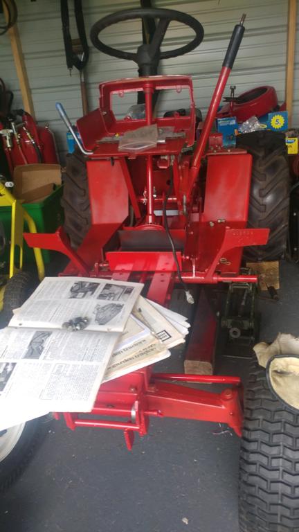

Clarence T. Nolley Jr 14 #11 Posted August 28, 2019 Hello i am Clarence Nolley, US army and NC Army National Guard retired, love to take pictures as another hobby of mine and working on my wheelhouse C160 tractor which i acquired from a now deceased neighbor. i have two and the other one is a parts tractor. 1 Share this post Link to post Share on other sites
ebinmaine 80,087 #12 Posted August 28, 2019 Gonna be a nice looking ride when you're done. Share this post Link to post Share on other sites
953 nut 68,162 #13 Posted August 28, 2019 Welcome @Clarence T. Nolley Jr, glad you found us. Looks like you are well on your way to a great looking . Any questions that might come will get a quick response here. Share this post Link to post Share on other sites
