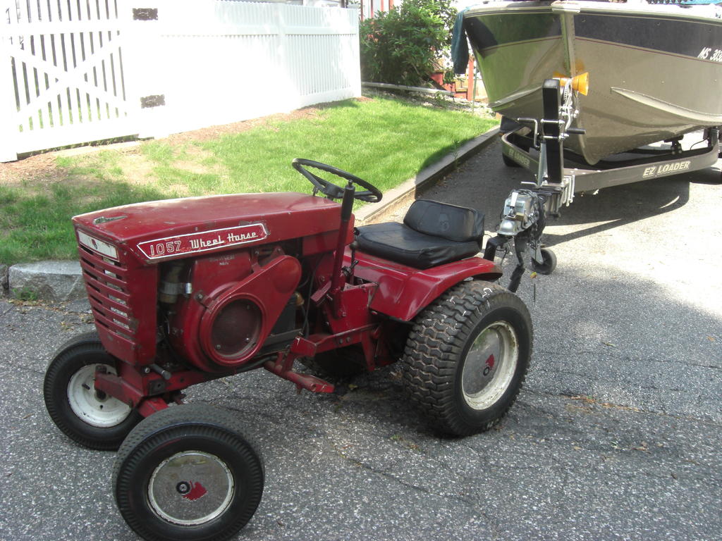

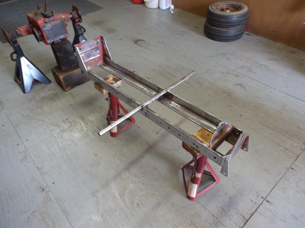

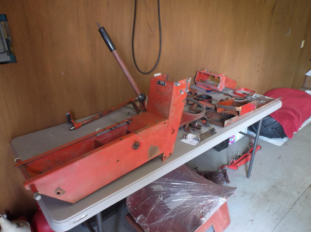

PA.BOB 68 #1 Posted August 17, 2019 Hi everyone. Well finally found my first Wheel Horse a few months back.. Its a 1966 1057 . Its in pretty decent shape . All original except the steering wheel. Has the original Wheel horse tires on it yet . Not to good though. I got a snow plow and the deck with it. Has the original 10 horse Kohler. I think it had some engine work done to it . There is another tag on it . i think it has something to do with the bearings. It runs and sounds good. no smoke. So my plans are to strip the tractor down and restore it. I started tearing everything apart. Taking a lot of pictures. And labeling everything. and making diagrams of stuff. The rear and trans seams pretty good .Gear oil nice and clean. The axles don't have any play or slop. Looks like somebody might have repaired them. . The rear axles measure 1 1/18 . Is that correct for this rear ? I thought 1 1/8 axles were in 8 speeds only. I'm just learning. Don't know. I really appreciate all the help from all of you guys on this great forum. I don't think i would have bought a wheel horse if it wasn't for this forum. I will be asking you guys a lot of questions. So i hope you don't get mad at me. I'm not to good with computers either. So you might have to bear with me. I am going to try to post some pictures . I know you guys like pictures . I finally finished the hood this morning. Thai isn't going to be know show tractor. Just a nice restoration of it , i Hope...............I am using Duplicolor red engine enamel with ceramic in it. 5 coats of red .Then i wet sanded it. Then buffed it. Then waxed it. NO clear coat. It turned out pretty nice . It looks much nicer in real life. All the parts will be stripped to bare metal.. So here's some pictures . I hope. They only let me put 2 pictures on . I will try it again. Thanks again everyone. Bob.................. 6 1 Share this post Link to post Share on other sites

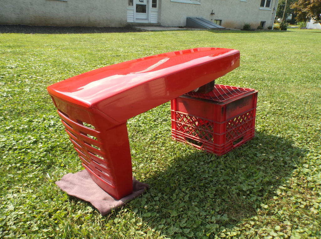

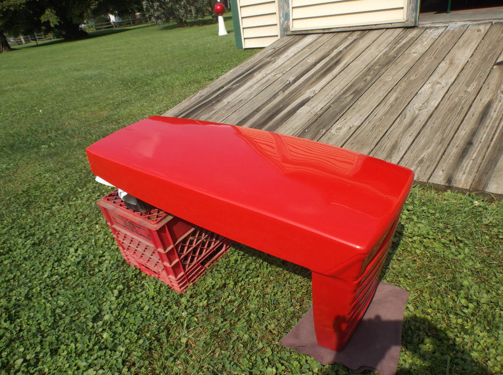

Terry M-(Moderator) 2,329 #4 Posted August 17, 2019 Nice Paint Job!! 1 Share this post Link to post Share on other sites
67 WH 877 62 #5 Posted August 17, 2019 Nice work... Share this post Link to post Share on other sites
stevasaurus 23,884 #6 Posted August 17, 2019 The 1st thing is that a 1057 is a 1967 horse. The transmission is a #5058. This means that it is a "Heavy Duty" 3 speed with 1 1/8" axles. It also has the bevel gear differential...no pinions. The paint job looks great. 7 1 Share this post Link to post Share on other sites

PA.BOB 68 #9 Posted August 17, 2019 Thanks guys for all your nice reply's. Yes Steve. I screwed up, I know its a 1967. Don't know why i put 1966 down. I am starting to forget a lot of things ! Oh Boy. Wonder if they can change the title on my post to 1967 ? I will keep you updated with pictures. Do you think its OK to post the pictures on this same thread? Thanks again everyone. Bob.................... 2 Share this post Link to post Share on other sites
PA.BOB 68 #10 Posted August 17, 2019 Thanks Stevasaurus for cluing me in on my transmission and differential. Much appreciated . Do you think this trans is almost as good as the 8 speed? Talk to you all later. Bob................... Share this post Link to post Share on other sites

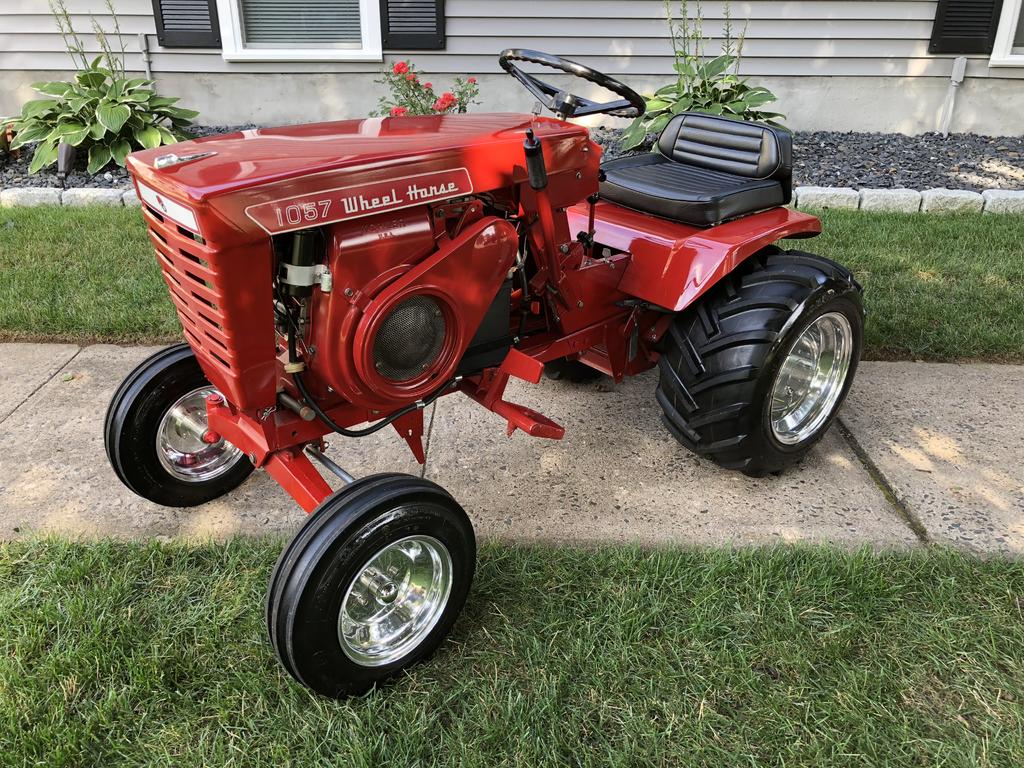

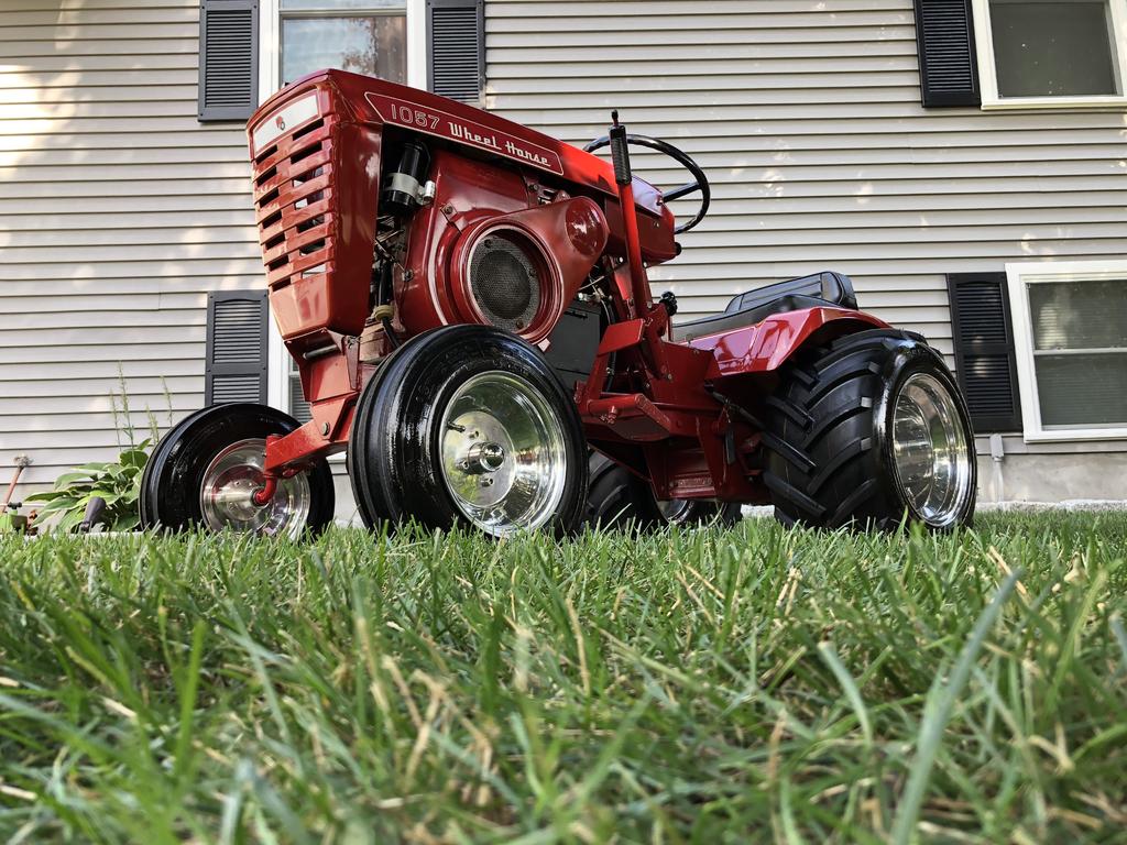

whtractors24 3,572 #21 Posted August 18, 2019 13 hours ago, Retierd Wrencher said: Bob nice tractor I had two of them this was the best running engine I ever had. Very smooth Life lessen on the had. What do you plane on doing with it? Just take your time and enjoy the project. Looking forward to seeing more picks. I also suggest what rjg854 said. It helps keeping this site going. Yes you did 🤷♂️I tradednit and just got her back . You did a heck of job on the motor it runs like a top I enjoy it . Share this post Link to post Share on other sites
whtractors24 3,572 #22 Posted August 18, 2019 On 8/17/2019 at 12:27 PM, PA.BOB said: Hi everyone. Well finally found my first Wheel Horse a few months back.. Its a 1966 1057 . Its in pretty decent shape . All original except the steering wheel. Has the original Wheel horse tires on it yet . Not to good though. I got a snow plow and the deck with it. Has the original 10 horse Kohler. I think it had some engine work done to it . There is another tag on it . i think it has something to do with the bearings. It runs and sounds good. no smoke. So my plans are to strip the tractor down and restore it. I started tearing everything apart. Taking a lot of pictures. And labeling everything. and making diagrams of stuff. The rear and trans seams pretty good .Gear oil nice and clean. The axles don't have any play or slop. Looks like somebody might have repaired them. . The rear axles measure 1 1/18 . Is that correct for this rear ? I thought 1 1/8 axles were in 8 speeds only. I'm just learning. Don't know. I really appreciate all the help from all of you guys on this great forum. I don't think i would have bought a wheel horse if it wasn't for this forum. I will be asking you guys a lot of questions. So i hope you don't get mad at me. I'm not to good with computers either. So you might have to bear with me. I am going to try to post some pictures . I know you guys like pictures . I finally finished the hood this morning. Thai isn't going to be know show tractor. Just a nice restoration of it , i Hope...............I am using Duplicolor red engine enamel with ceramic in it. 5 coats of red .Then i wet sanded it. Then buffed it. Then waxed it. NO clear coat. It turned out pretty nice . It looks much nicer in real life. All the parts will be stripped to bare metal.. So here's some pictures . I hope. They only let me put 2 pictures on . I will try it again. Thanks again everyone. Bob.................. Is this out of a rattle can ? If so maybe a pic of the color . Share this post Link to post Share on other sites

PA.BOB 68 #24 Posted August 19, 2019 rjg854 yes i am going to be a supporter.And thank you for recommending it to me. AMC RULES, I will keep updating on this same thread. And thank you. 953 nut ,Thanks for letting me know. I will be just using it to plow some snow.. I am not going to cut with it. PULLSTART, Thanks, it looks pretty good for spray cans. I wet sanded it . And kept buffing it out. And i didn't use any clear coat. Thanks Stormin. Thanks ebinmain, Just plow some snow with it. And just use it around the house. . Eb. where did you get your chains for your Ag tires ? Because that's what i am putting on mine . I have wide ones. RETIRED WRENCHER. Thank you. I am just going to plow some snow with it and use it around the house. Thank you Pollack Pete. Thank you dclarke. Thank you Steve for all your helpful information. WHTRACTORS24 , I been using your 1057 picture as my screen saver. And for reference. Hope you don't mind. I have my tires and wheels for it also. Matt castagno's father in law did my seat also .Beautiful tractor you got. You did a beautiful job on it.. Hope mine turns out 1/2 as nice as yours. Thank you tool crib. This forum is so cool. This is like a family here. You people are so nice. Bob.............................. 2 Share this post Link to post Share on other sites
