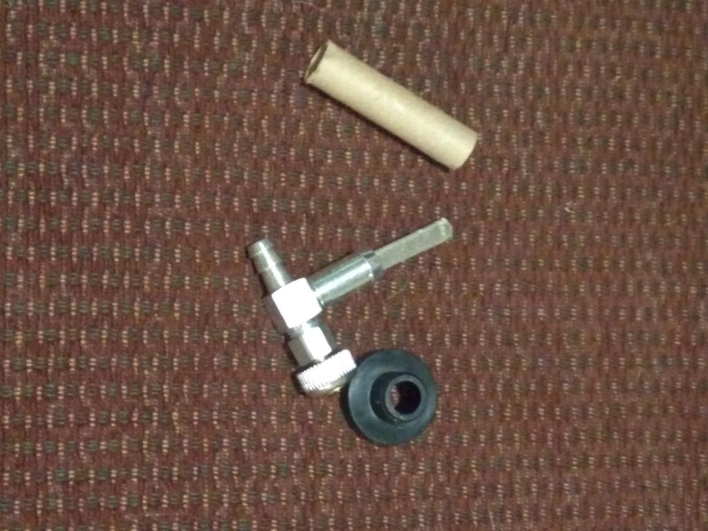

TDF5G 2,074 #1 Posted August 13, 2019 HELP! I'm having great trouble trying stop a fuel leak on my Dad's B-80. It's leaking from around the grommet/bushing. I bought a ten pack of new bushings a while back on eBay. I've tried about 6-7 different ones and a even new shut-off valve with no luck. So I bought a used tank from a RS member here, (thinking the tank must be bad) and I'm having the same problem with it also, after trying several different new bushings and a new shut-off valve on it. Both of these are definitely leaking between the tank and the bushing/grommet in exactly the same way. I have no idea what to do now. I've replaced these bushing before on other tractors with great results. I just don't get it. The only thing I can think of at this point is, I'm wondering if all bushings are not created equal? Are there some inferior brands out there that do not work well? It seems if the bushing was just slightly larger it might make a better seal. Todd Share this post Link to post Share on other sites

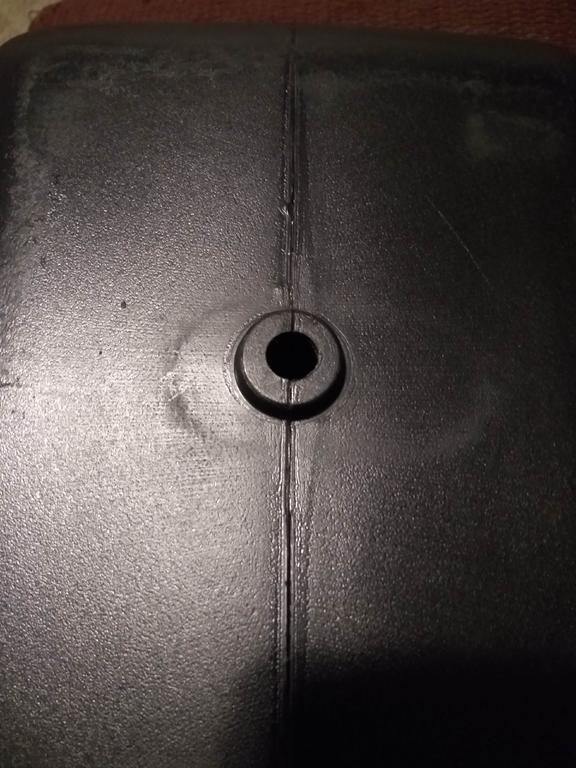

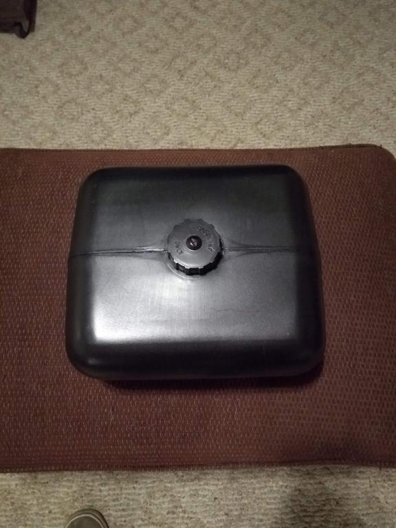

TDF5G 2,074 #12 Posted August 15, 2019 (edited) 2 minutes ago, TDF5G said: Well, here is the verdict: Both tanks are cracked, the original one and the used one I bought recently. I put the bushing and valve in each tank and got in a dark corner of the basement with an LED flashlight shining through the cap opening to find the cracks. Both are cracked in the exact same spot, right in the mold seam on one side of the bottom hole. The original tank has just a very slight crack that is barely visible. The other one is much larger. Thanks to everyone for all the replies and help. I learned something today. I just had no idea and never expected this. I've had leaks on other tractors, and a new bushing always took care of it. RS is a great forum! Todd Edited August 15, 2019 by TDF5G Share this post Link to post Share on other sites
