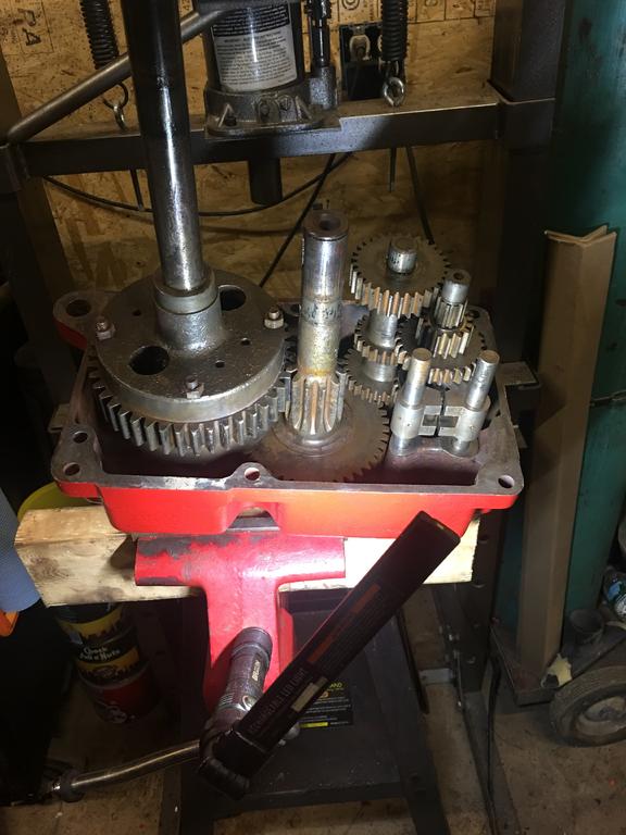

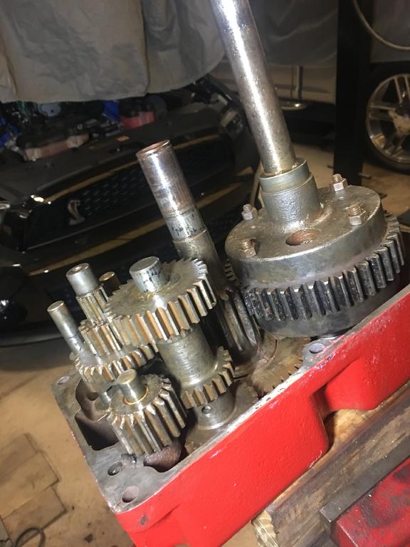

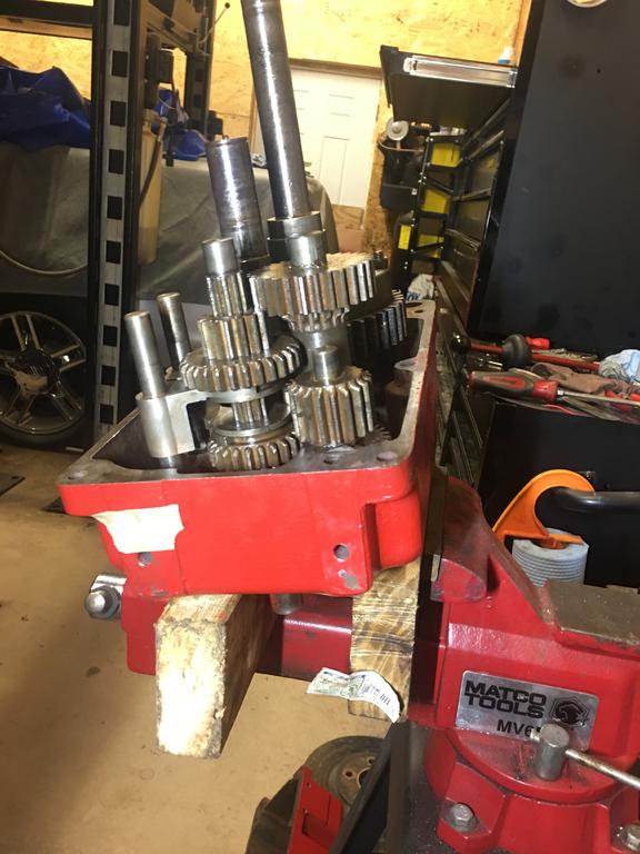

Joeputz 21 #1 Posted August 12, 2019 Hey guys been awhile since I posted but Im having some transmission problems. I completely rebuilt my transmission for my 551 but when its all assembled I can not move the shifter into any gear. When I have the case half off I can shift it into all gears but as soon as the case half is placed on its stuck.. been fighting with this for awhile was wondering if anyone might know what I'm doing wrong. I can kinda shift the gears with the case together with a screw driver but I have to force it and then its stuck in that gear. Hope some one can help. Thank you, Joe Share this post Link to post Share on other sites

953 nut 68,789 #3 Posted August 12, 2019 1 hour ago, Joeputz said: I can not move the shifter into any gear. Looks a bit dry! Each part should have a few drops of oil on it as it goes back together. Share this post Link to post Share on other sites

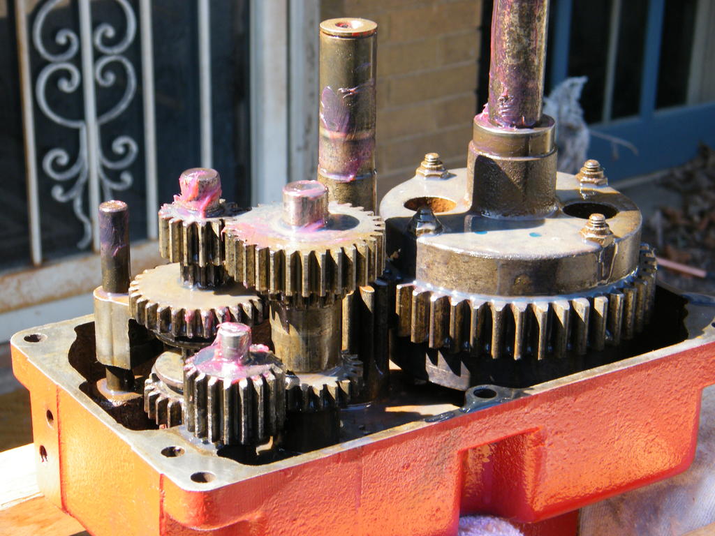

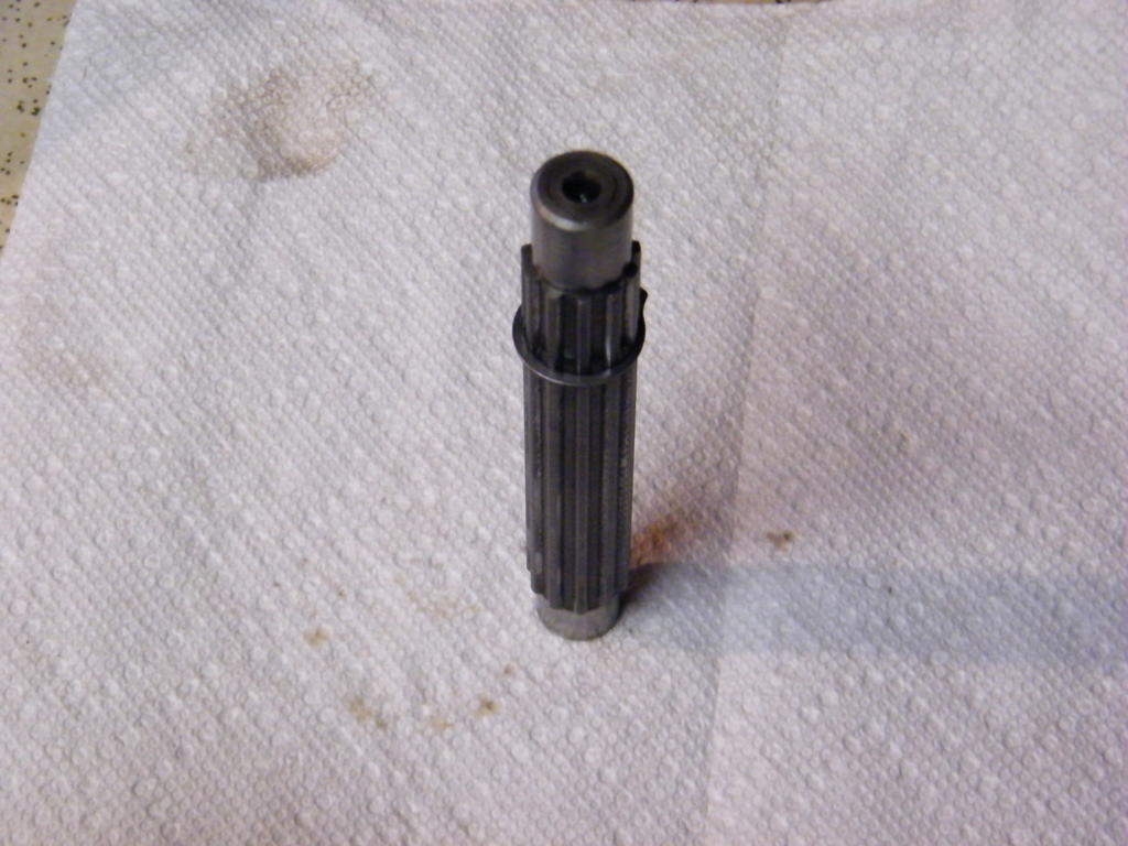

stevasaurus 23,816 #4 Posted August 12, 2019 Your problem is that the pinion gear (that is on top of the fork gears) is under the "C" clamp. That pinion should be at an even height with the reduction gear (the large gear on the cluster gear shaft) and on top of the "C" clamp. The "C" clamp fits in the groove in the splined shaft. Below, you can see the "C" clip on the splined shaft...that pinion sits on top of the clip,,,not under it. 3 Share this post Link to post Share on other sites
