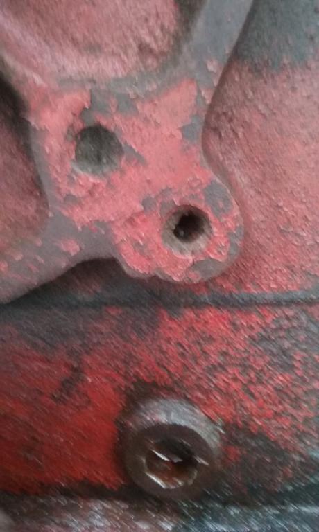

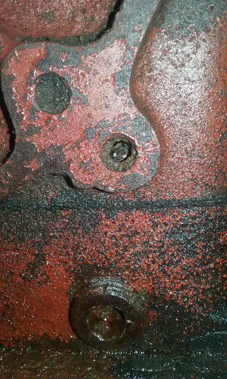

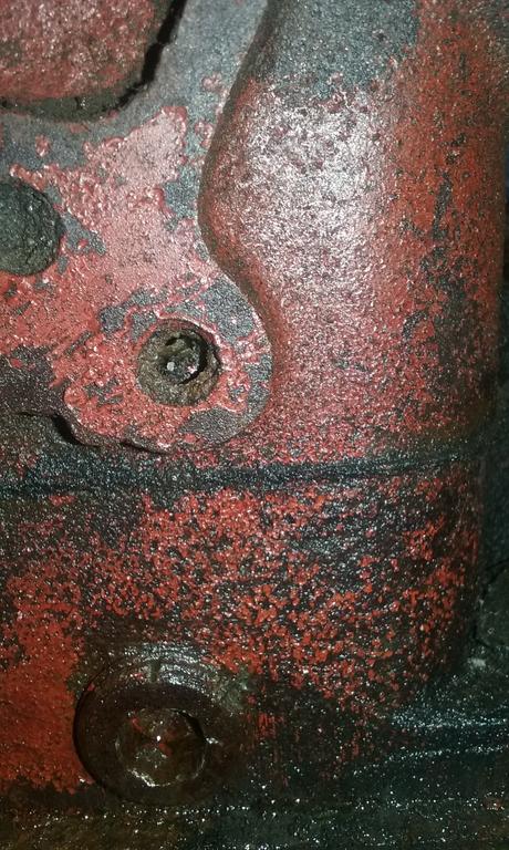

RickyMayhew 37 #14 Posted August 12, 2019 This is the oil drain Share this post Link to post Share on other sites
RickyMayhew 37 #15 Posted August 12, 2019 I believe its stripped someone trued to take it off with a punch looks like. Share this post Link to post Share on other sites
WHNJ701 4,173 #16 Posted August 12, 2019 just use a vise grip to get it out and get s new replacement plug 1 Share this post Link to post Share on other sites
lynnmor 8,915 #17 Posted August 12, 2019 If the vice grip doesn't work, you can make a tool from an allen wrench one size larger, just grind it so that the tip tapers down to the original size. Cut off the other leg and then use it like a punch, hammering it in the knackered hole, then turn out the plug with it. Share this post Link to post Share on other sites

peter lena 9,951 #22 Posted August 13, 2019 now that i know what you are trying to do, get a 6" PIPE WRENCH ,solidly secure the tightening ring, maybe with channel lock pliers so that the bite or grip on the plug is solid, NO BOUNCE OR MOVEMENT, now use a 3 lb hammer to drive against the back of the wrench. making the wrench bite and the solid drive against it , will make that plug move. when you get it out , go to the hardware store and get the same size plug, with EXTERNAL DRIVE, so you don,t repeat the problem , pete Share this post Link to post Share on other sites
WHX?? 57,470 #23 Posted August 13, 2019 Or if you get the plug out re-pipe with nipples and a cap as Steve suggested. Another suggestion might be to drill the plug through and use standard easy outs. Might get a little messy but?? Sorry about the transmission confusion Ricky I just naturally thought that as you should be checking that too on this girl. I have never seen a engine with a hex drain plug like you or Mike has had. 1 Share this post Link to post Share on other sites
