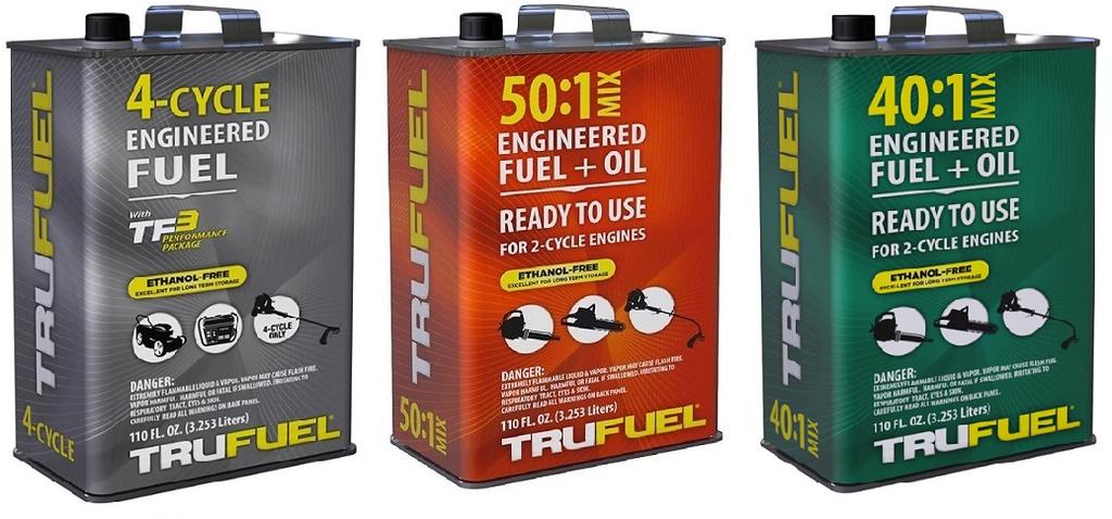

870express 116 #1 Posted August 11, 2019 What's in this stuff? It doesn't smell like gasoline, more like benzene or toluene. Google search only says "it's proprietary". Hmmm . . . At any rate, my chainsaws and weedeater like it. No more gummed-up carburetors. Share this post Link to post Share on other sites
ebinmaine 81,002 #2 Posted August 11, 2019 I don't know what's in it but it's WWAAYY too expensive to be a good value... (Unless you have no other access to ethanol free gas in your area.) $25 - $40 per gallon or more!!! I get e-0 91 octane for $3.69 plus about $1 for the 2-cycle mix. I have great running engines with a long service interval. Share this post Link to post Share on other sites
bc.gold 3,406 #3 Posted August 11, 2019 (edited) Trufuel blends are cited in the US Patent, https://patents.google.com/patent/US20160108329 ] The invention is a highly selective formulation of gasoline components to maximize the start-up capability (low vapor pressure) in cold and hot weather, and provide clean-running performance of the engine (using purified components often not found in auto gasoline) to increase the power, safety, stability and shelf life of the fuel. Edited August 11, 2019 by bcgold Share this post Link to post Share on other sites

870express 116 #12 Posted August 11, 2019 3 hours ago, bcgold said: Trufuel blends are cited in the US Patent, https://patents.google.com/patent/US20160108329 EXAMPLE 1: 4-Stroke Isooctane 58% Alkylate 25% Isopentane 15% Butane 2% Total 100% EXAMPLE 2: 2-Stroke Isooctane 56% Alkylate 25% Isopentane 15% Butane 2% Lub Oil 2% (50:1) Total 100% 1 Share this post Link to post Share on other sites
