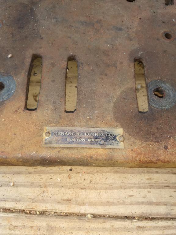

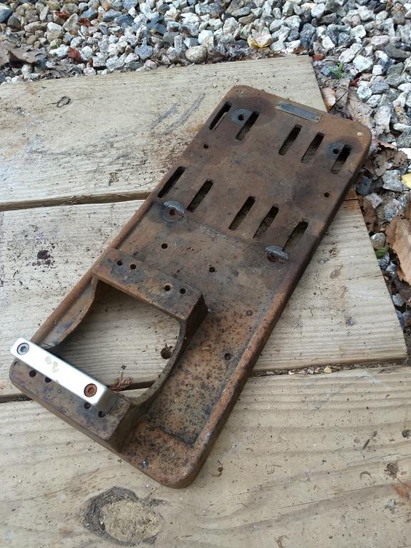

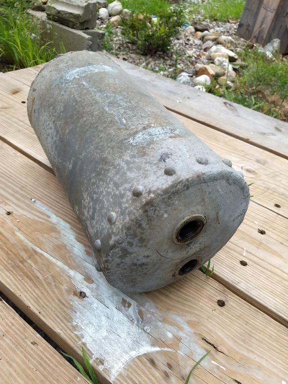

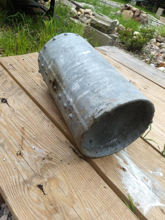

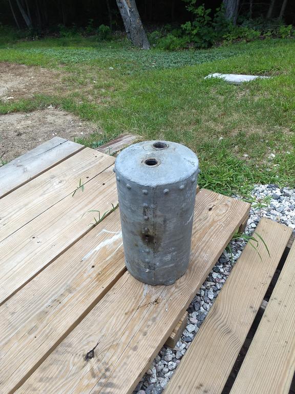

ebinmaine 78,408 #1 Posted August 10, 2019 I picked up a free compressor off of CL two or three years ago. I knew it didn't work when I got it. I was hoping that it was physically larger than it turned out to be. I forgot to take a picture of it while it was still assembled but basically the tank was pinched in 2 yoke assemblies. On top of that was the base in the picture. On top of all of that was a small 2 head compressor. The compressor is nearly seized up so that just went in the scrap pile. I have no idea what to do with the base but it is pretty cool so I'll throw it on a shelf for future useage. The base plate is probably around 8 by 16 inches. The tank measures about 9" across and is a total of 17 or 18 long. Accounting for the recess at one end I figure the volume to be about 3.25 gallons, give or take. Both the tank and the base plate are magnetic. The tank appears to be galvanized? 1 1 Share this post Link to post Share on other sites
oliver2-44 11,410 #2 Posted August 10, 2019 is the tank galvanized? 1 Share this post Link to post Share on other sites
The Tuul Crib 7,354 #3 Posted August 10, 2019 The plate looks like it might be cast iron. Thats a cool name plate! 1 Share this post Link to post Share on other sites
ebinmaine 78,408 #4 Posted August 10, 2019 24 minutes ago, oliver2-44 said: is the tank galvanized? I assume so, judging by the color tone. Is there a way to test that theory? Share this post Link to post Share on other sites

The Tuul Crib 7,354 #6 Posted August 10, 2019 Check for rough surface and some pitting. It looks like it was forged. Share this post Link to post Share on other sites

gwest_ca-(File Mod) 12,168 #8 Posted August 10, 2019 Gerard Compressor Company, a third-generation family-owned business, was established in 1903 and has been a distributor of air compressor products since 1915. In fact, we are the oldest master distributor of COMPAIR products. Located in Woburn, MA, we provide repair and installation service throughout the Northeast. http://gerardaircompressors.com/ Garry 1 1 Share this post Link to post Share on other sites

JAinVA 4,638 #10 Posted August 10, 2019 Eric, That's cool looking.Definitely galvanized! 1 Share this post Link to post Share on other sites

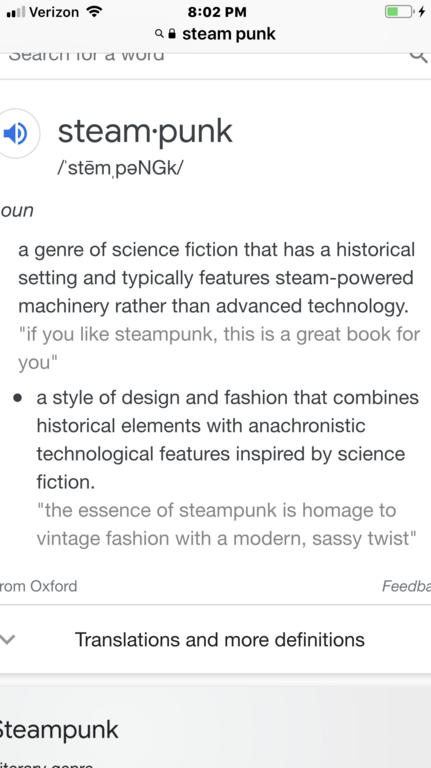

The Tuul Crib 7,354 #11 Posted August 11, 2019 26 minutes ago, JAinVA said: Tool Crib, Are you asking about the term steam punk or why someone might think it looks steam punk? Im not familiar with that . I feel stupid but what is steam punk? 1 Share this post Link to post Share on other sites
JAinVA 4,638 #12 Posted August 11, 2019 Best thing to do is a Google search.It will do a better job of explaining than I could ever do. 3 Share this post Link to post Share on other sites

oliver2-44 11,410 #15 Posted August 11, 2019 So enlarging the picture it looks like the seams of that tank were welded and riveted. I’ve worked with late 1930/early 1940ish vintage equipment that had riveted seams and the drawings called for “caulk welding” the seams. Remember, electric welding was in its infancy before WWII. So with the tank galvanized I’m going to speculate it was for water. Possible some type of air over water injection system where a charge of water was needed at a higher pressure than the rest of the system. 1 Share this post Link to post Share on other sites
ebinmaine 78,408 #16 Posted August 11, 2019 10 minutes ago, oliver2-44 said: So with the tank galvanized I’m going to speculate it was for water. That makes sense knowing that the inside has a good thick coating of rust as well. So here's what I'm thinking of using it for... Ya know that large rear wheel C series I've been thinking on... 20+ inch tires front. 27"+ tires rear. 8 speed. Maybe a 23hp Kohler twin. I was postulating mounting this tank to the upper front of the tractor sort of in honor of some of the farm tractors. I'd put a slide out pin in where the lower hinge would be and just lift the hood straight up when I needed to remove it. That'd be a bit Steampunk... Wouldn't it.... 1 Share this post Link to post Share on other sites

ebinmaine 78,408 #21 Posted August 11, 2019 20 hours ago, oliver2-44 said: So enlarging the picture it looks like the seams of that tank were welded and riveted. I’ve worked with late 1930/early 1940ish vintage equipment that had riveted seams and the drawings called for “caulk welding” the seams. Remember, electric welding was in its infancy before WWII. So with the tank galvanized I’m going to speculate it was for water. Possible some type of air over water injection system where a charge of water was needed at a higher pressure than the rest of the system. Interesting development. I was just out there fiddling around with it. There's. You know. Stuff. Inside of it. I thought it was rust. But it turns out it's a whole bunch of ...??? ...balls of some kind of asphalt substance. Share this post Link to post Share on other sites
oliver2-44 11,410 #22 Posted August 11, 2019 Is it bossiness old rubber verses asphalt? The tank could have had a rubber bladder between the air and water. Share this post Link to post Share on other sites
ebinmaine 78,408 #23 Posted August 11, 2019 17 minutes ago, oliver2-44 said: Is it bossiness old rubber verses asphalt? The tank could have had a rubber bladder between the air and water. I don't think so. The balls are almost as if they are mixed with sand. They crumble for the most part when you squeeze them. They vary in size from an 1/8" or so up to about 3/4". Mostly around 1/4". Share this post Link to post Share on other sites
