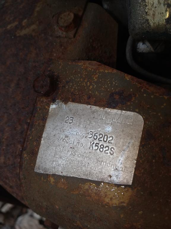

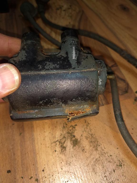

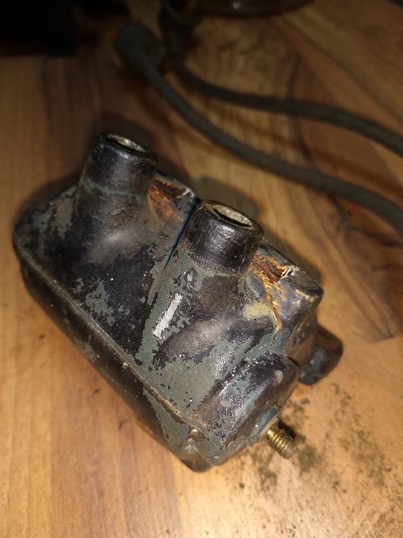

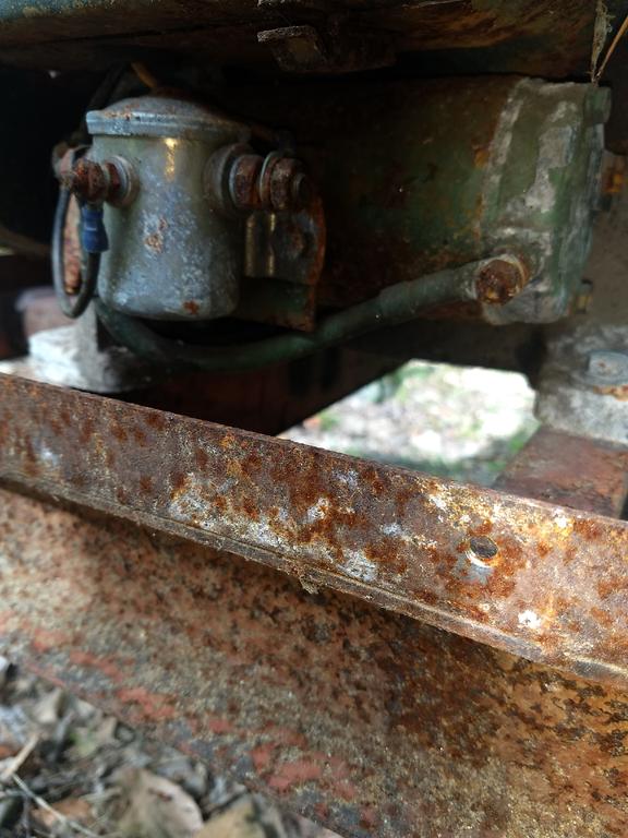

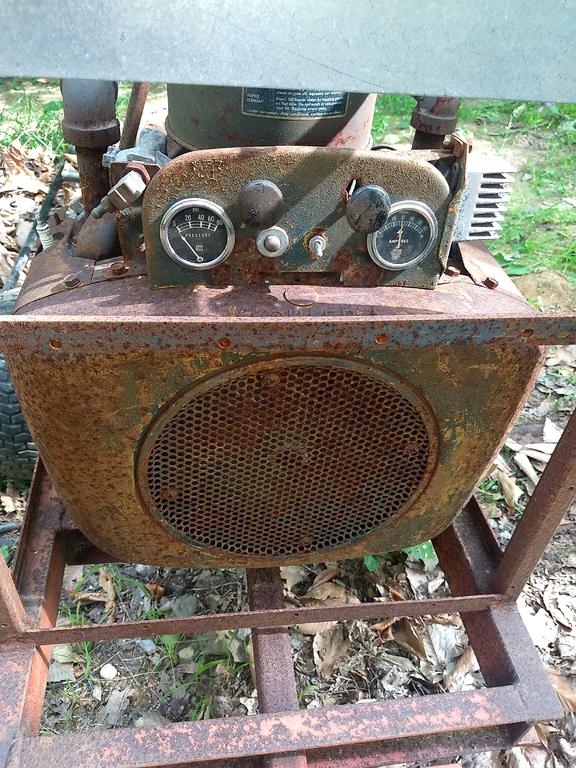

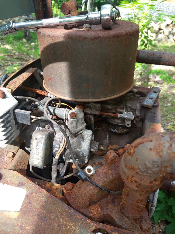

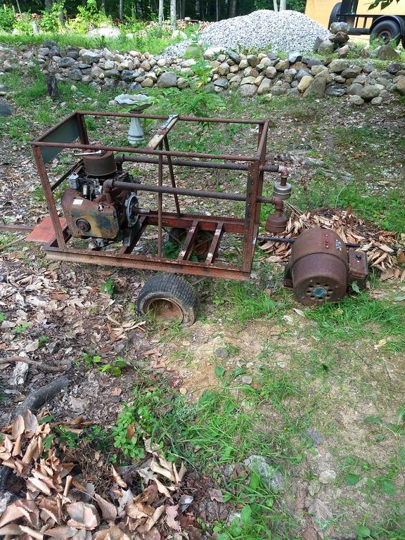

ebinmaine 79,575 #1 Posted August 10, 2019 (edited) This is the engine that sits in the homemade generator trailer that I got from the auction almost a year ago. Over the last month I've been soaking bolts with penetrating oil and today I finally got the generator portion out of the trailer. It started to rain before I got a chance to make a schematic wiring diagram but it looks pretty simple. Self contained. Panel on the front is the control and off/on. I'll get that schematic done at some point. One question I do have. Considering there is no positive and negative side on these coils, where does the condenser connect? It was on the lead that goes to the points cover. The other lead goes to the on-off switch. No one has any idea how old is thing is but the widow of the man whose items were being auctioned off was unfamiliar with it and it was buried in the back of a shed full of scrap metal. She seemed to think it had not been touched for at least 20 years, or more. I'm not at all interested in the generator. I really only bought it for the trailer to use for us in our logging. If the motor runs... HUGE BONUS. I do know that I need to connect battery positive to the solenoid and battery negative to a decent ground. The oil in it although aged, looks fantastic. I'm going to remove the fuel inlet system and clean it out a little. Other than that, what should I be looking for? Here's a few pics. Here's a couple shots of the coil that was on it. I bought a cheap flea Bay Harley replacement. Edited August 17, 2019 by ebinmaine 1 1 Share this post Link to post Share on other sites
gwest_ca-(File Mod) 12,336 #2 Posted August 10, 2019 Service manual and operator manual https://www.wheelhorseforum.com/search/?&q="k582"&type=downloads_file&search_and_or=or&sortby=relevancy Garry 1 1 Share this post Link to post Share on other sites
Pullstart 70,525 #3 Posted August 10, 2019 Eric, I would believe the condenser would be on the points side, as that’s normally the ground. Best of luck, I have a very similar generator with a monster Kohler on it sitting for a rainy day shop project... it was run on LP gas though! 1 1 Share this post Link to post Share on other sites
ebinmaine 79,575 #4 Posted August 11, 2019 2 hours ago, pullstart said: condenser would be on the points side, as that’s normally the ground That makes me feel better. That's where it was. I dunno why but I was thinking it should have been the opposite. 1 Share this post Link to post Share on other sites
gwest_ca-(File Mod) 12,336 #5 Posted August 11, 2019 The WH tractors using the Onan P-Series engines with electronic ignition have a condenser on the positive side. Likely there to suppress voltage spikes. Garry 1 Share this post Link to post Share on other sites

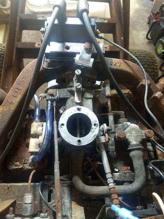

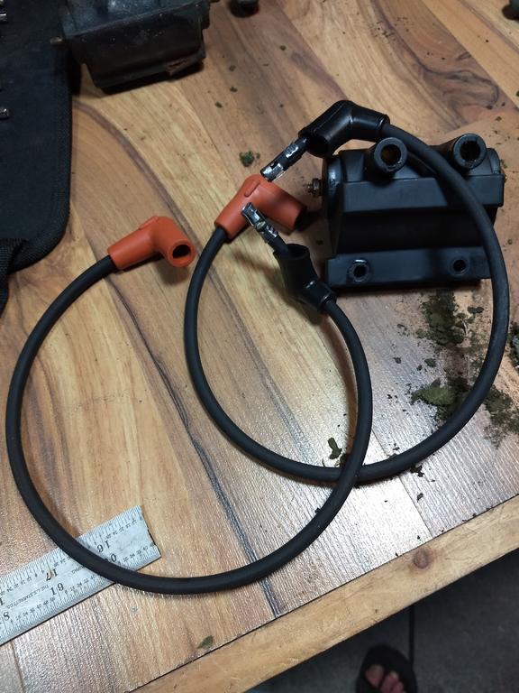

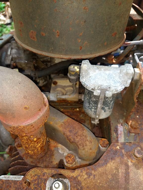

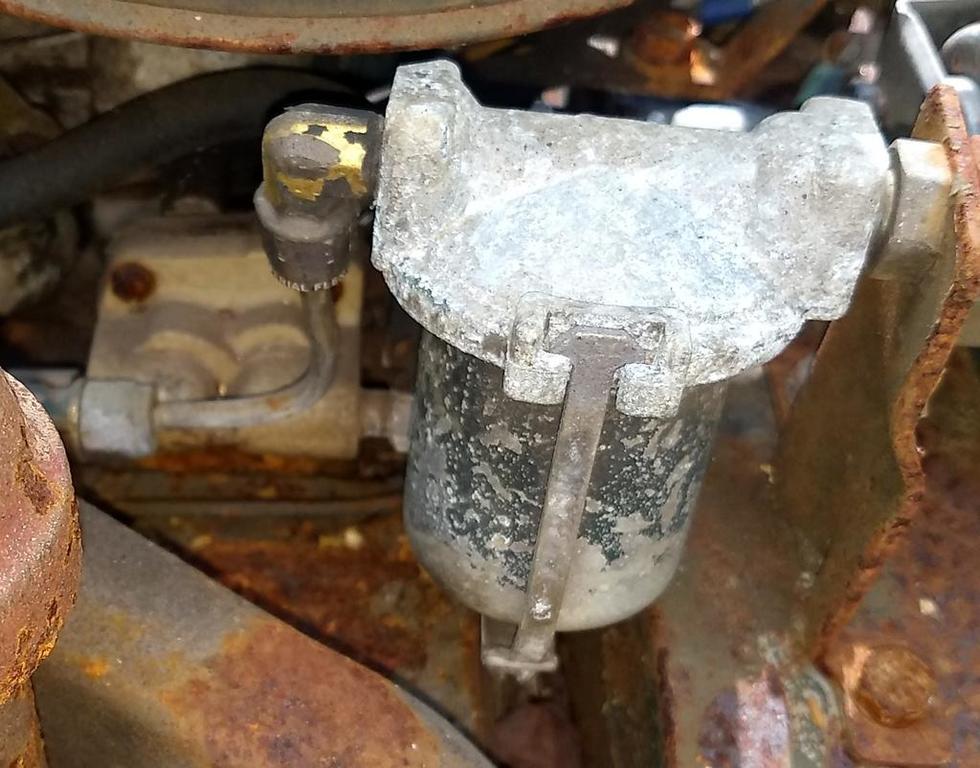

ebinmaine 79,575 #6 Posted August 11, 2019 Spent a few more minutes working on the monster today. There was a mud dauber wasp nest in the end of the fuel inlet. I decided to take that off and cleaned it out. Then I got looking at the fuel filter setup.... The underside of the baseplate had some uhh.... Stuff in it... I took it off as well and am VERY glad I did so. There was another mud nest inside that as well. I also figured out that the spring holding the fuel filter in place is missing. Hence, there would have been NO fuel filtration. I removed that entire assembly. I'll replace it with a new plastic filter. I also made up a couple of new plug wires for it. 7 Share this post Link to post Share on other sites

ebinmaine 79,575 #17 Posted August 18, 2019 I don't know if it shows in any of the pictures but the tire on the right hand side that is close to that concrete block had about 500 cracks in it. I swapped another wheel & tire on to that so I could roll the trailer around. I had Trina give me a hand and we rolled the whole assembly into the workshop shed after I cleared space in there a little. Took a couple pictures for documentation and removed the carburetor. You can see that in another thread. :-). Ouch. 1 1 Share this post Link to post Share on other sites
