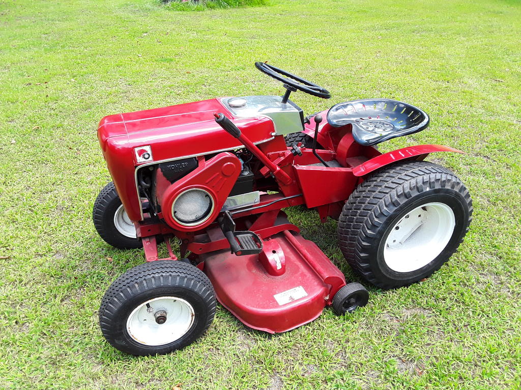

Picked this up today. It was advertised as a 633, but I knew going in that some things weren't correct or had been changed along the way.  The price was right for me, so what might it be? Or used to be? Thanks folks.

The engine is a K181 8hp, that would make it an 833 :handgestures-thumbupright:. Also about a month ago you were out buying a wedding ring, I count at least three tractors bought after that. I'm just saying tread lightly my friend :angry-tappingfoot:

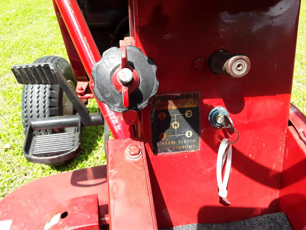

Is the spec number on the engine #30108D  ??

30108D

My guess would be a 854 with a 61/62 style fuel tank and a 62 steering wheel. Or maybe a 753 with different tank, engine and definitely different belt guard decal.

I was kinda leaning toward that too, gas tank throwing me off though
mhlmeader
I'm starting to think it's a mutt, and that's ok, too

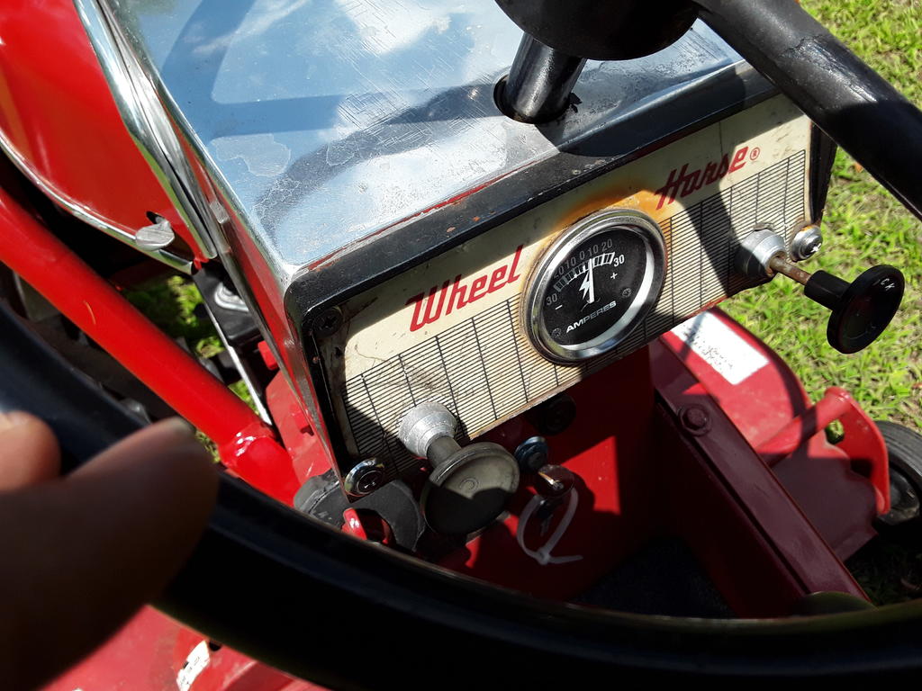

the serial number tag is on the side????
which looks original.  all the 854 I have seen have the sticker under the key centered

26108 looks like an 1963 serial number.

1963 753 with a 702 fuel tank on it

What makes you think it's anything other than a 633? Just because the engine changed?  The 633 came with the goofy updraft carb, which over time became a leaky mess. The original owner/dealer may have just opted to upgrade to a new 8HP engine rather than mess with the old 6HP.
I'd say you have a 633.

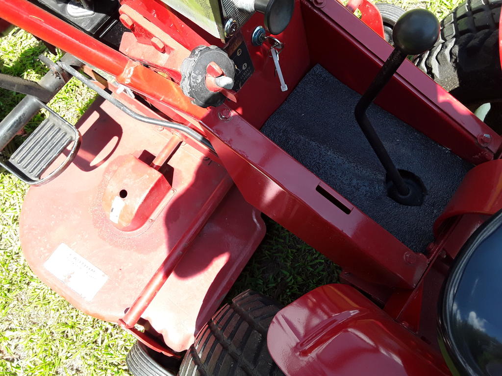

Previous owner put some custom touches
Gotta like the carpeted tunnel & custom chrome edging Buff :handgestures-thumbupright:
