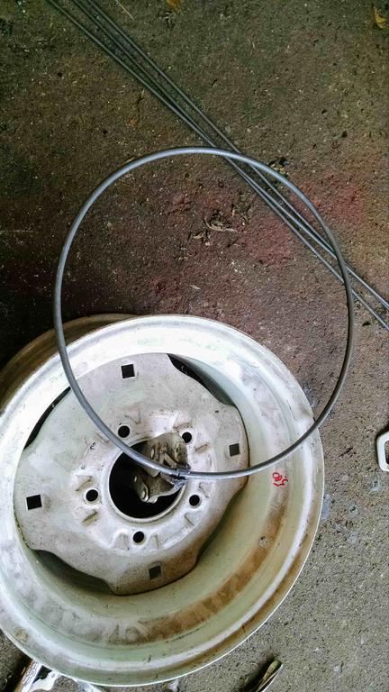

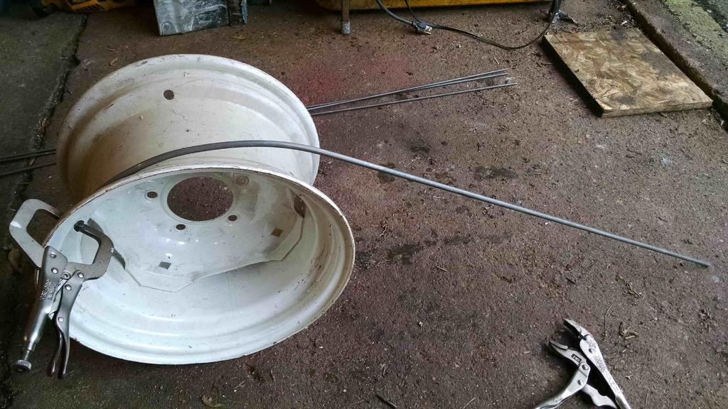

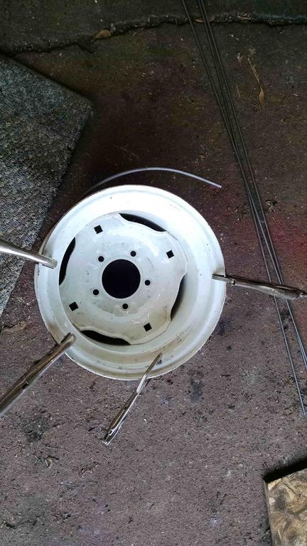

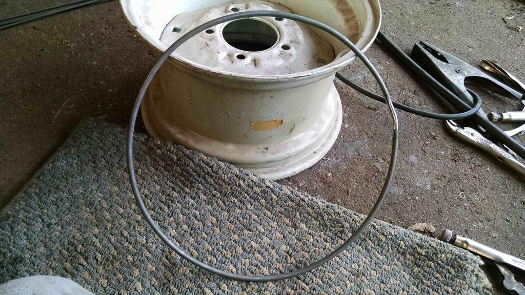

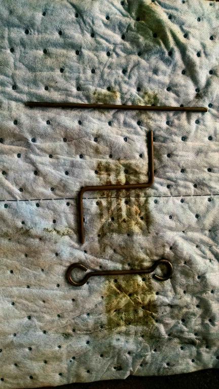

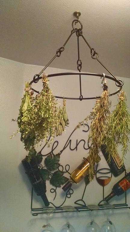

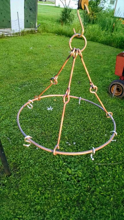

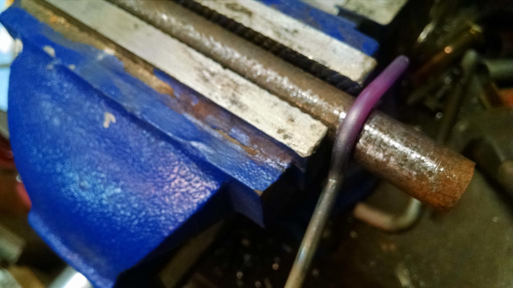

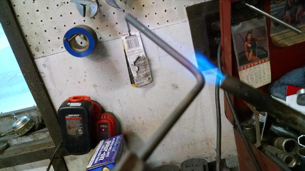

Achto 32,432 #1 Posted August 7, 2019 (edited) The wife wanted a herb garden this year and now it's time to start harvesting and drying some of her herbs. This gave me a chance to do a little smithing. First a loop, this was done cold. Then welded together. Then I bent up some links. Raw finished product. Finish was done by heating the metal red hot & then rubbing it with bee's wax. Then add some S hooks for holding the bundles of herbs while they dry. Edited August 7, 2019 by Achto 12 13 2 2 Share this post Link to post Share on other sites

tunahead72 2,658 #7 Posted August 7, 2019 Very cool project! Nice calendar too! 1 2 Share this post Link to post Share on other sites

roadapples 6,987 #9 Posted August 7, 2019 Nice job and like the finish. Will that prevent rust? 1 Share this post Link to post Share on other sites
Achto 32,432 #10 Posted August 7, 2019 6 hours ago, roadapples said: Nice job and like the finish. Will that prevent rust? The bee's wax rubbed on hot metal is some thing that I learned from guys that do black smith work at some of the local tractor shows. The wax will close the pores in the metal to help prevent rust. Surprisingly the finish is quite durable and does not leave a residue on your hands after it has cooled. 3 1 1 1 Share this post Link to post Share on other sites
