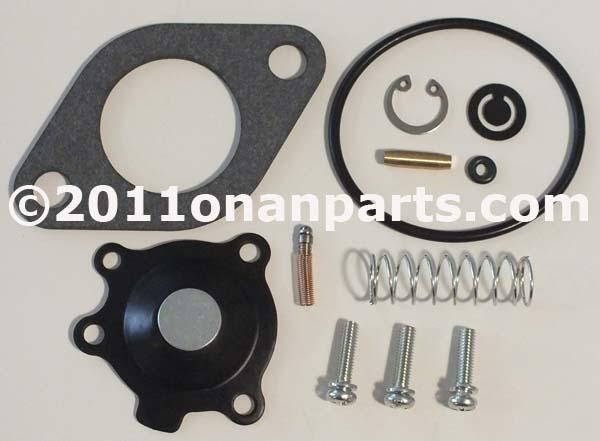

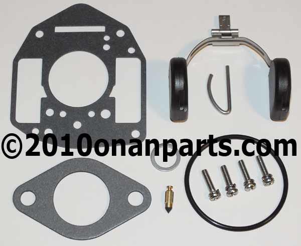

onanparts.com 185 #9 Posted April 25, 2020 On 7/23/2019 at 4:47 PM, lynnmor said: I think you might have a newer than 1995 spec G carb and that is a check valve for the accelerator pump. Check your number plate and also verify if it has an accelerator pump. Those carbs are to be replaced rather than rebuilt, so be careful with gaskets. If you do have the spec G, I would toss it for an older model. Since this thread was updated I'm going to correct some misinformation. The later style carbs are NOT to be replaced rather than rebuilt if that option is desired. Kits with gaskets are readily available for them. It's not necessary to be careful with the gaskets. The 146-0657 repair kit fits both the accelerator pump style carbs and many of the early style carbs that came before. 146-0658 is the kit for the accelerator pump. The early style carbs are the better choice, but replacing a newer style carb that can be put back in service with a good cleaning and using repair kits for a minimal cost, is not the best economical approach. An early style used carb is still going to require the same cleaning and 146-0657 kit in most if not all cases. Pictured are the two repair kits. Share this post Link to post Share on other sites
