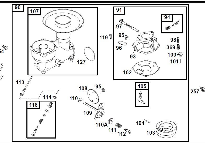

pfrederi 21,300 #6 Posted July 22, 2019 Running hot and lacking power would indicate too lean a mixture. the original carb on your engine had a high speed mixture needle (#118) if the new one does have you tried enriching it. Share this post Link to post Share on other sites
