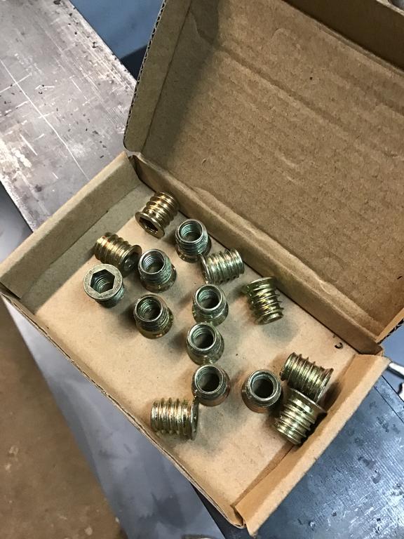

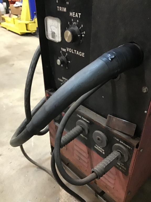

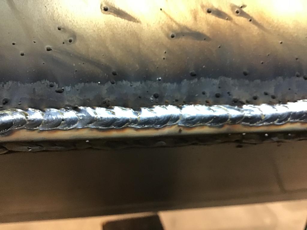

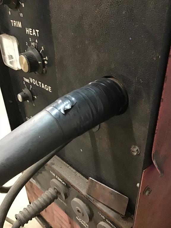

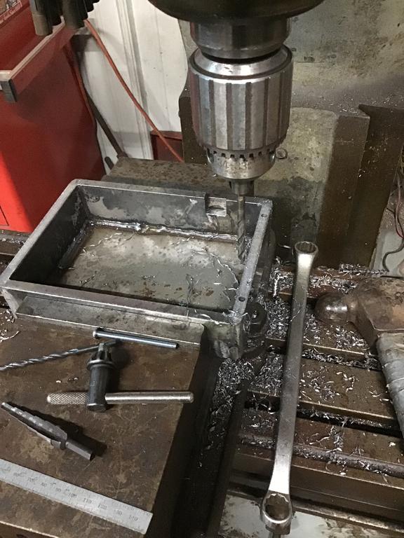

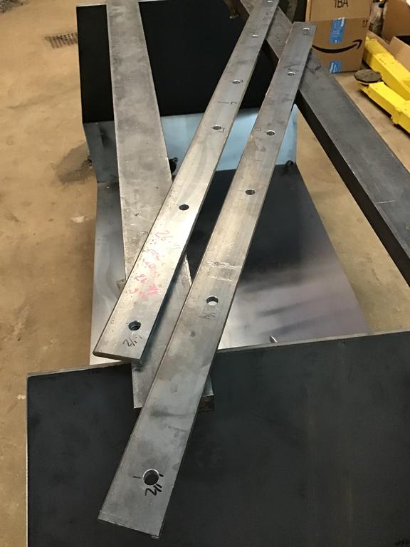

Pullstart 70,969 #76 Posted July 30, 2019 Well, yesterday I spent some time repairing Grampa’s farm truck frame. The welder was still showing signs of pops, bubbles and junk in the bead. I ended up figuring out that the gas was leaking out of this boot on the gun cord! I had no idea that it just flows around the sleeve and it had been electric tape repaired in the past. A few more wraps of tape for the time being and we’re welding clean beads again! The top anchor pieces are drilled and I have these wood inserts to put into the top too. 4 Share this post Link to post Share on other sites

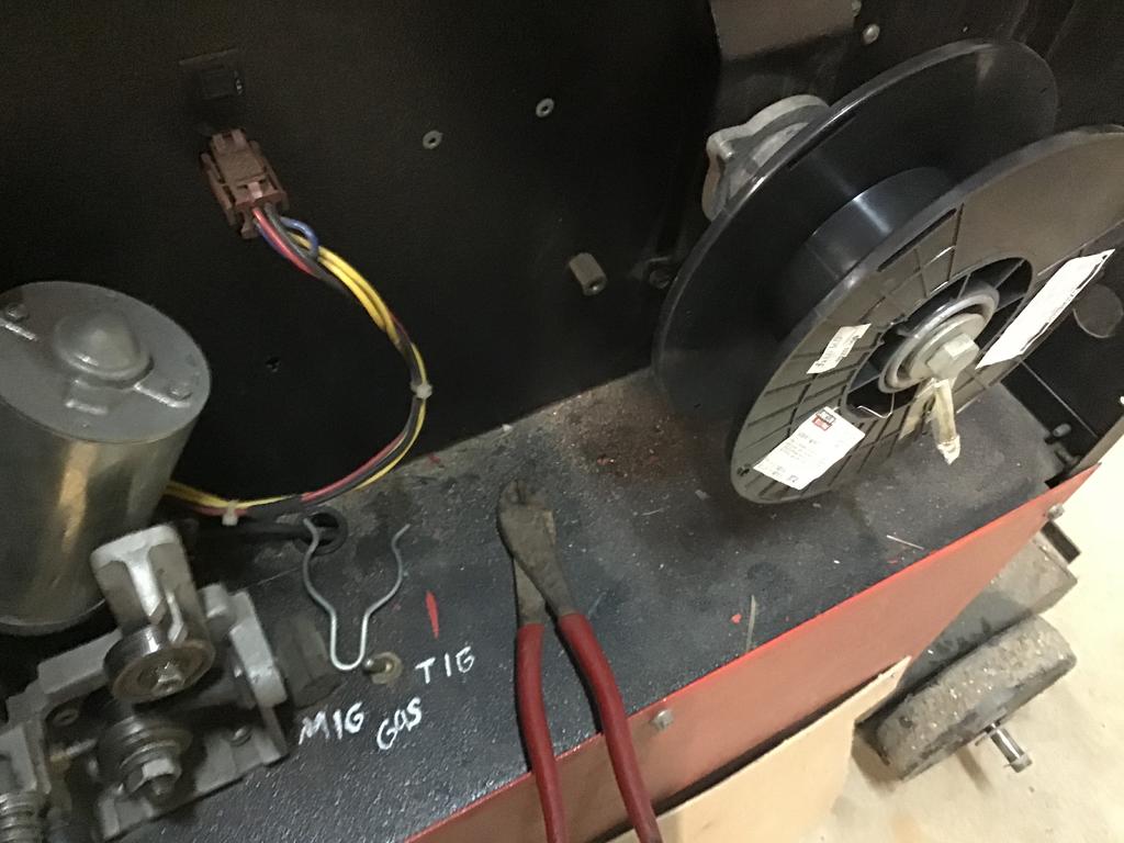

Pullstart 70,969 #77 Posted July 30, 2019 It’s all fun and games until the spool runs out of wire... 2 1 3 Share this post Link to post Share on other sites

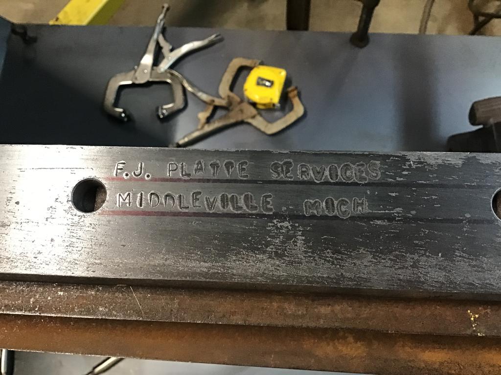

Pullstart 70,969 #79 Posted July 30, 2019 Signing the work, my company name. 2 1 Share this post Link to post Share on other sites

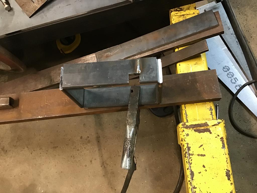

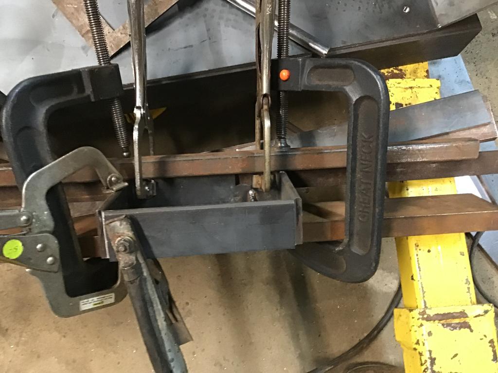

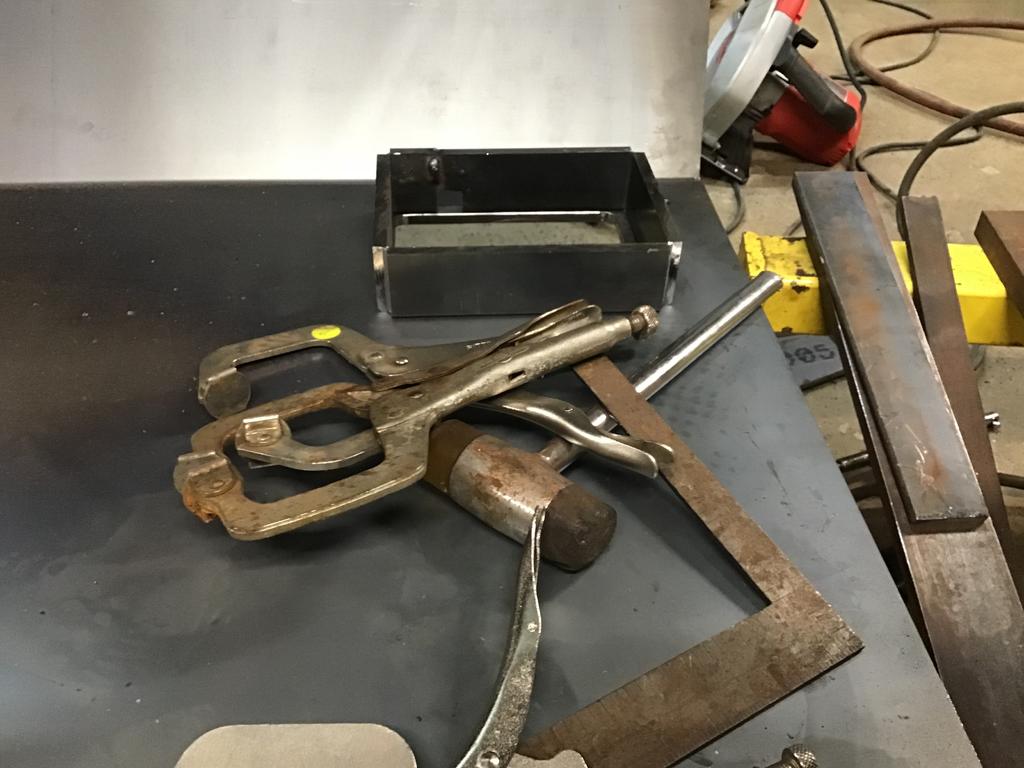

Pullstart 70,969 #80 Posted July 31, 2019 I am building the box for electrical access today. There will be a channel of angle iron to hide the wires too. 3 1 Share this post Link to post Share on other sites

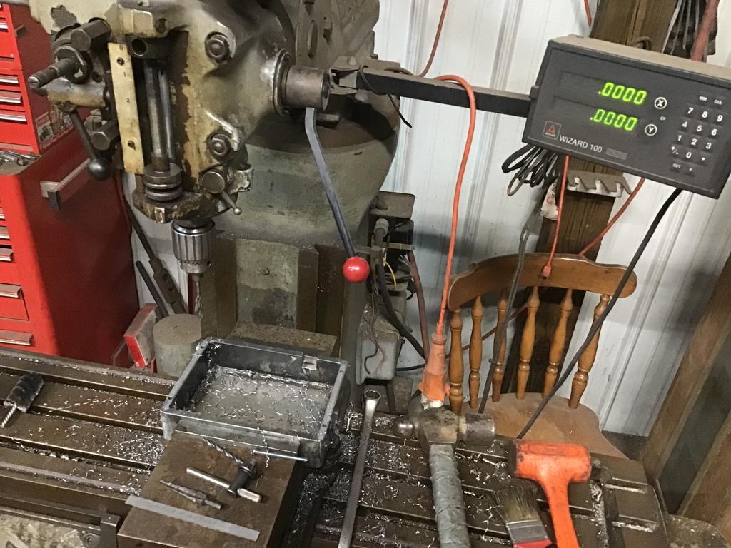

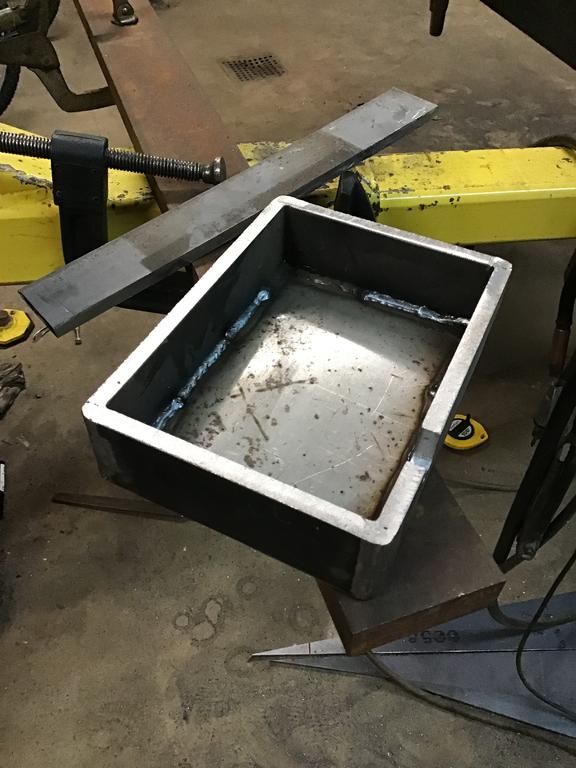

Pullstart 70,969 #82 Posted August 1, 2019 A little bit is complete on the box. I’ll weld up the outside, then grind it all smooth. It’ll bolt onto the plate for the best access to power and communication wires. 2 Share this post Link to post Share on other sites

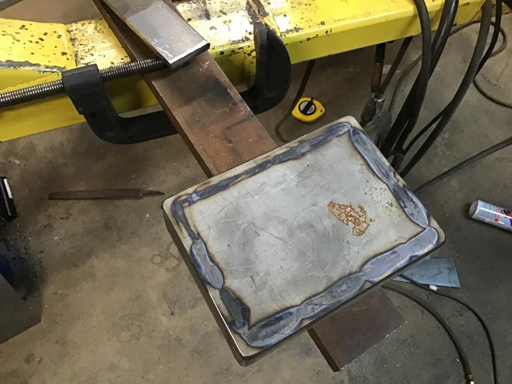

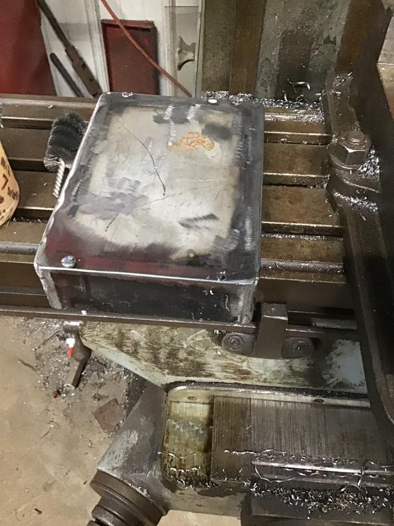

Pullstart 70,969 #87 Posted August 1, 2019 I finished welding and smoothing the cover, then grabbed some 10-32 screws to hold it down. 1 Share this post Link to post Share on other sites

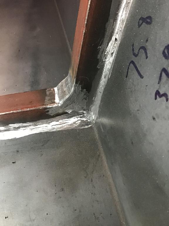

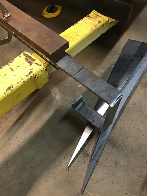

Pullstart 70,969 #89 Posted August 5, 2019 A finishing touch, before finishing touches, like grinding and smoothing. This 7/8” angle iron makes a communications channel from the box to the underside of the table top. 4 1 Share this post Link to post Share on other sites

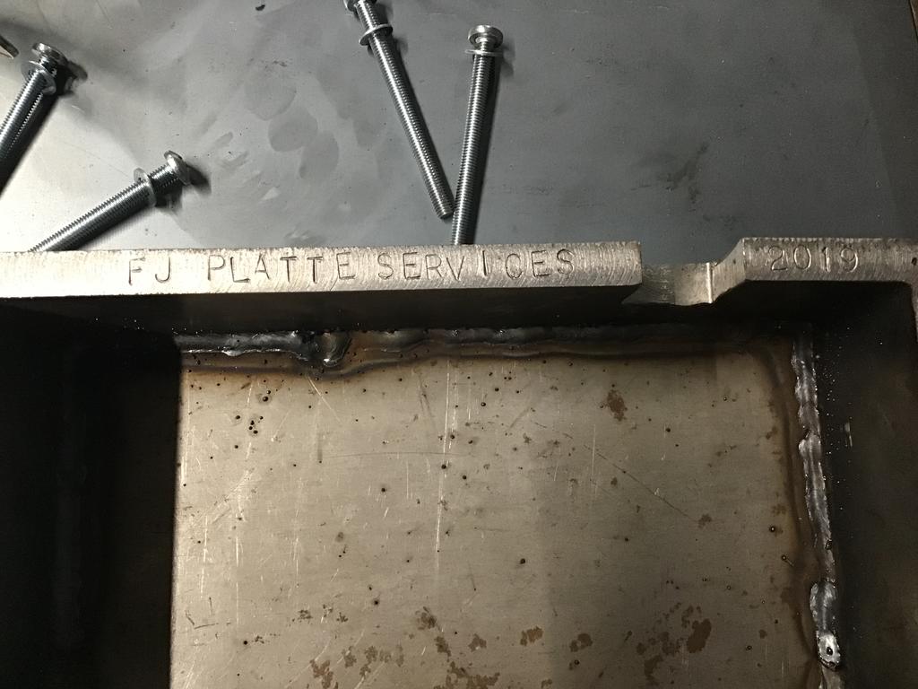

Pullstart 70,969 #90 Posted August 5, 2019 Date stamped! That’s something I forgot on the main piece... someone in 200 years might want to know this stuff 1 1 4 Share this post Link to post Share on other sites

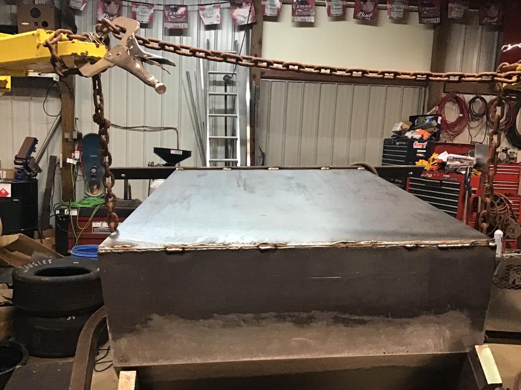

Pullstart 70,969 #91 Posted August 5, 2019 I finished the channel, time to dress the two outside welds and put a final radius on the entire piece. These little threaded eyes sure make moving this thing easy! I’m so excited to see it all come together, soon! 4 1 Share this post Link to post Share on other sites

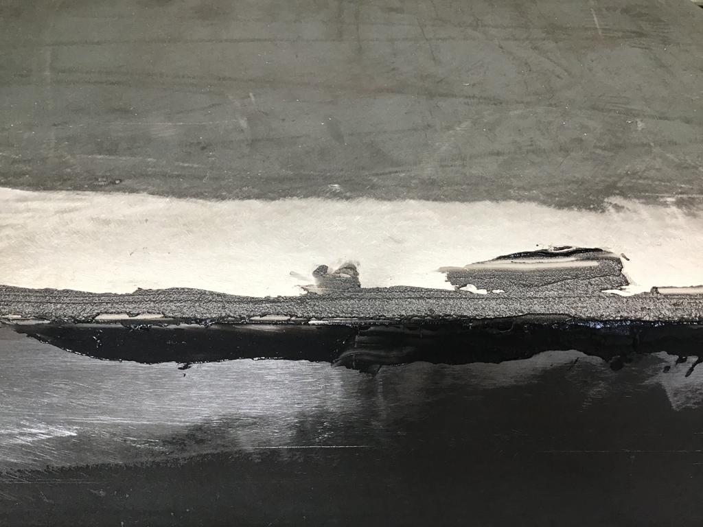

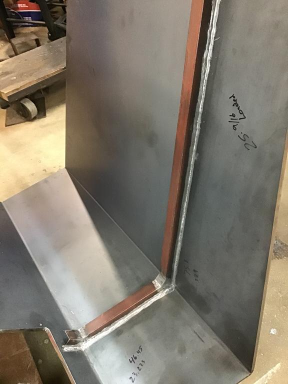

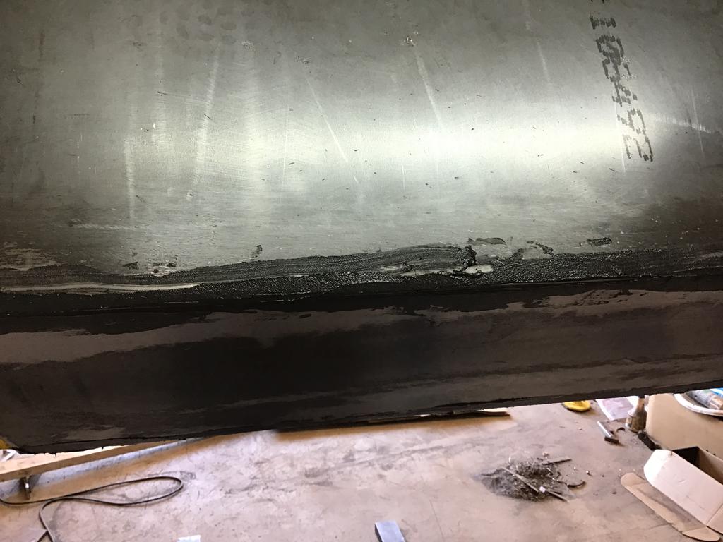

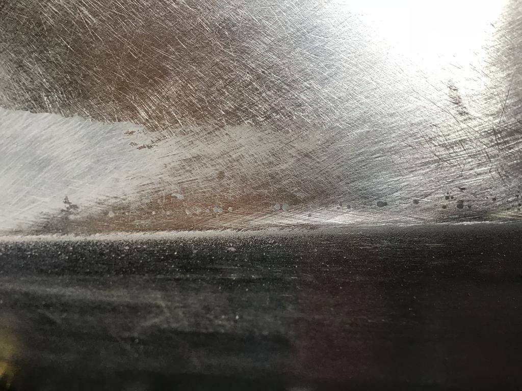

Pullstart 70,969 #92 Posted August 9, 2019 I couldn’t stand the few pits here and there and a few voids from not quite enough fill when I was welding, so I buttered the smooth ground radiuses with PC-7 so it’ll be pretty and smooth after paint. Almost finished! 3 3 1 Share this post Link to post Share on other sites
Sparky-(Admin) 26,142 #93 Posted August 9, 2019 Estimated weight ?? Looks heavy as heck! Share this post Link to post Share on other sites

Tractorhead 9,217 #95 Posted August 9, 2019 (edited) Kevin, what is please PC-7? Didn‘t know that Stuff. As PC- 7 i just know a Pilatus Aircraft. would you please update me? I‘m just curious. It looks like a Sealant, is it permanent elastic? Thanks for Info. Edited August 9, 2019 by Tractorhead Share this post Link to post Share on other sites
AMC RULES 37,259 #96 Posted August 9, 2019 Two part epoxy. 1 1 Share this post Link to post Share on other sites
Pullstart 70,969 #97 Posted August 10, 2019 21 hours ago, Sparky said: Estimated weight ?? Looks heavy as heck! Something around 640 lbs, I believe I calculated. I might have trimmed another 30 off making a few cuts here and there... but it’s heavy alright. 20 hours ago, The Tool Crib said: Im waiting for the wood part! Cant wait to see beautiful piece of walnut! You and I both! We’re close! 20 hours ago, Tractorhead said: Kevin, what is please PC-7? Didn‘t know that Stuff. As PC- 7 i just know a Pilatus Aircraft. would you please update me? I‘m just curious. It looks like a Sealant, is it permanent elastic? Thanks for Info. 18 hours ago, AMC RULES said: Two part epoxy. It’s supposed to be machinable, drillable, threadable, and hard as steel when it’s finished. For this instance, it’s just used as a super hard body filler and a bit over-done. 1 Share this post Link to post Share on other sites

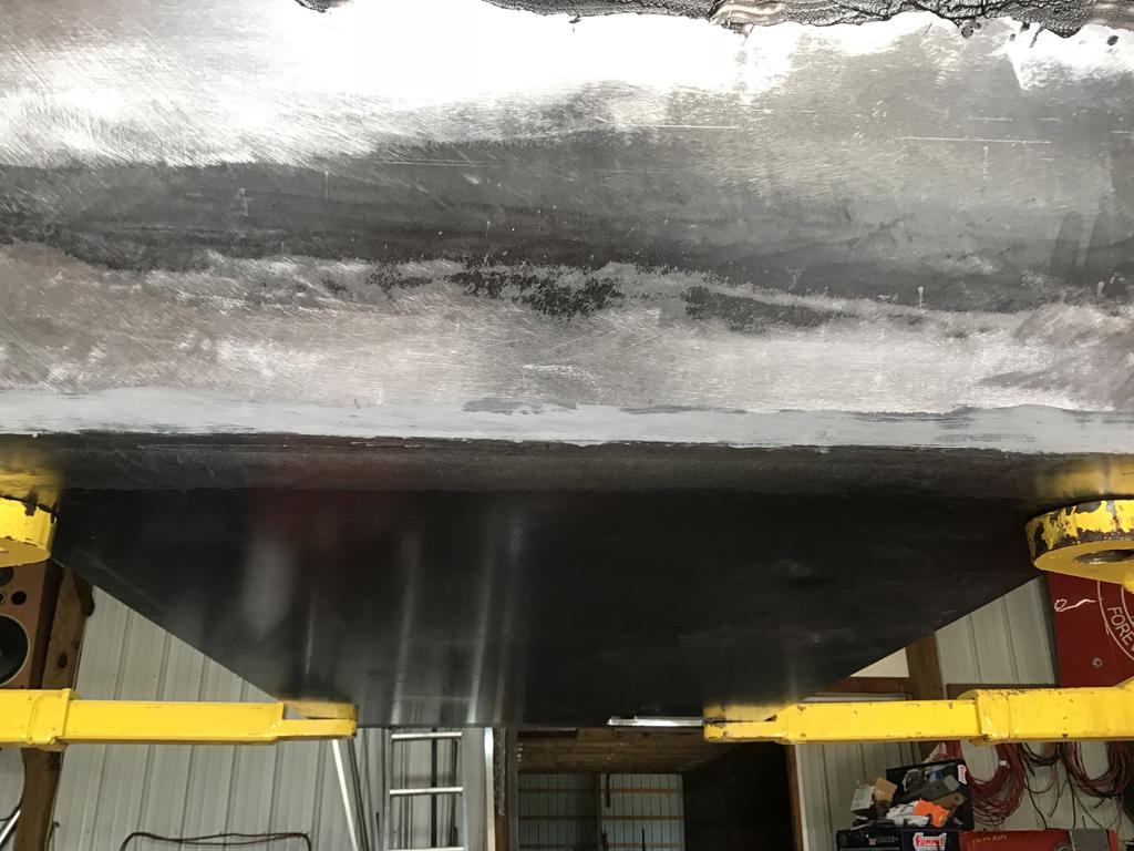

Pullstart 70,969 #100 Posted August 11, 2019 The PC-7 is cured well past it’s recommended 24 hours, it’s time to finish this piece up! As the filler comes off, you can see that the small voids filled well. I’ll be much more satisfied with the final product! 3 1 Share this post Link to post Share on other sites
