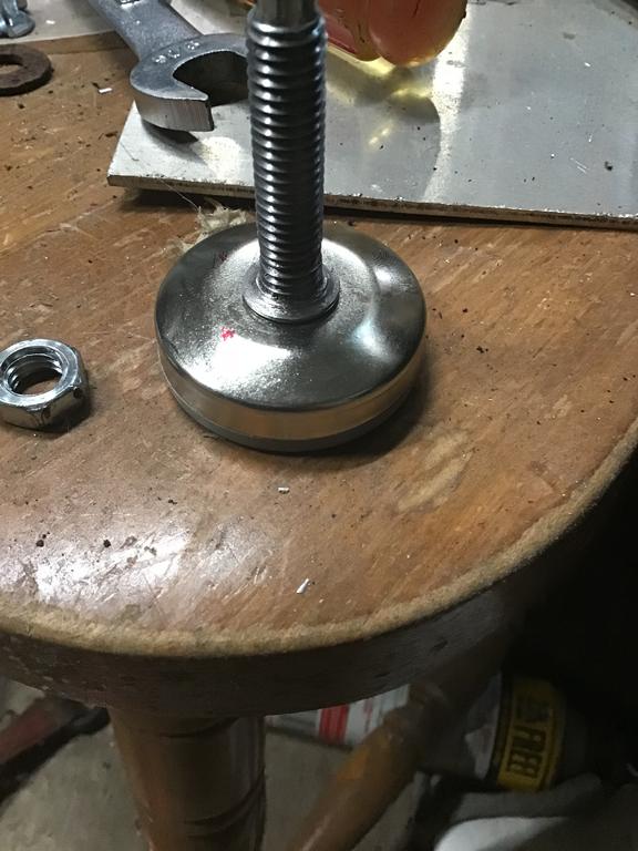

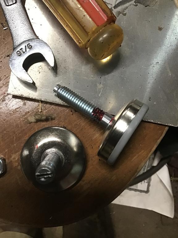

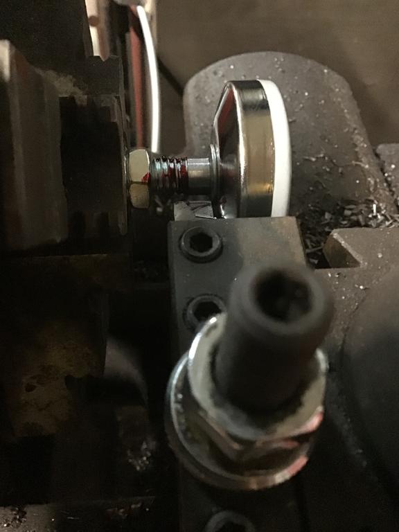

Pullstart 71,567 #38 Posted July 21, 2019 Even though the shop has A/C, it was just too darned hot to accomplish much but keeping a cold drink nearby and splashing in the water this weekend! Now that it’s cooled off a bit, I received the feet for the job but he wants it as low to the floor as possible. I trimmed the bottom adjustment “nut” off the shaft and used a 3/8-16 die to bottom out the threads. 5 Share this post Link to post Share on other sites

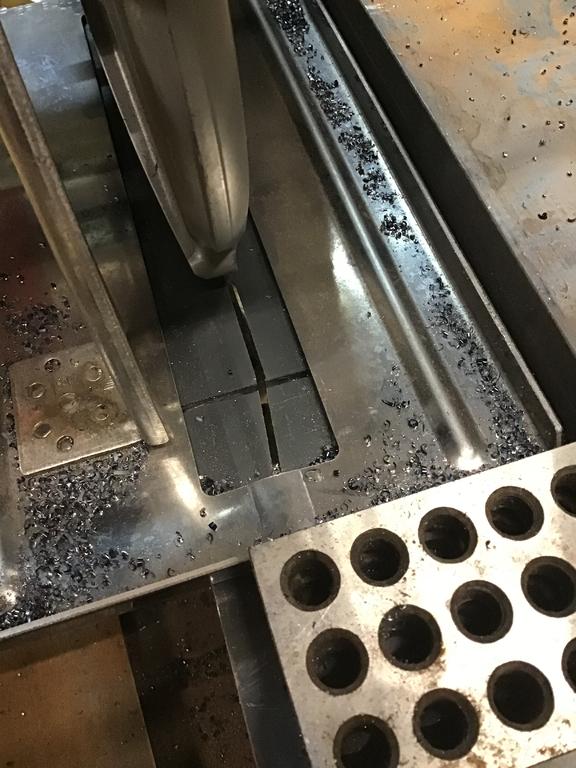

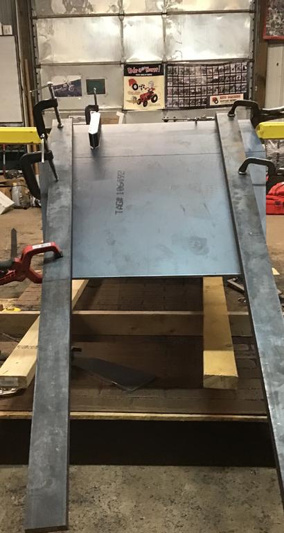

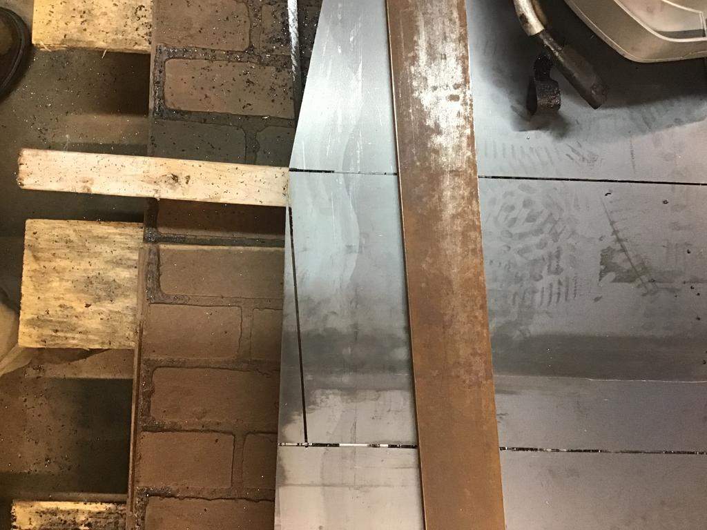

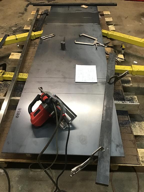

Pullstart 71,567 #39 Posted July 21, 2019 My bend points are all scored, now time to trim the edges to size. Scoring the blank first gives me good reference points for where the edges will come together. Due to the shape of the base, I’ll be forced to do a couple plunge cuts. My plan is to clamp the saw base to the work piece, so I can just focus on the cut and not the alignment of the saw. 4 Share this post Link to post Share on other sites

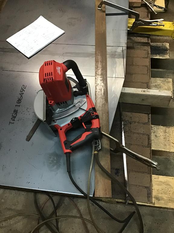

Pullstart 71,567 #40 Posted July 21, 2019 The front of the blade is entirely enclosed, but there’s a “front of blade” line in the saw base. It helps to know where to stop in these instances. 3 Share this post Link to post Share on other sites
Pullstart 71,567 #41 Posted July 21, 2019 My plunge cut worked! I let the saw tell me how fast to lower it and I braced my arms against my knee for more control and accuaracy. 3 1 Share this post Link to post Share on other sites

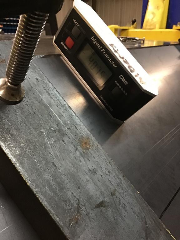

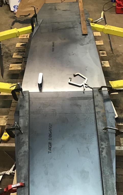

Pullstart 71,567 #42 Posted July 21, 2019 I’m looking for 46.4 degrees to call it bent! 3 Share this post Link to post Share on other sites
Pullstart 71,567 #43 Posted July 21, 2019 Both first bends are done. I need to pick up some threaded rod or drill rod, and fill in the cracks! 4 1 Share this post Link to post Share on other sites

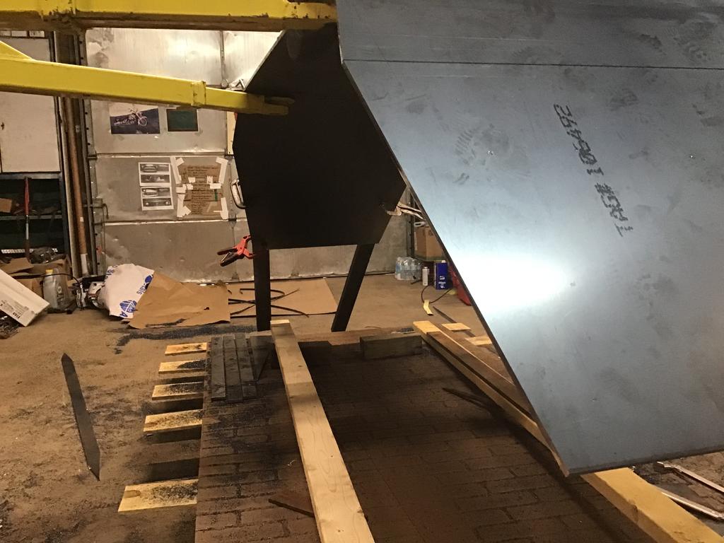

Pullstart 71,567 #50 Posted July 22, 2019 Just to be clear Eric, I’ve never worked with 3/8” plate before, more have I married steel and wood in this manner. A lot of the jobs that come my way are because people ask me if I CAN do something, to which I answer yes. They don’t ask me if I’ve done it before! I gain confidence in small things, like tractors or golf carts. Then when it comes time for say roll cages or tables, I have the experience to understand the steps to take to find that finished product. The next few days of work is going to be fun stuff, seeing it all come together! 5 2 1 Share this post Link to post Share on other sites
