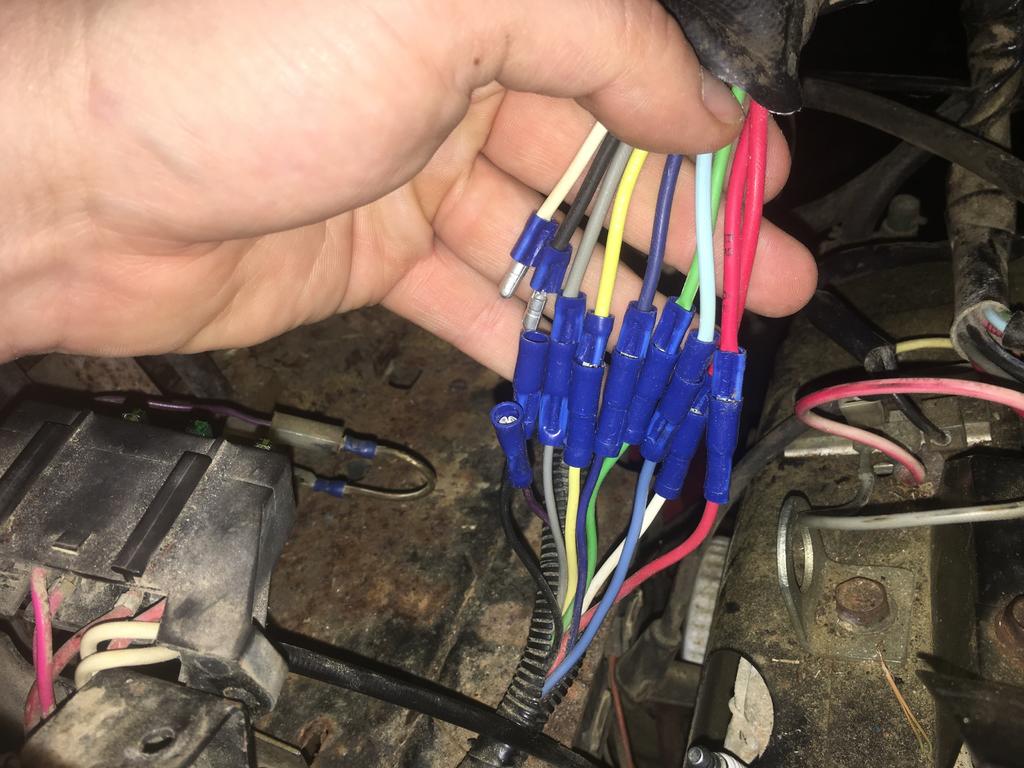

Jrblanke 976 #1 Posted July 12, 2019 (edited) Hey guys, OK, 4 years ago I had a problem with my 520 not starting, so I replaced the 9 pin connector, wired it wrong, got angry, cut it off, and then let it sit in the yard (with a tarp) until yesterday when I figured out that the reason I couldn't tow it was because i had left the parking brake on. I know, I'm terrible, impulsive, and have made stupid decisions. So lets focus on fixing the problem I am using the wire guide on page 2 of the attached 8 page document. I have a couple questions. The engine harness colors are not on the wire diagram, so I was trying to match the colors and use a volt meter to confirm which one the red starter wire is. There are a few wires that I don't know where they go and would like some help figuring out where they go. Here is what I have so far (In order of the wire diagram from top to bottom): Engine Harness to Tractor Harness Grey to Grey Red ? to white Yellow to Yellow Red ? to Red ? to Purple Dark Blue to dark blue ? to black lt green to lt green lt blue to lt blue (starter) I have attached a picture of my wires so far. Edited July 12, 2019 by Jrblanke Share this post Link to post Share on other sites
