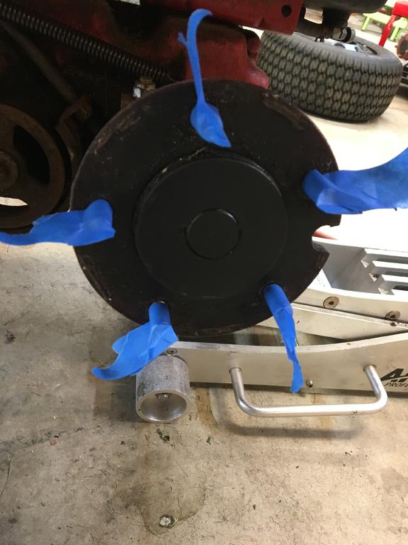

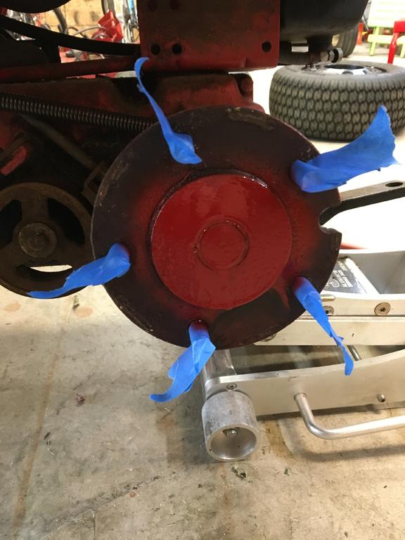

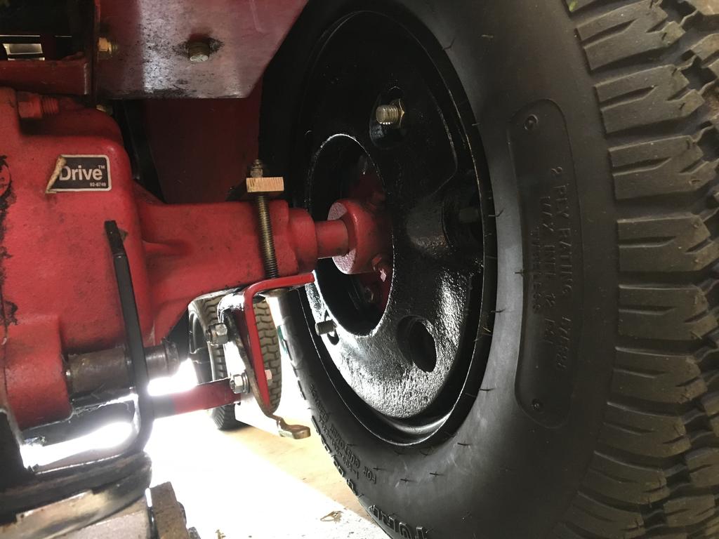

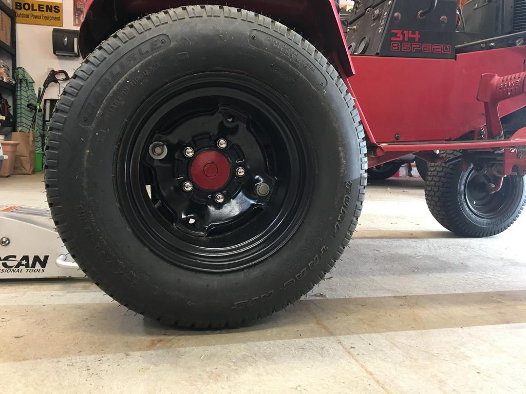

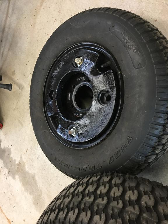

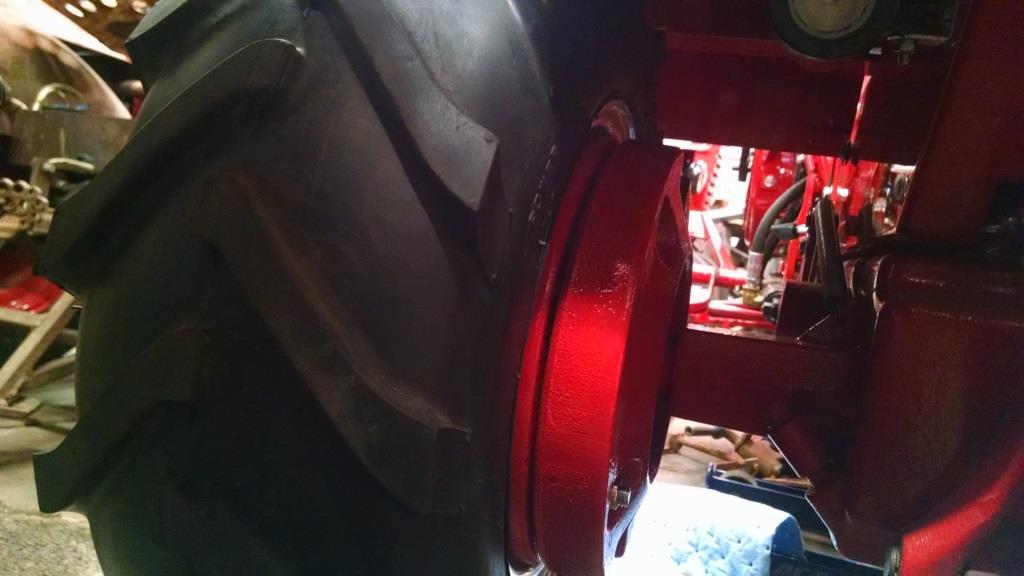

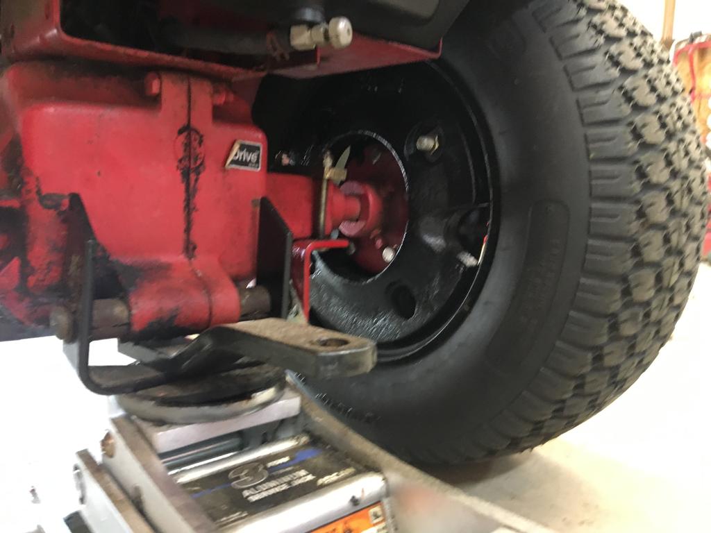

Sparky-(Admin) 26,515 #1 Posted July 8, 2019 This is a 300 series I’m setting up for my son for when he and his fiancé become homeowners next month. Came across a great deal on 4 International Cub weights so 2 of them are going on his tractor. Adds 25# per side, it’ll also get a pair of 50 pounders on the outside of the rim before winter. 4 7 Share this post Link to post Share on other sites

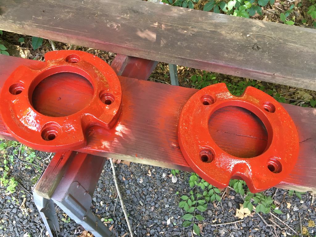

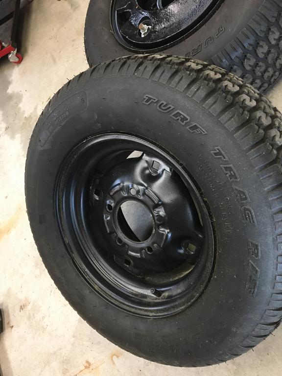

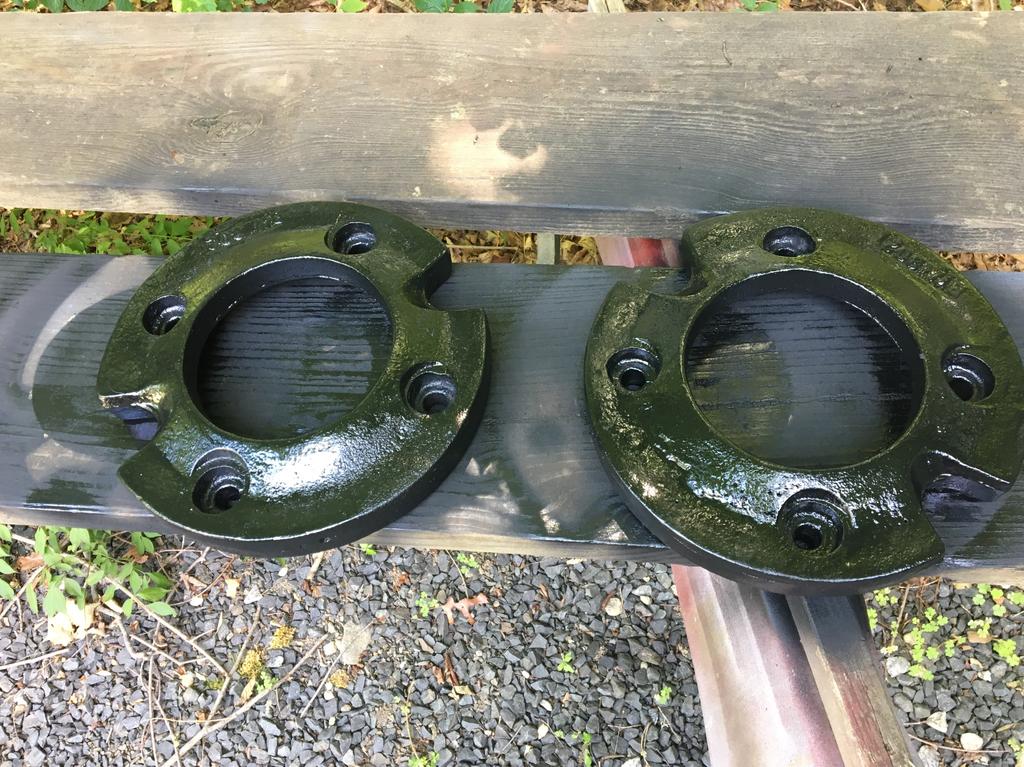

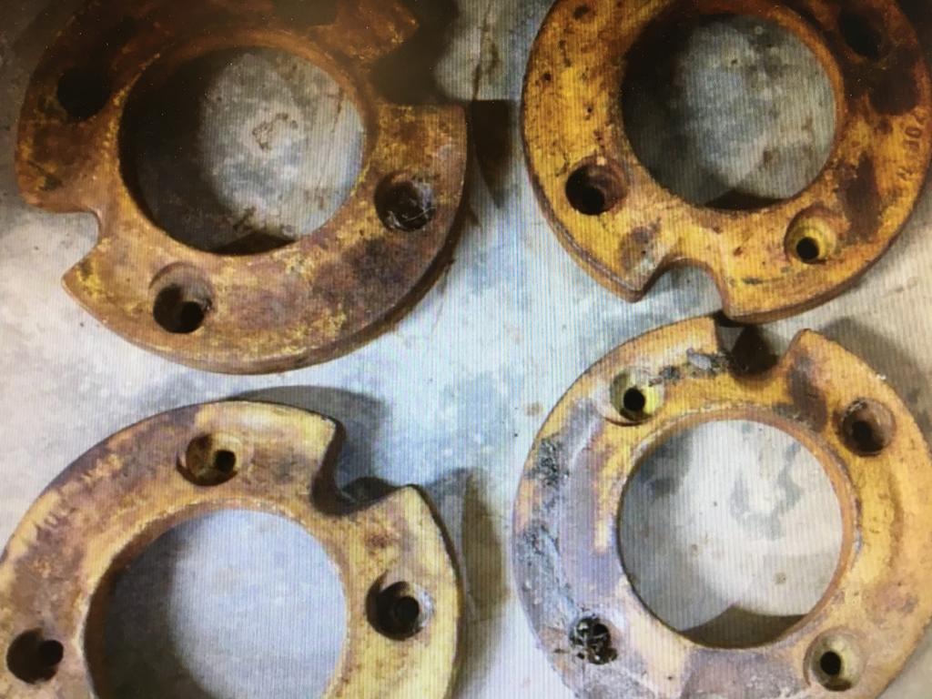

Sparky-(Admin) 26,515 #2 Posted July 8, 2019 This is what I started with...painted the black ones for my sons machine and the red ones to sell. 5 Share this post Link to post Share on other sites
JAinVA 4,638 #3 Posted July 8, 2019 Looks good.I have a pair mounted to my 416h.I never thought about mounting a pair inside.Thanks for the tip. 2 Share this post Link to post Share on other sites

Achto 32,844 #5 Posted July 8, 2019 The IH Cub weights work out very well. I have cast weights on the out side of the rims on my plow tractor and a double stack of the Cub weights on the inside of the land wheel. 4 1 Share this post Link to post Share on other sites
Sparky-(Admin) 26,515 #6 Posted July 8, 2019 1 hour ago, WHX24 said: Dibs! @WHX24 ...these suckers sold the first day I offered them up last week. I wish I had a few dozen sets. They sell easily once people see how versatile (inside or outside mounting) they are. 2 1 Share this post Link to post Share on other sites

Sparky-(Admin) 26,515 #8 Posted July 8, 2019 1 hour ago, 857 horse said: any weights will fit inside i believe,,,,,,,,,,,,,,,, The trick is finding weights with a hole large enough to fit over the hub. 2 1 Share this post Link to post Share on other sites

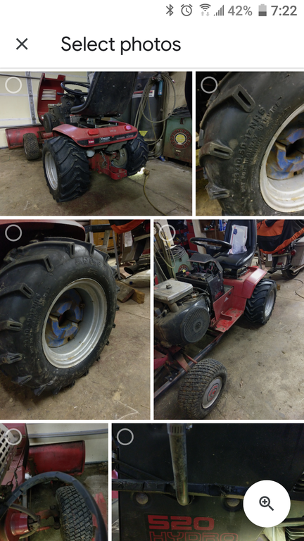

WVHillbilly520H 10,379 #10 Posted July 8, 2019 Cub weights on the inside and Massey Ferguson split weights (hidden behind the wheel covers) outside plus 5-6 gallons of methanol in each tire on my 520H... 5 1 Share this post Link to post Share on other sites

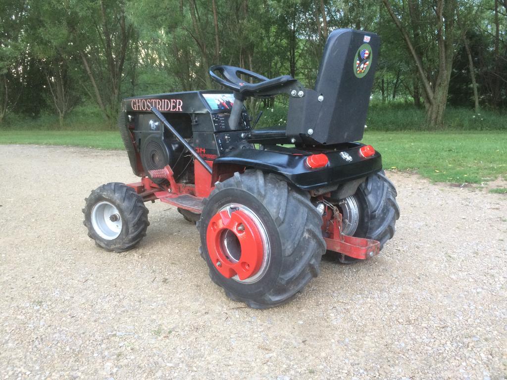

PeacemakerJack 11,072 #11 Posted July 9, 2019 Being a dyed-in-the-wool plow dog, I have played with weights A LOT. The Cub weights are very versatile as mentioned about. They can be used in lots of combinations. They stack very easily on the big 54# WH cast weights like I have on GhostRider... as mentioned above by Dan, they work great inside the wheel and still give the clearance needed. My favorite looking weight is the one commonly found on CASE GT’s... You paint them to match your tractor, use some stainless or chrome mounting hardware and they really look sharp and add about 40# per plate. However, at the end of the day, any weight that you can add when needed is worth it! Well done Sparky on setting up your sons tractor for summer and winter use. That is my desire for each of my children if/when they get their own place. Thanks for sharing! 5 3 1 Share this post Link to post Share on other sites

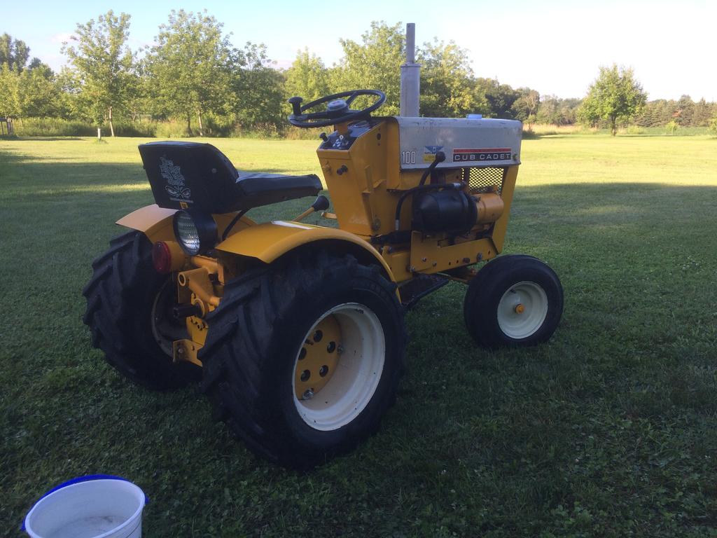

PeacemakerJack 11,072 #13 Posted July 15, 2019 @RandyLittrell I don’t think I’ve ever started a thread about “the Mule”. It is a purpose built Plow Mule that I gave/bought for my son Judge. It is a very fun little tractor with nearly every option available on the 1964 Cub 100. If you like, I’ll start one to tell you about it... Share this post Link to post Share on other sites
