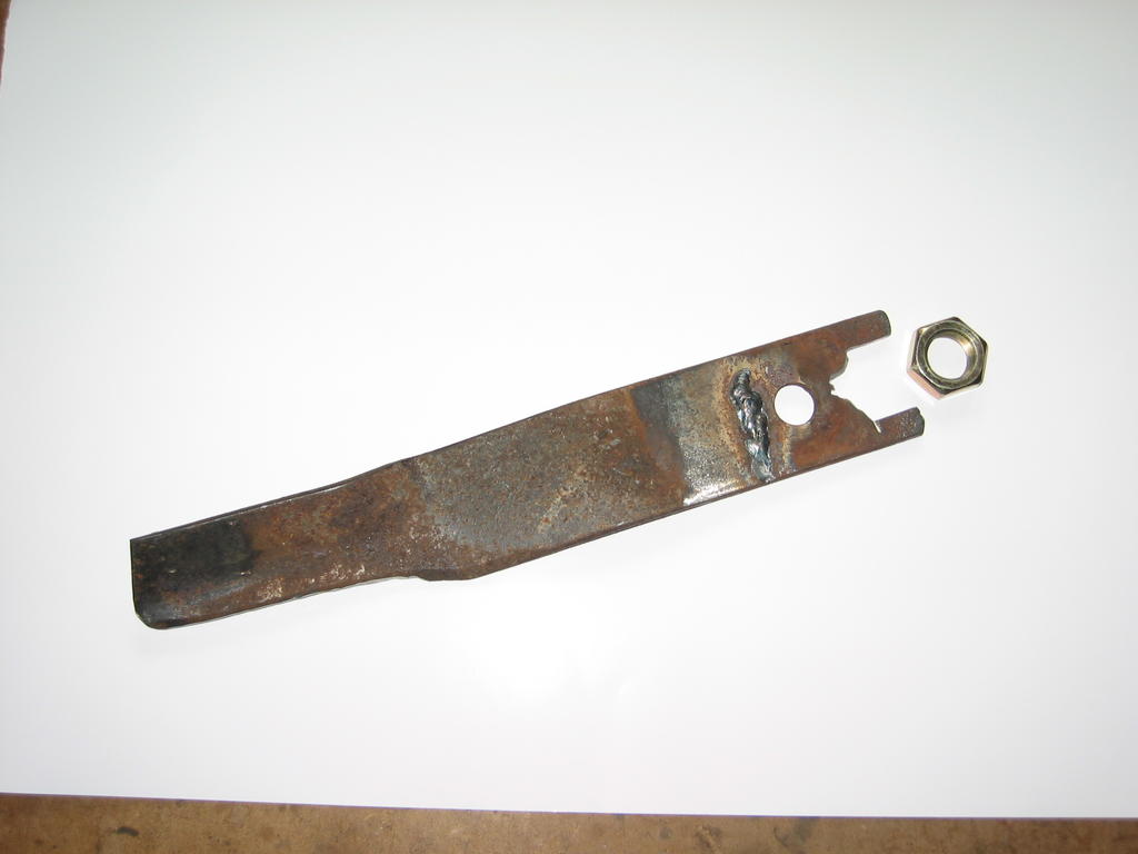

 Wheel horse made a special wrench for the back hold. There is usually some for sale on here in the classified section.
eric j
I bought one of those wrenches and it spread open and became useless.  Best to find a good wrench that fits or grind one down till it fits.
  • Like 2
ericj
I've had the same issues with my wrench. With the impact gun though it will usually help to hold and get the blade off if the gun won't doe it by itself. If you use a regular wrench under the blade it will bend the blade, don't ask me how I now this :hide:  I've been meaning to buy a wrench and grind down but just never got to it
eric j
pfrederi
eric j
Why waste a wrench...Few minutes with a hacksaw and grinder and repurpose a worn out blade.  Tough steel they do not spread.
  • Like 3
ericj
I think I can find an old worn out blade or 2 laying around here :ROTF:  I'll have to give it a try, thanks
eric j
