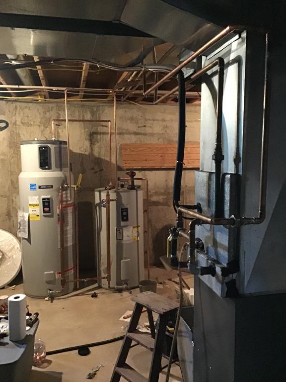

Pullstart 71,467 #26 Posted June 28, 2019 I’m a furnace filter away from firing up the A/C! The return trunk needs to be shortened 4.5” too. 5 1 Share this post Link to post Share on other sites

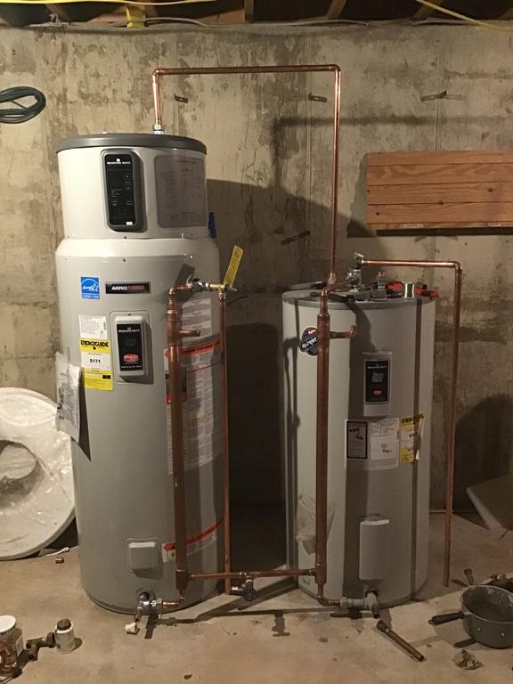

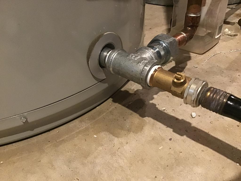

Pullstart 71,467 #27 Posted June 29, 2019 Now that it’s near 70 in the house again instead of 85 and humid, I can work a bit on the new water heater plumbing. I still have the old one hooked up and heating by the wood boiler and I’ll rough in as much as possible with the potable and boiler systems before killing water pressure. The side arm heat exchangers are in progress right now. I had to mix bushings (bottom) and bell reducers (top) on the exchanger because the supply house only had so much of each.... just enough to piece my job together! The 1-1/2” copper tube will slide over the 3/4” tube. I had to drill the fittings out on the lathe to get the small tube to slide through instead of hit the stops. 1 Share this post Link to post Share on other sites

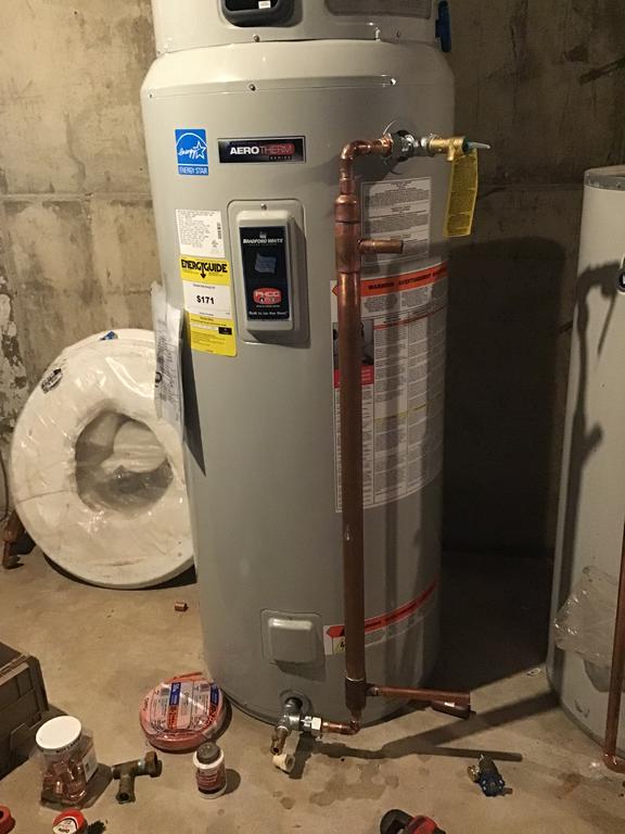

Pullstart 71,467 #35 Posted June 29, 2019 Well I might not be fast.... at much... but I feel like I’m getting somewhere. I spent a few hours changing an alternator on a mini van today and cooling off in the pool, but one side arm is soldered and the other is pre-built. 4 Share this post Link to post Share on other sites

Pullstart 71,467 #37 Posted June 30, 2019 @JCM see anything alarming so far? I’ll put a mixing valve from the cold inlet of tank #1 to the outlet of tank #2. 1 Share this post Link to post Share on other sites

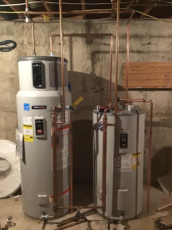

Pullstart 71,467 #38 Posted June 30, 2019 Some more piping success... I have to take one run apart to solder, then I can kill the house plumbing to tie it all together, then leak test! 1 1 Share this post Link to post Share on other sites
Tractorhead 9,218 #39 Posted June 30, 2019 Hey Buddy, keep my Fingers crossing, hope all goes well further and you‘re done quick. 1 Share this post Link to post Share on other sites
Pullstart 71,467 #40 Posted July 1, 2019 Unless I find a leak, the plumbing is complete! I’ll wait for a new day to check for leaks, then wire everything up. I wish I had picked up a few more unions and made room for a couple shut off valves but I’ll cross that bridge if I ever need to change something. As I do more projects in the house, I’ll keep replacing the CPVC with more copper. 2 1 Share this post Link to post Share on other sites

Pullstart 71,467 #48 Posted July 1, 2019 4 minutes ago, BHunter said: You do Nice work Kevin. Looks great. How do you have time to do all this when you’re on RedSquare all the time Well when you are draining 80 gallons of water to re-dope one npt fitting on the bottom.... you find yourself twittling thumbs... or surfing RedSquare! Good news is all the sweat fittings are leak free! By the way, shouldn’t you be building a horse barn right now? 1 Share this post Link to post Share on other sites
