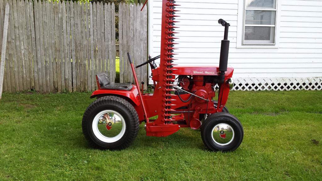

Shynon 7,577 #7 Posted June 28, 2019 I had mine on a short frame 867. Never hooked up a belt or used it. Was displayed 2 Share this post Link to post Share on other sites
Stepney 2,357 #8 Posted June 28, 2019 1 hour ago, Shynon said: I had mine on a short frame 867. Never hooked up a belt or used it. Was displayed Was that a 7-1311 'long frame' model though? Can't quite see the lower bracket on that photo. 1 Share this post Link to post Share on other sites
Shynon 7,577 #9 Posted June 28, 2019 7 hours ago, Stepney said: Was that a 7-1311 'long frame' model though? Yes 1 Share this post Link to post Share on other sites
Stepney 2,357 #10 Posted June 28, 2019 1 hour ago, Shynon said: Yes If you ever did look, how much clearance was there at the rear, do you think it may actually work? From what I could see in photos, it looked like the distance on some of the short frame sickles, at the rear, was different. But I really don't have one to compare. 1 Share this post Link to post Share on other sites

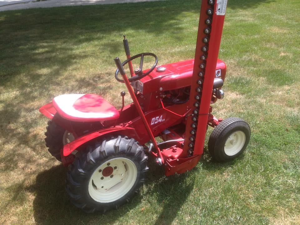

Lane Ranger 11,974 #11 Posted June 29, 2019 Stepney: The 702 short frame has a 42 inch sickle bar that I reworked on it. The 854 has the 50 inch 7-1312 (same basic model as the 7-1311). The 50 operated fine on the 854 but I think a ten or 12 HP motor makes it run better. The 42 inch is better suited for the small frame tractors. 2 1 1 Share this post Link to post Share on other sites
Stepney 2,357 #12 Posted June 29, 2019 1 hour ago, Lane Ranger said: Stepney: The 702 short frame has a 42 inch sickle bar that I reworked on it. The 854 has the 50 inch 7-1312 (same basic model as the 7-1311). The 50 operated fine on the 854 but I think a ten or 12 HP motor makes it run better. The 42 inch is better suited for the small frame tractors. The one thing that had me hung up was the little 'curve' at the far end of the sickle frame, wasn't sure if there would be enough room to tighten the belt and lock that little lock collar. Nice to know it works. 2 Share this post Link to post Share on other sites

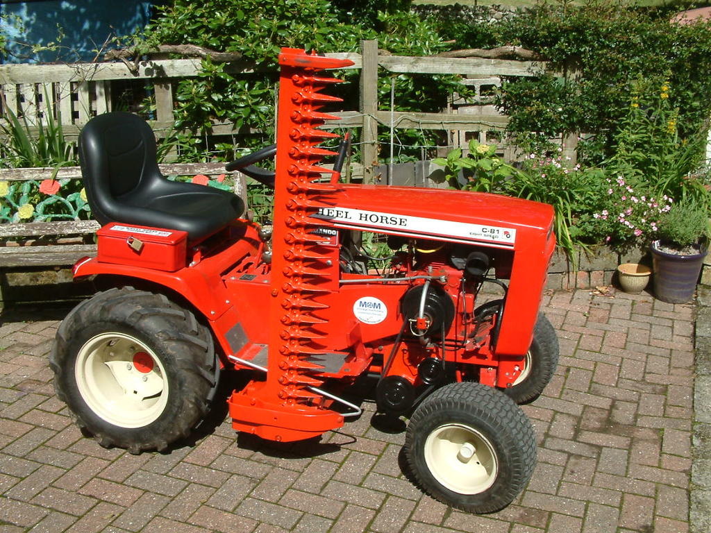

Stormin 9,988 #13 Posted June 29, 2019 My C81 is my designated sickle bar tractor. Had to make my own drive up. 4 Share this post Link to post Share on other sites

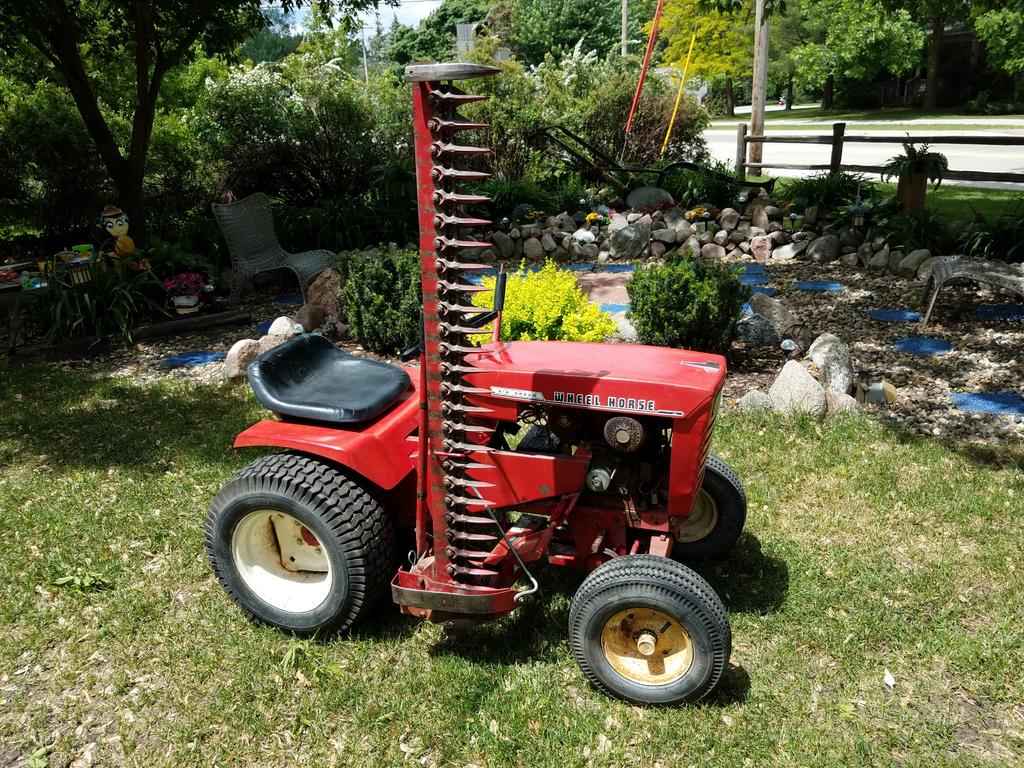

Thegearhead0324 1,534 #14 Posted June 30, 2019 I got a 7 1312 7 on my 1257 which is long frame with no mods needed. I got it running on the pto pulley and only used it twice running low idle. 4 Share this post Link to post Share on other sites
