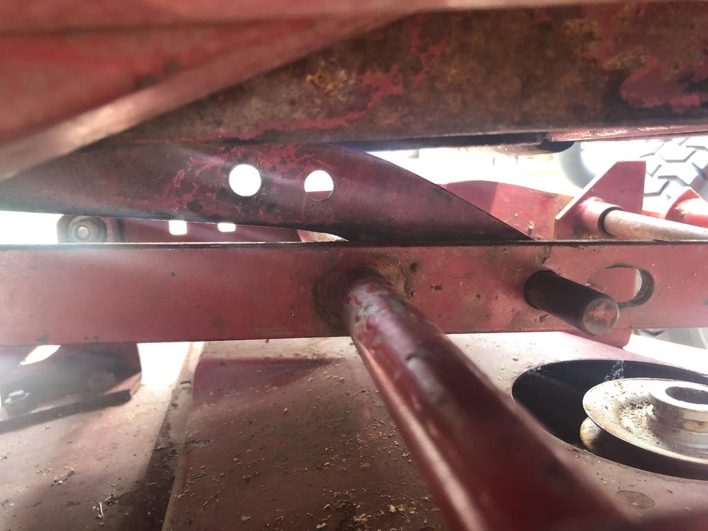

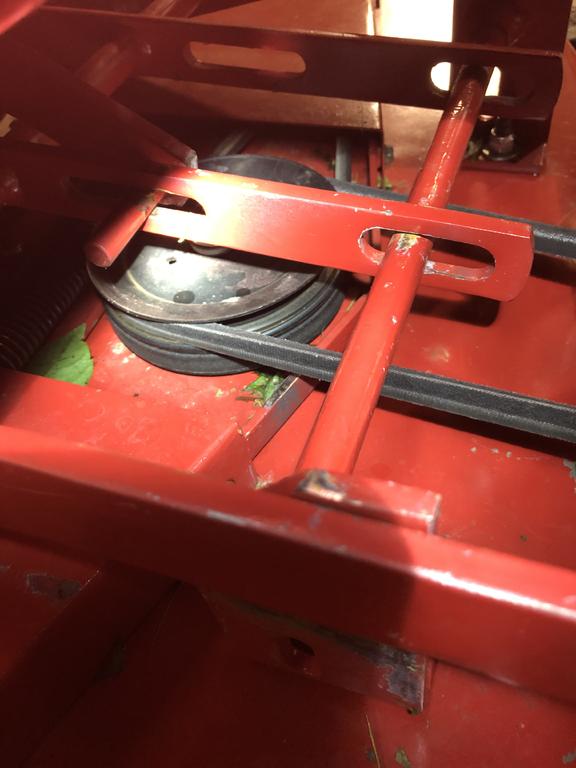

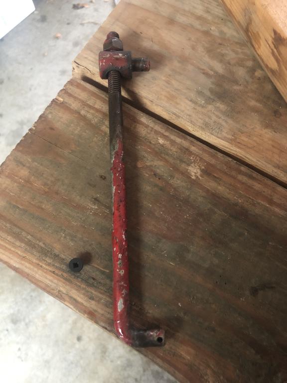

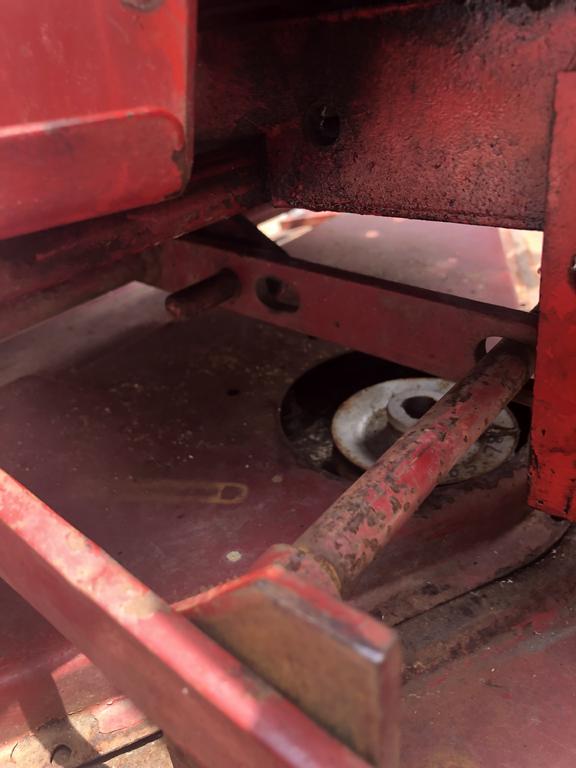

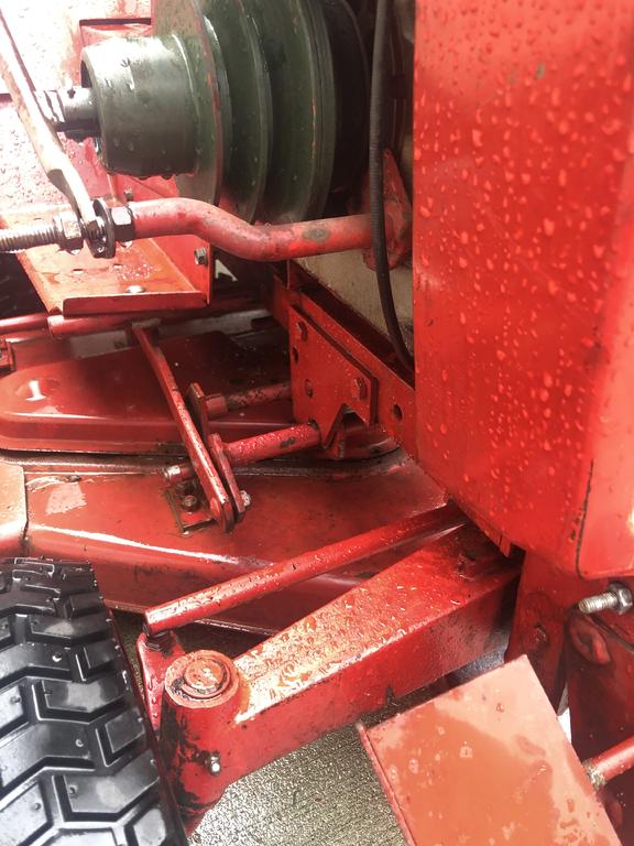

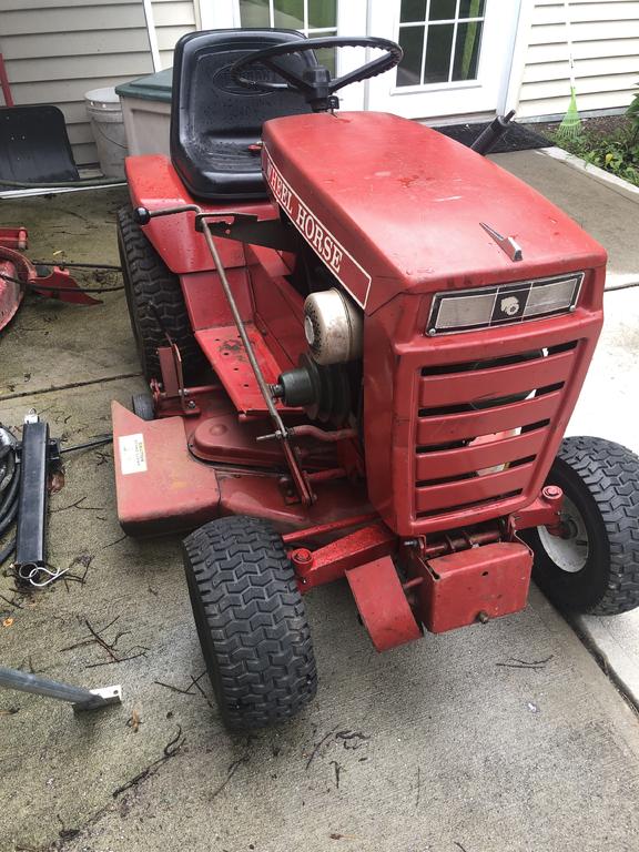

LengerichKA88 1,885 #1 Posted June 23, 2019 I’m attempting to put the deck we got with this tractor on, but I don’t know what I’m doing haha. I’ve got the mule drive back on, I’ve got the front bracket connected (that’s what I’m calling it, and I believe I have the right thing in the right place). But I can’t for the life of me figure out how I’m supposed to attach the bar (same one I used for the dozer blade)to the deck so that the deck will raise and lower. I also haven’t been able to find a decent picture showing how the belt(s) will go, and what sizes I’ll need. Am I missing a part? Do I have something in the wrong spot? Tried to take as many pictures showing as much as I could, if more are needed, I’ll be happy to take them. Thanks in advance for any help! Share this post Link to post Share on other sites

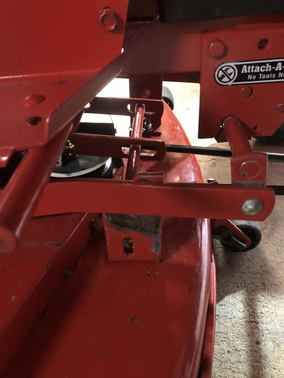

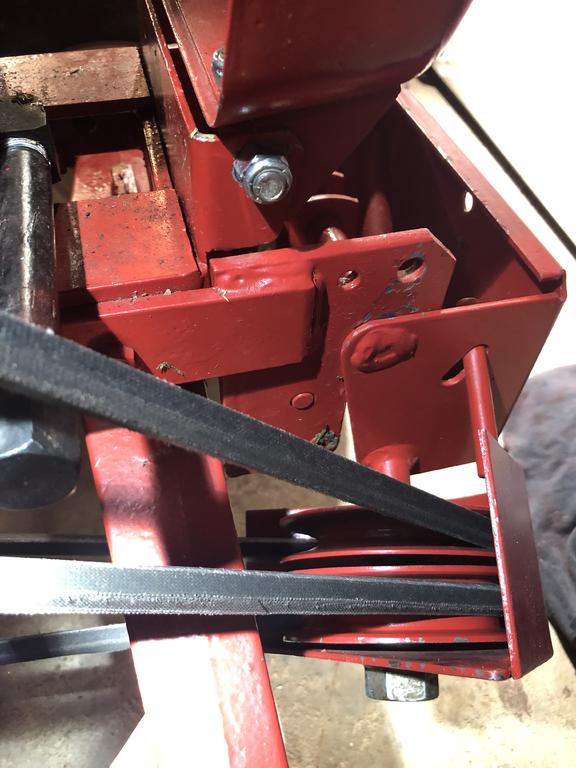

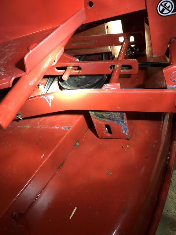

The Tuul Crib 7,340 #2 Posted June 23, 2019 See if these pics don’t help you out your lift arm goes into a long slotted hole on the deck in the bar that goes into the attach o matic has a set of fork like that goes straight up. Make sure to hook up the lift arm first. 1 1 Share this post Link to post Share on other sites

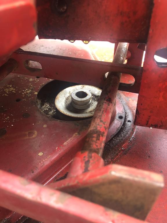

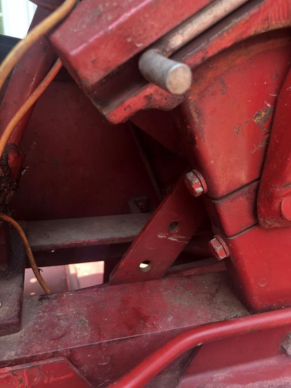

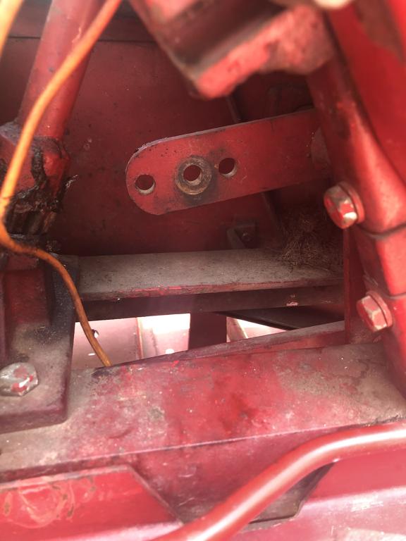

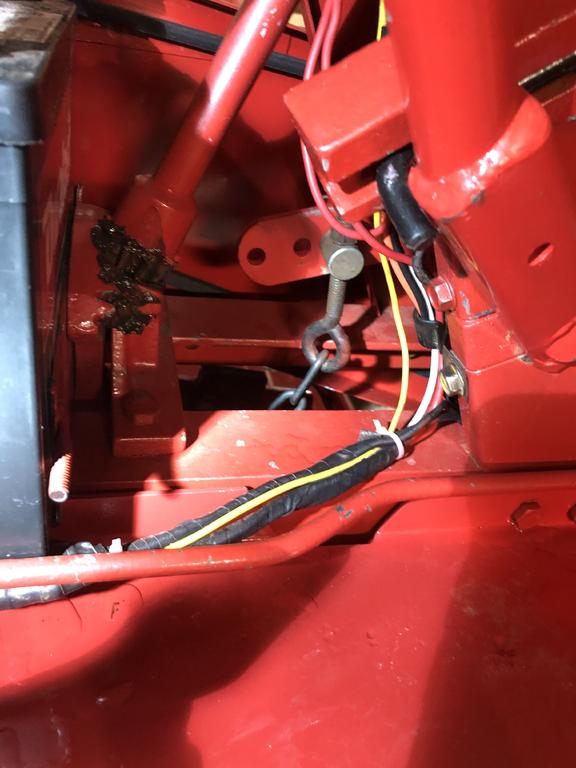

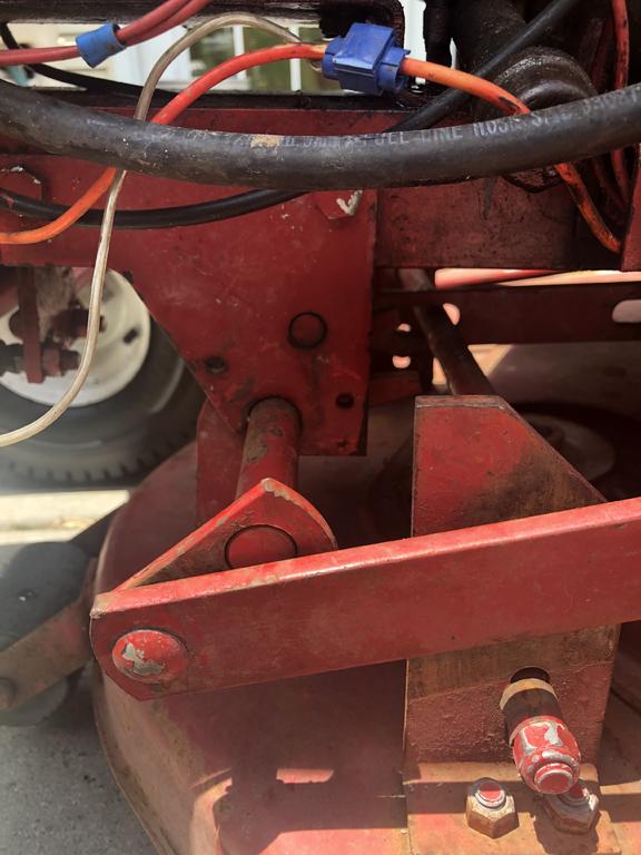

LengerichKA88 1,885 #3 Posted June 23, 2019 That helps, thanks @The Tool Crib! But also raises another question: what does this chain piece you have go to? I don’t have one of those, but I’ve got this: Share this post Link to post Share on other sites

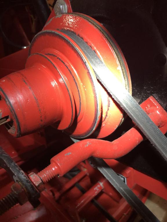

LengerichKA88 1,885 #4 Posted June 23, 2019 @The Tool Crib would it me too much to ask for pictures of the belts? I’ve never used a tractor that had a PTO before, so I’m clueless on that too, and haven’t found many pictures. Angles like this is what I’m looking for: Share this post Link to post Share on other sites
The Tuul Crib 7,340 #5 Posted June 23, 2019 1 minute ago, LengerichKA88 said: That helps, thanks @The Tool Crib! But also raises another question: what does this chain piece you have go to? I don’t have one of those, but I’ve got this: That is the same as the chain. It goes from your lift to the arm that goes to the deck. I hope im making sense! Im bad at directions sorry 1 Share this post Link to post Share on other sites

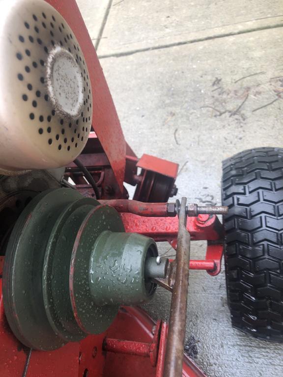

The Tuul Crib 7,340 #6 Posted June 23, 2019 Just make sure your belt comes off the top of the PTO goes to the inside of the mule drive And the bottom of the PTO goes to the outside pulley on the mule drive 1 Share this post Link to post Share on other sites

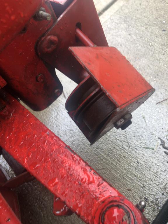

LengerichKA88 1,885 #7 Posted June 23, 2019 Well, I see that it’s going to have to wait anyway, as I don’t have the correct pulley... I’ll need to find one of those it appears Share this post Link to post Share on other sites
The Tuul Crib 7,340 #8 Posted June 23, 2019 14 minutes ago, LengerichKA88 said: Well, I see that it’s going to have to wait anyway, as I don’t have the correct pulley... I’ll need to find one of those it appears What pulley do you need? Share this post Link to post Share on other sites

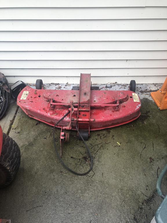

LengerichKA88 1,885 #9 Posted June 23, 2019 Here’s another question that you may be able to answer for me: Is there a way to make this deck work on this tractor? I highly doubt it, but thought it would be worth to ask. Share this post Link to post Share on other sites
LengerichKA88 1,885 #10 Posted June 23, 2019 Just now, The Tool Crib said: What pulley do you need? Mine doesn’t have a double pulley up front Share this post Link to post Share on other sites
The Tuul Crib 7,340 #11 Posted June 23, 2019 2 minutes ago, LengerichKA88 said: Mine doesn’t have a double pulley up front That is a totally different attachment. And the attach o matic will not work. Share this post Link to post Share on other sites
LengerichKA88 1,885 #12 Posted June 23, 2019 9 minutes ago, The Tool Crib said: That is a totally different attachment. And the attach o matic will not work. You mean the 42in deck correct? I didn’t think so, was worth a shot to ask. It’s the one that came with the Charger 9 The one that’s under it and came with it is the 36in. It doesn’t have an open faced guard like the 42 does. That’s the one I need to find a double pulley for like what’s on yours. Sorry if I wasn’t clear: when we bought it, that pulley was missing. We ordered what we thought was the right one at the time (September of last year-ish). Now that I’ve seen your pictures, we know that is not the case. Which is perfectly fine! Now I know what I need. Share this post Link to post Share on other sites
3QTR40 6 #13 Posted June 25, 2019 Jackssmallengines.com carries the double pulley. They’re not cheap though. 1 Share this post Link to post Share on other sites
Stepney 2,357 #14 Posted June 25, 2019 (edited) On 6/23/2019 at 5:49 PM, LengerichKA88 said: Here’s another question that you may be able to answer for me: Is there a way to make this deck work on this tractor? I highly doubt it, but thought it would be worth to ask. In fact, that deck can work. The mounting for the hitch is a bit outdated, (That design is about 1966-70) but you can still hook it on with the lift rod and mid hitch, and run the mule drive as you would a newer deck. I have one set up that way here. Just remove the tensioner assembly from the side of it and leave only the center 'cradle'. The only thing to be careful of is to slack off the tension adjustment before lifting the deck for transport, as I find they will tighten up as you lift the deck. Otherwise, it should atleast get you going. Also while not visible, that older deck may have the double pulley you need. Edited June 25, 2019 by Stepney 1 1 Share this post Link to post Share on other sites
