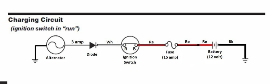

pfrederi 21,301 #27 Posted October 15, 2021 You are correct the diode cuts off half the AC it is choppy not suitable for electronics . The head lights are running on AC with voltage varying based on engine speed. (note how the get dimmer at idle). That also creates issues if you want to go LED as most 12v LEDs are DC only. Even hooking the LEDs direct to the battery may only be partially successful as the choppy DC charging may make them flicker.. 2 Share this post Link to post Share on other sites

Handy Don 17,671 #29 Posted October 15, 2021 (edited) 6 hours ago, Tuneup said: That battery is toast On the 3-amp unregulated systems, the very low amperage plus the diode cutting off ½ of the output to the battery means the battery is seeing intermittent DC at its + terminal that varies from 0 volts to 13+ volts @ 3 amps max when the engine is at speed. BUT, remember that the battery itself has some juice, so a meter measuring battery + to battery - will show an average of the the battery's voltage and the charging voltage. LED Note: Since the DC is intermittent, the LED will try to flash on and off faster than your eye can follow, hence it looks like a flicker. (Added note on the LED -- the "D" stands for diode. Current will flow through only in one direction so if you hook up an LED backwards, you get no light at all!) Edited October 15, 2021 by Handy Don 1 Share this post Link to post Share on other sites

Handy Don 17,671 #33 Posted October 16, 2021 (edited) The VOM AC test between the non-diode lead and the diode lead on the ENGINE SIDE of the diode is the money test. Put the VOM in AC mode and be sure it's in the V range not mV. You should see 14-16 AC volts there when the engine is rev'd up Edited October 16, 2021 by Handy Don Share this post Link to post Share on other sites

Howie 900 #36 Posted October 17, 2021 Ok guys, I just pulled the manual out to check on this. To check the output for AC current you would have to use a pin and penetrate wire behind the diode. Red lead there and black lead to ground. You do not test both of them together have to be done separately. The light side will show about 14 volts. If you are going to test the output after the doide red to that wire black to the positive side of battery. Share this post Link to post Share on other sites

Handy Don 17,671 #38 Posted October 17, 2021 (edited) 23 minutes ago, Howie said: Ok guys, I just pulled the manual out to check on this. To check the output for AC current you would have to use a pin and penetrate wire behind the diode. Red lead there and black lead to ground. You do not test both of them together have to be done separately. The light side will show about 14 volts. If you are going to test the output after the doide red to that wire black to the positive side of battery. @TC10284 has the insulation off the wire ahead of the diode so no pin needed. I'd make sure with the ohmmeter that you are clipped to a solid ground, either battery negative or some other spot (ohms between battery negative and your target ground should be zero). (It's likely your battery negative to ground is ok because it is cranking and starting.) Basically you are testing for AC voltage on both sides of the diode to ground/battery negative, and I think that's what I saw in the video (albeit I'm not sure the ground was clipped on for all of them ). BTW, if you do find the 14+ VAC, then you realize that you have a bad connection somewhere starting at that connector! Three other tests. With the engine OFF and connector disconnected: 1. Test for ohms between between the stator wires (on the engine side of the diode for that wire). Good is a very small resistance. 2. Test for ohms between each of the stator wires (on the engine side of the diode for that wire) and ground. Good is infinite resistance. 3. Test across the diode for ohms twice, switching the red and black probes between tests. Good in infinite one way and zero the other way. (Same in both directions means bad diode). Edited October 17, 2021 by Handy Don Share this post Link to post Share on other sites
Howie 900 #39 Posted October 17, 2021 (edited) I missed he had that wire open there. He could check the diode easily then should only flow one way. Really the manual on this does not give an AC voltage reading on that wire only the amps reading after the diode. That wire alone is the only one that has anything to do with the charging. I guess some of what I am trying to say is that on these dual circuit systems you do use the two wires to check them like the 12amp or the like. Edited October 17, 2021 by Howie Share this post Link to post Share on other sites
Howie 900 #40 Posted October 17, 2021 I Had the wrong engine in my mind, need to read twice I guess. So on a Kohler to check resistance of the stator, check from behind diode to ground should be 0.7 to 1.3 ohms. Says stator winding is Ok if checks in this range. If 0 stator winding is shorted. For voltage check at 3000 rpm, charging lead to ground should be 28 volts or more using DC voltmeter with charging lead disconnected from battery. Lighting side check same way, lead to ground Ac voltmeter 15 volts or more. Engine off resistance lead to ground approximately 0.4 ohms. 1 Share this post Link to post Share on other sites

Handy Don 17,671 #44 Posted October 18, 2021 8 minutes ago, TC10284 said: Video test results. Summary - looks like I'm getting appropriate AC voltage for the headlight side (28v WOT), only getting 10v AC from battery charge side (second link) at WOT: https://photos.app.goo.gl/aR4jUevu2YLvopkR7 https://photos.app.goo.gl/bJu1N13YgYJ4m7vbA Glad you got that settled and can move on to resolving it! Good luck Share this post Link to post Share on other sites
TC10284 124 #45 Posted October 18, 2021 (edited) 16 minutes ago, Handy Don said: Glad you got that settled and can move on to resolving it! Good luck Update: I realized I did not test AC voltage BEFORE the diode (not after). BEFORE the diode, I'm getting 15v AC at WOT. Soo...it looks like my diode is bad(?) and only allowing a max of 10V AC output and 0V DC output. Anyone have a diode part number? https://photos.app.goo.gl/EkNBJuMFRCqeBxYr5 Edited October 18, 2021 by TC10284 Share this post Link to post Share on other sites
Handy Don 17,671 #46 Posted October 18, 2021 Whoa, that is GOOD news. Diodes are very inexpensive. Did you confirm this by measuring ohms across the diode with the engine connector unconnected and by testing with the red/black probes in both directions? If the reading is the same in both directions it's definitely a bad diode. Any good auto parts store will have a suitable diode. It should be spec'd for around 30-50volts and 5-8 amps. In bulk, they are about 30¢ but individually you'll pay a $1 or so. Ideally, it should be soldered in (paying attention to the band marking toward one end of the diode to be in the same direction as the one on the current diode). I use combo heat shrink solder connectors (also at the auto parts store--for best results, use a heat gun to activate the solder/shrink and not a torch or match!). Since I use a lot of these, I buy an assortment of sizes to keep on hand. You can wrap electrical tape around the joints and the diode once its connected, but I prefer to use a piece of heat shrink tubing over the entire assembly to reinforce and protect it. Again, I buy shrink tube assortments since I use it frequently. Share this post Link to post Share on other sites
TC10284 124 #47 Posted October 18, 2021 1 hour ago, Handy Don said: Whoa, that is GOOD news. Diodes are very inexpensive. Did you confirm this by measuring ohms across the diode with the engine connector unconnected and by testing with the red/black probes in both directions? If the reading is the same in both directions it's definitely a bad diode. Any good auto parts store will have a suitable diode. It should be spec'd for around 30-50volts and 5-8 amps. In bulk, they are about 30¢ but individually you'll pay a $1 or so. Ideally, it should be soldered in (paying attention to the band marking toward one end of the diode to be in the same direction as the one on the current diode). I use combo heat shrink solder connectors (also at the auto parts store--for best results, use a heat gun to activate the solder/shrink and not a torch or match!). Since I use a lot of these, I buy an assortment of sizes to keep on hand. You can wrap electrical tape around the joints and the diode once its connected, but I prefer to use a piece of heat shrink tubing over the entire assembly to reinforce and protect it. Again, I buy shrink tube assortments since I use it frequently. Ohm test of the diode: https://photos.app.goo.gl/xLAyc2hUPchsHgVbA Share this post Link to post Share on other sites
Handy Don 17,671 #48 Posted October 18, 2021 3 minutes ago, TC10284 said: Ohm test of the diode: https://photos.app.goo.gl/xLAyc2hUPchsHgVbA Not sure how your meter shows "infinity" (is it the "1" in the different ranges?) If yes, then it looks like your diode is not letting much, if any, current through and is indeed "busted". Share this post Link to post Share on other sites
