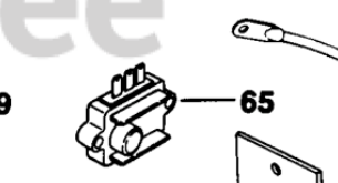

Gregor 4,848 #14 Posted October 14, 2021 (edited) This is a rectifier. Do you have this anywhere on your tractor or motor ? I have never worked on anything this new, I am only going by wiring diagrams and pics, Edited October 14, 2021 by Gregor Share this post Link to post Share on other sites
TC10284 124 #15 Posted October 14, 2021 4 minutes ago, Gregor said: This is a rectifier. Do you have this anywhere on your tractor or motor ? I have never worked on anything this new, I am only going by wiring diagrams and pics, That's what I've been looking for. Unless it's under the shroud, I don't see it. Share this post Link to post Share on other sites
Gregor 4,848 #16 Posted October 14, 2021 It is not under the shroud. It may be located on the tractor itself. 1 hour ago, TC10284 said: I get right at 14v from the bottom two wire leads of the three wire connector. Can you tell the color of these wires? 1 hour ago, TC10284 said: I get 14v on both sides of the two lower wires of the main three wire connector Are you talking about the same connector? Sorry for all the ???. Like I said, never worked on anything this new Share this post Link to post Share on other sites

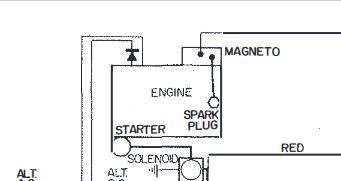

Gregor 4,848 #19 Posted October 14, 2021 There should be 2 wires coming from under the shroud. You should get 13+ AC volts from these wires. Unless it is unlike anything I have worked on yet. Something, somewhere, on that tractor, has to change that 14 VAC to DC to charge the battery, This pic show a diode/rectifier on the motor. Maybe there is something under the shroud. Are you measuring AC or DC voltage? But then this pic also show magneto ignition, and you don't have that. Share this post Link to post Share on other sites

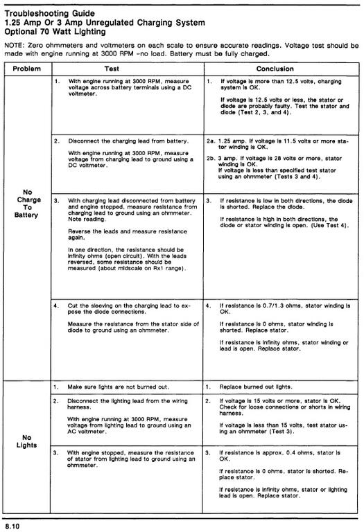

gwest_ca-(File Mod) 12,533 #20 Posted October 14, 2021 Headlamps only work when the engine is running? If so it is a 3 amp unregulated but rectified system to charge the battery. One wire at the connector will have a diode in it that you should feel through the tape covering it. Look for a bugle about 1/4" in diameter x 3/8" long. The other wire comes straight from the stator directly to the headlamps. 2 Share this post Link to post Share on other sites
TC10284 124 #21 Posted October 14, 2021 58 minutes ago, Gregor said: There should be 2 wires coming from under the shroud. You should get 13+ AC volts from these wires. Unless it is unlike anything I have worked on yet. Something, somewhere, on that tractor, has to change that 14 VAC to DC to charge the battery, This pic show a diode/rectifier on the motor. Maybe there is something under the shroud. Are you measuring AC or DC voltage? But then this pic also show magneto ignition, and you don't have that. Yep, this is what I was referring to above. I got 13V+ AC. Almost 14V AC on both sides of those two wires. Share this post Link to post Share on other sites
TC10284 124 #22 Posted October 14, 2021 37 minutes ago, gwest_ca said: Headlamps only work when the engine is running? If so it is a 3 amp unregulated but rectified system to charge the battery. One wire at the connector will have a diode in it that you should feel through the tape covering it. Look for a bugle about 1/4" in diameter x 3/8" long. The other wire comes straight from the stator directly to the headlamps. Yes, lights only work when engine running. Yep, bingo. Found it: https://photos.app.goo.gl/gG48MBKiY1qqc3cj7 I think my next step is to make sure to fully charge that battery, test it with a load tester, recharge it, and then proceed with Step 1 in the troubleshooting guide above. So question on Step 2 - "Disconnect the charging lead from the battery". I take that to mean the following: With engine running, put a jumper wire from from positive on battery to positive on coil? Then disconnect the main three wire connector from the tractor wiring harness. Then proceed to Step 2 test. Share this post Link to post Share on other sites
953 nut 70,324 #23 Posted October 14, 2021 1 hour ago, TC10284 said: Hers a pic of the engine Please attach your photos to your post, attempted to open your photo but needed a password. 5 minutes ago, TC10284 said: I got 13V+ AC. Almost 14V AC on both sides of those two wires. The output side of the diode should be 14 volts DC with the engine running. Share this post Link to post Share on other sites
