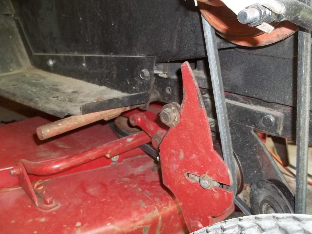

i was wondering if this mower deck would fit on a 1973 no name ;i have tried a few of the 36 inch types a SD-R-D but they will not work as the height bar that attaches to the lift assembly  is way to short ;i would like to try this old girl out after a year of tinkering with it ;thanks and i look forward to your reply when you get the time'well at least i was told it is a 73 no name as the brake handle;and yes it is a 16 horse automatic ;

953 nut
You would need to find the drive mechanism that proceeded the mule drive or modify the deck a little to use a mule drive809873986_mower003.JPG.7616ce34e3236e58bdc189f13e4ca042.JPG.

Instead of running down that old-style...side mount mule drive (poor design...problematic), just swap out the lift hardware that is on that deck to the Tach-o-Matic system and use a front Mule drive made for the tractor.
Easy to do...drill a few holes...and I ahve all the lift hardware to make this modification.

upstate yank
thanks for the reply and lucky me i have one of those items heck i forgot i had it ;so just maybe i can get it to mow; thanks again

upstate yank
thanks for the reply and i do have one of those old style mounts i just need to replace the bearing in the pulley ;

again thank you and as i mentioned before i have that style but what i do not have is that small roller well more as a guide .at times i wonder at times is it really worth it ;if i could find the correct deck for the 73 which does have the mule drive that would be great

yep you might be correct here but on the 73 i have ;i do have the correct lift assembly that came with the old girl plus there is a mule drive attachment in the lower front as most have;it might be best not to mess at times with things as it does get complicated so it might be best to find the correct deck that will fit as i have tried both a side discharge and the rear which both are a 36 inch with 3 blades ;the only thing that i am having issues with is the rod that attaches to the deck and runs up to the lift ;i just thought that maybe this deck would work as i have the same type on my older 69 charger 10 which out of the 7 horse i have that is my favorite ; again thank you

to all of the members that added there thoughts as if this older style mower deck i traded for would fit on the on the 73 i have ;as i have mentioned i do have that complete set up as was mentioned but i do not have the small roller if that is what you might call it that slides up and down the arm as i would call it plus the one pulley needed ;i would i would like to know if this deck would work as i do have the mule drive as well if i can use that instead ; i really do not know which deck would fit as i have tried so many plus tractor does have the electric clutch and if the clutch does fail i have the complete set up for a Manuel 'so again advise sure would be appreciated ;thanks

i should added as well that the deck did fit but with that bumper in the front hitting on the top of the deck once i tried to raise it;i would really hate to cur it off but if i did the handle would lock in 'again if i could fine the correct deck for this 73 it would be great
