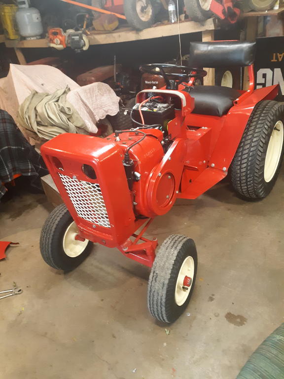

Jordanhorse96 92 #1 Posted June 11, 2019 You can't imagine how many times I've had to take the carburetor on and off due to s*** in the float Bowl new fuel filters Jets getting clogged or the gasket on the bottom of carburetors don't seat right this tractor never ever does wht I want it to do omg it is haunted I swear 4 Share this post Link to post Share on other sites
19richie66 17,950 #2 Posted June 11, 2019 Fuel tank full of goo? Nice looking tractor. Share this post Link to post Share on other sites

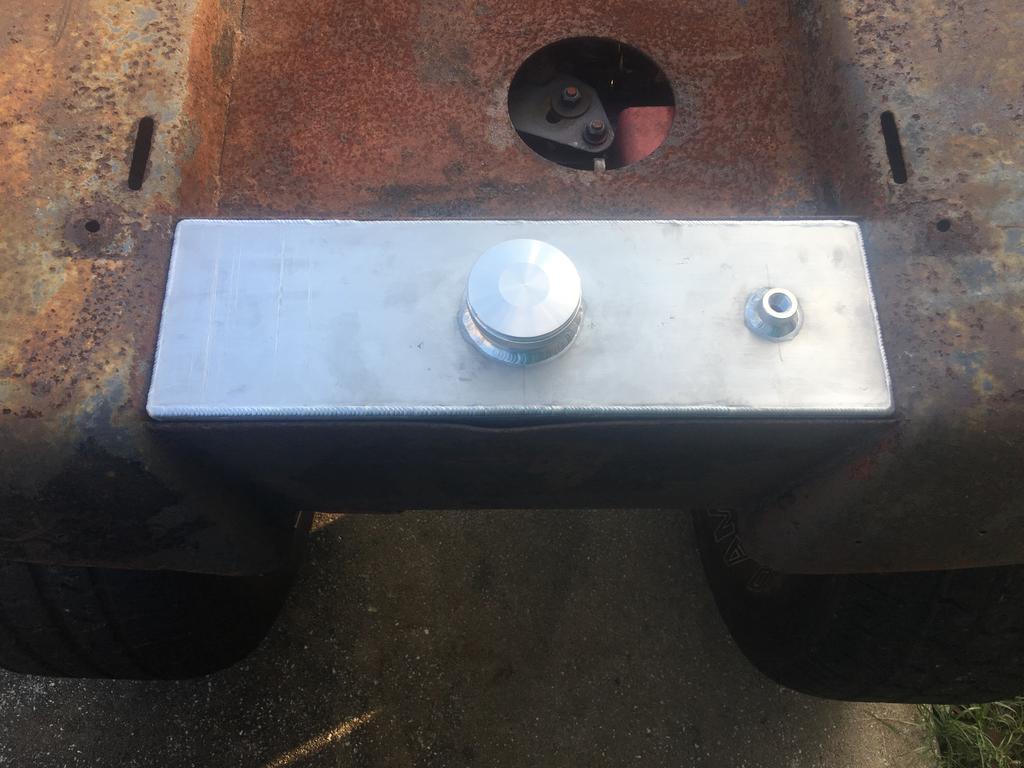

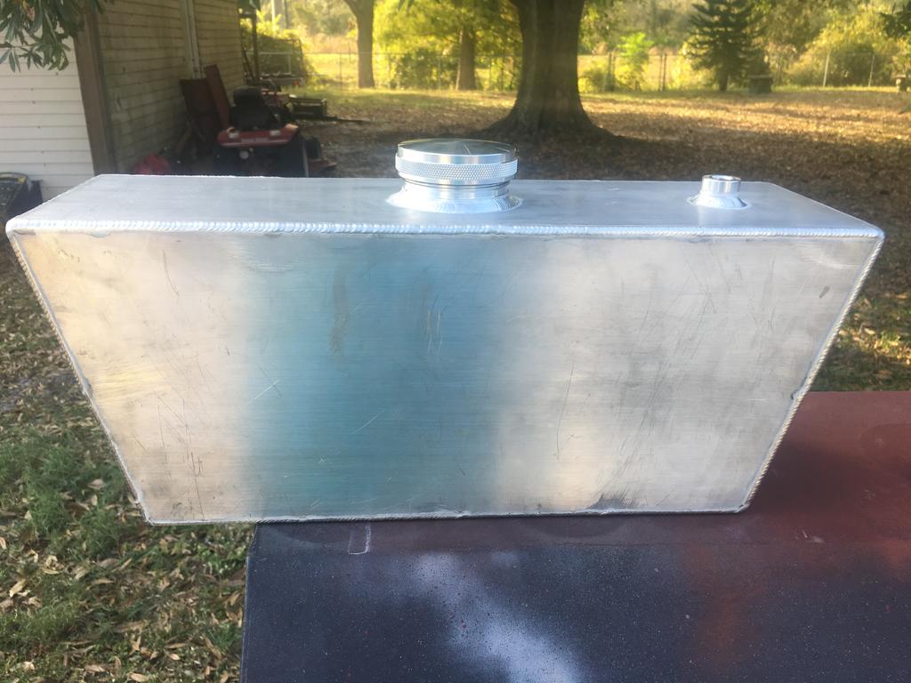

Sparky-(Admin) 26,693 #3 Posted June 11, 2019 Got an in-line fuel filter on it? I hear those fuel tanks are a pain to get to but maybe it’s worth it to give it a proper cleaning or replace it. Member @19richie66 made a tank that fits in that “trunk” behind the seat. 3 1 Share this post Link to post Share on other sites
Jordanhorse96 92 #4 Posted June 12, 2019 Yes something I took carb off now it is spot less and the gas tank is clean thanks this tractor is really nice just needs to stop leaking gas on the carb or fuel pump always something on this one 1 Share this post Link to post Share on other sites
19richie66 17,950 #5 Posted June 12, 2019 Actually it’s for my wife’s 1054 but I plan on putting one in Hank, my 953. 4 6 Share this post Link to post Share on other sites

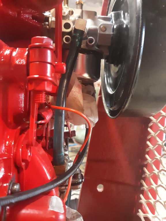

AMC RULES 37,260 #8 Posted June 12, 2019 Can't tell... do I see clamps on that fuel line? Share this post Link to post Share on other sites
19richie66 17,950 #9 Posted June 12, 2019 Noticed it but didn’t think nothing about it. Possible it could be seeping around the fuel lines under pressure when the float closes and the pump is still pumping. Share this post Link to post Share on other sites

Jordanhorse96 92 #11 Posted June 12, 2019 The felines I use are pretty tight fit you want to slide them onto the fitting of the carburetor or the fuel pump they get stuck on so they don't leak also carb was off.it was clean the bowl gasket keeps leaking and I do not use ethanol gas I ant dumb tht stuff eats carb up belive me ik Share this post Link to post Share on other sites
