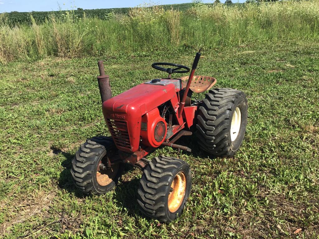

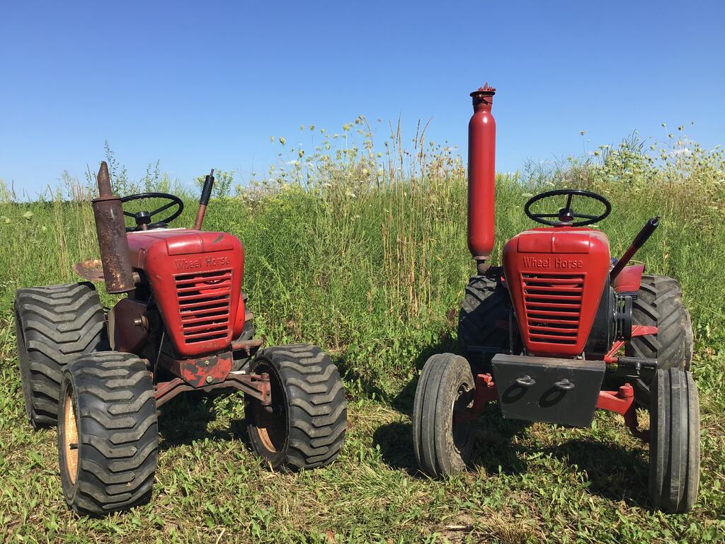

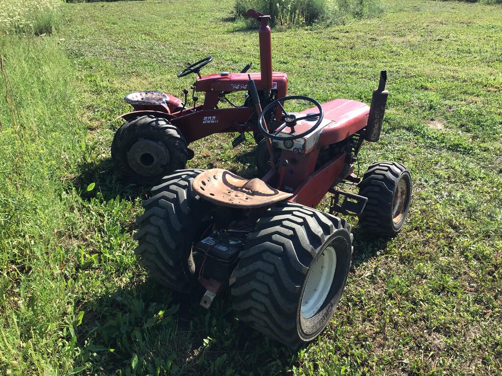

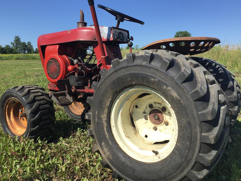

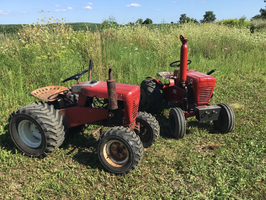

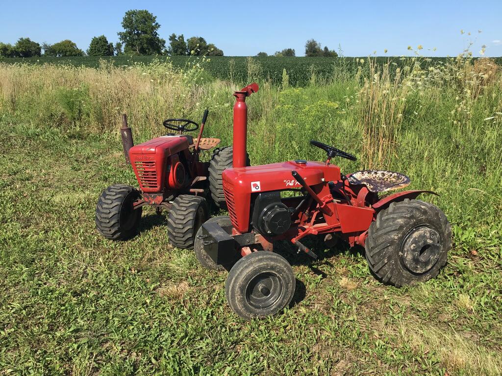

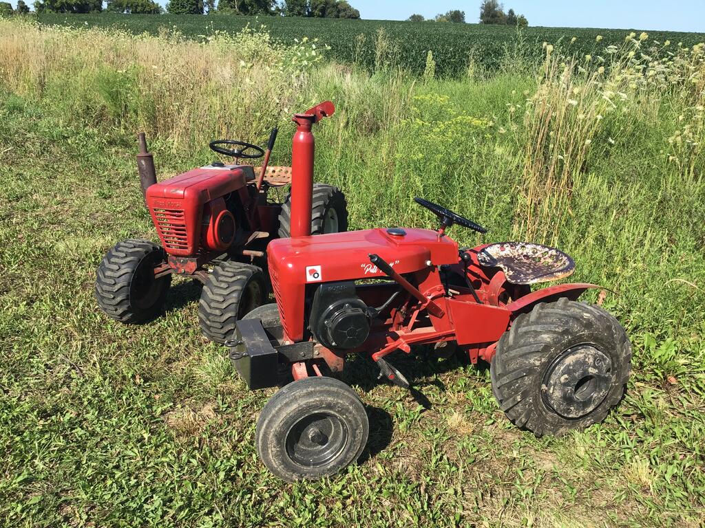

Pullstart 70,770 #101 Posted August 21, 2020 Poppy was a blast to toss together! I sure would have loved to see a dual belt guard sticking out the side, but all in all, it’s a beast the way it came out! here’s my two ‘62’s, the 502 Putt Putt and 552 Poppy! 2 6 1 2 Share this post Link to post Share on other sites
Tractorhead 9,217 #102 Posted August 21, 2020 Nice couple, both are looking really cool. Poopy - huh now it‘s more a „Rocky“ 👍 1 1 Share this post Link to post Share on other sites
71_Bronco 1,072 #104 Posted August 21, 2020 That thing looks mean. I like how you have the rear tires into the tractor more than normal, keeping it relatively narrow overall, rather than making it super wide with normal offset wheels. My lawn ranger is going to have a similar look, went with 0" offset, 8-1/2" wide wheels on the back. 1 Share this post Link to post Share on other sites
Pullstart 70,770 #105 Posted August 21, 2020 7 minutes ago, 71_Bronco said: That thing looks mean. I like how you have the rear tires into the tractor more than normal, keeping it relatively narrow overall, rather than making it super wide with normal offset wheels. My lawn ranger is going to have a similar look, went with 0" offset, 8-1/2" wide wheels on the back. It was purely accident how the wheels and tires came together in the rear... I had purchased the wheels from @953 nut at last year’s Big Show and was given these tires as payment on a family job. Once I mounted the tires up, I started hunting for a tractor in the fleet that they might fit on 1 1 Share this post Link to post Share on other sites

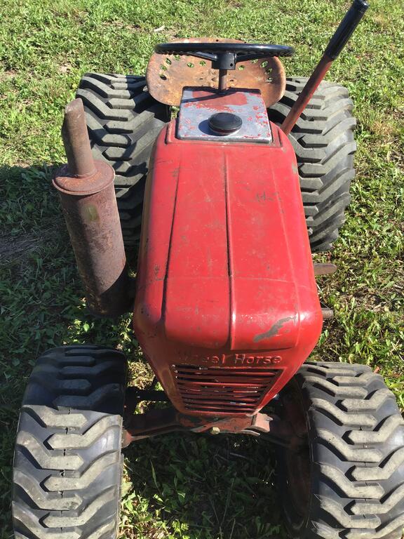

Pullstart 70,770 #106 Posted August 21, 2020 10 hours ago, pullstart said: This is my @AMC RULES shot! 1 Share this post Link to post Share on other sites

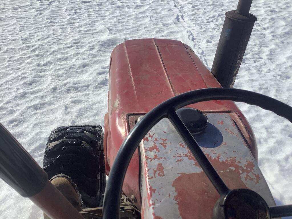

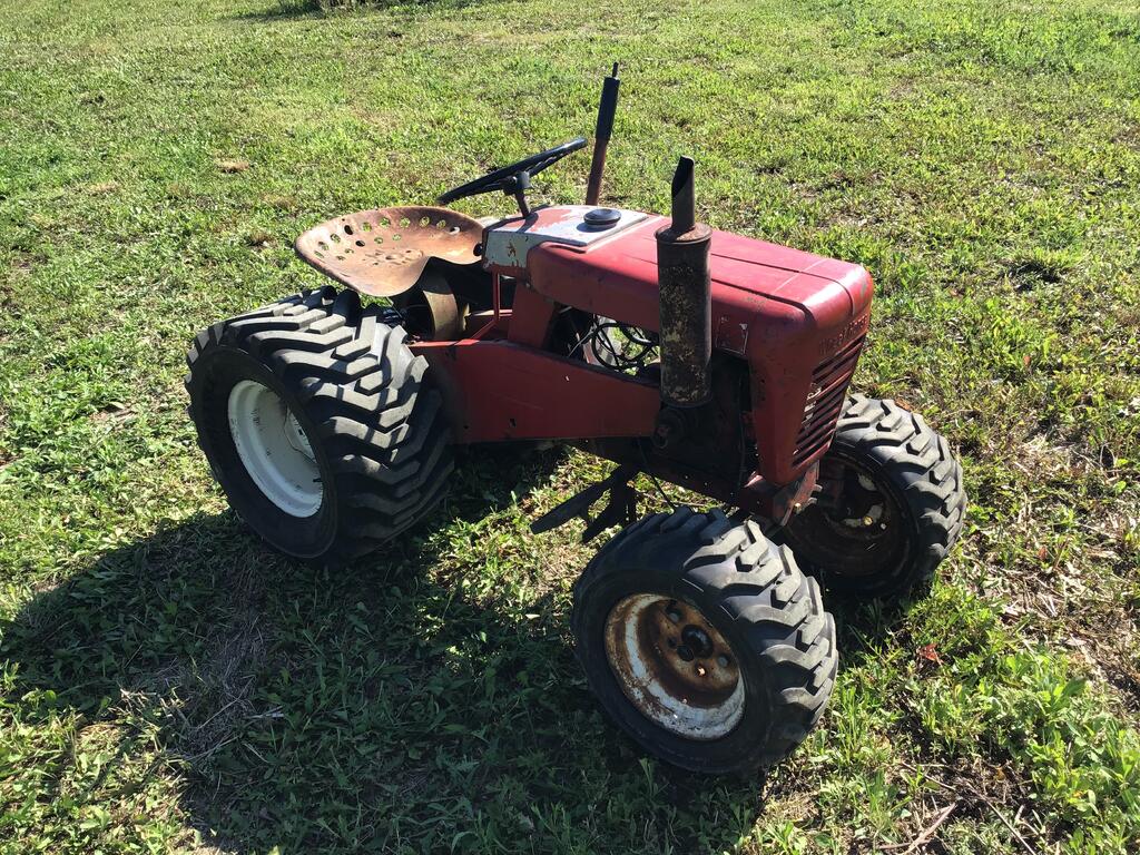

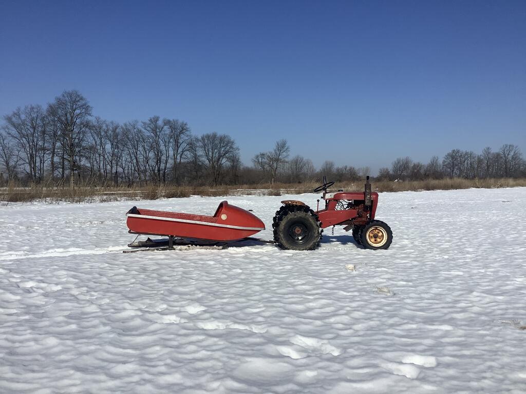

Pullstart 70,770 #107 Posted January 29, 2021 I stuck my “new” plow tires on Poppy to see how it performs. Huge improvement over the 26x12-12’s! 1 1 1 Share this post Link to post Share on other sites

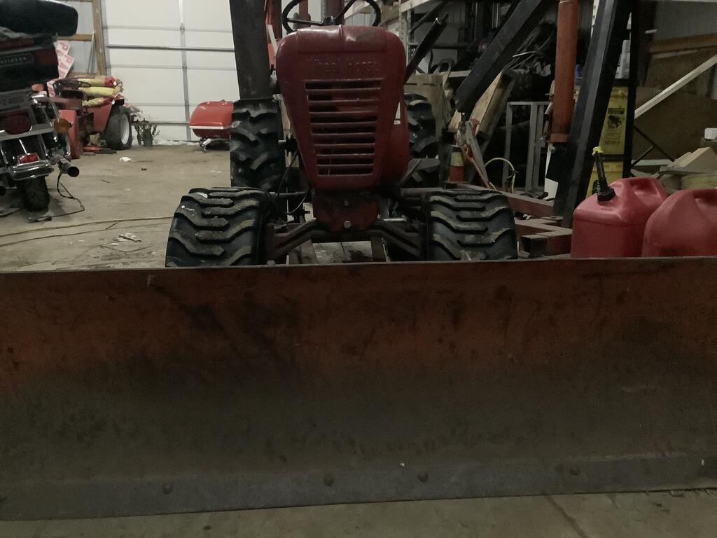

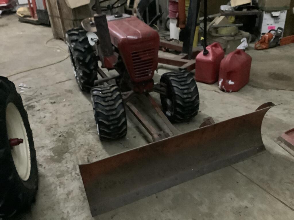

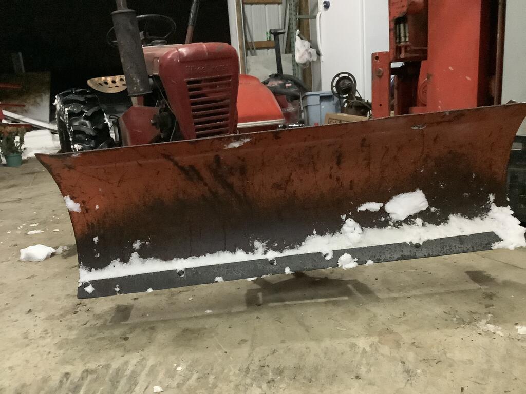

Pullstart 70,770 #108 Posted February 5, 2021 I stuck a 48” plow on Poppy last night. The front tires grab the plow at full lock, so I’ll need to get some skinnies up front for plow work. 2 Share this post Link to post Share on other sites

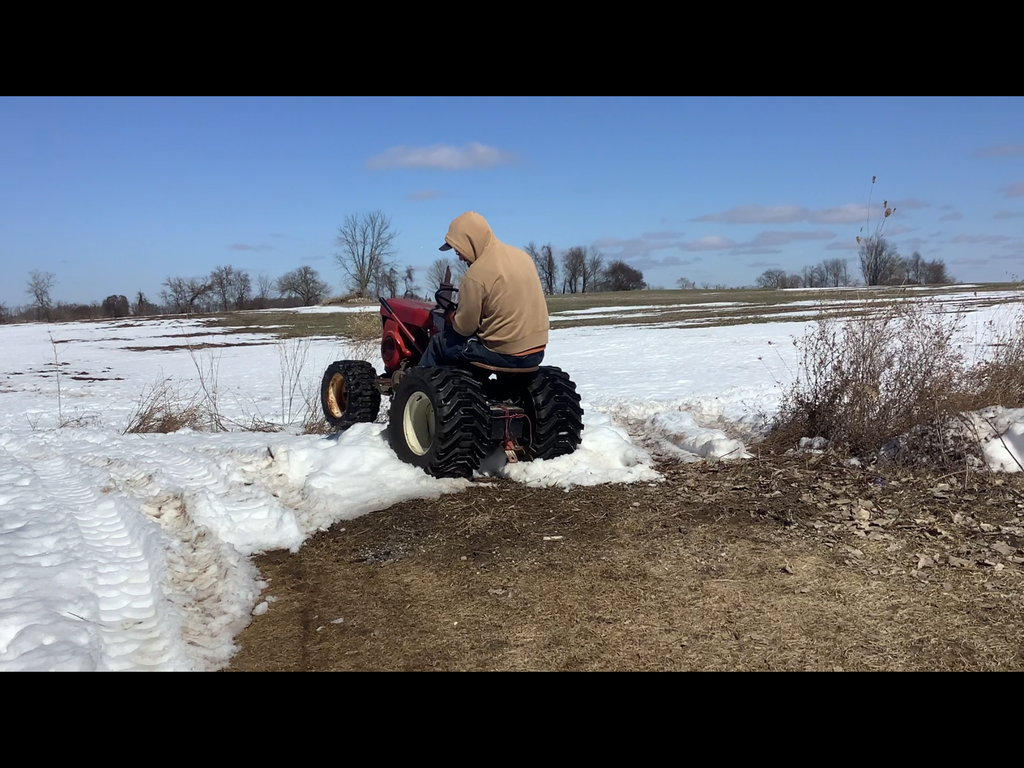

Pullstart 70,770 #112 Posted March 4, 2021 @WVHillbilly520H Jeff, the loaded skinnies still win! That’s as far as I could get in the deep stuff! Share this post Link to post Share on other sites
WVHillbilly520H 10,378 #113 Posted March 4, 2021 1) you didn't sink though, right? 2) R4s suck at traction guess how I know? Share this post Link to post Share on other sites
Pullstart 70,770 #114 Posted March 4, 2021 2 minutes ago, WVHillbilly520H said: 1) you didn't sink though, right? 2) R4s suck at traction guess how I know? They dug a hole as soon as they hit snow, then I stopped. A few tries, no further than the edge of solid ground did I get. 1 Share this post Link to post Share on other sites
WVHillbilly520H 10,378 #115 Posted March 4, 2021 (edited) 45 minutes ago, pullstart said: They dug a hole as soon as they hit snow, then I stopped. A few tries, no further than the edge of solid ground did I get. Yeah, without 4WD and or chains my eMax is about worthless with that particular tread pattern R4, and the rears are fluid filled, that's one reason I kept the rear blade hanging off the back. Unfortunately the tire size for this machine leaves little chance of me improving other than turfs and chains so what's the point? Yesterday it "looked" as though you dug deeper with the "shinnies" than those, camera angle? That's why I asked if you sank, its funny that most likely my 520 out weighs your tractor but I stayed mostly on top of the snow while "churning" it up behind me , IDK different situations require different approaches. Another thing you can probably notice the difference on between the wide R4s and the narrow R1s is the actual tread/rubber compound the R4 being harder less flexible (because of its intended/designed use) therefore less tractive properties vs the R1 softer more flexible tread/rubber compound allowing a more tractive advantage over the longer wearing industrial type tires, just from my experiences with garden tractors in general the Cub Cadet Original my dad bought way back 1977 had those infamous "Town & Country" rear tires (fluid filled) hard as a brick but wears forever, but unless mowing on flat ground we had to ran chains year around on it until I bought a set of 6-12 R1s for it, then it was like where have these been all may younger days? Edited March 4, 2021 by WVHillbilly520H 1 Share this post Link to post Share on other sites
Pullstart 70,770 #116 Posted March 4, 2021 28 minutes ago, WVHillbilly520H said: Yeah, without 4WD and or chains my eMax is about worthless with particular tread pattern R4, and the rears are fluid filled, that's one reason I kept the rear blade hanging off the back. Unfortunately the tire size for this machine leaves little chance of me improving other than turfs and chains so what's the point? Yesterday it "looked" as though you dug deeper with the "shinnies" than those camera angle? That's why I asked if you sank, its funny that most likely my 520 out weighs your tractor but I stayed mostly on top of the snow while "churning" it up behind me , IDK different situations require different approaches. Another thing you can probably notice the difference on between the wide R4s and the narrow R1s is the actual tread/rubber compound the R4 being harder less flexible (because of its intended/designed use) therefore less tractive properties vs the R1 softer more flexible tread/rubber compound allowing a more tractive advantage over the longer wearing industrial type tires, just from my experiences with garden tractors in general the Cub Cadet Original my dad bought way back 1977 had those infamous "Town & Country" rear tires (fluid filled) hard as a brick but wears forever, but unless mowing on flat ground we had to ran chains year around on it until I bought a set of 6-12 R1s for it, then it was like where have these been all may younger days? The skinny tires here are Interco UTV tires, I’d imagine the durometer would say they are as hard or harder than the R4’s. I’d have to sink my nail into the treads to confirm that. The R4’s are also FLAT. There is zero air in them, front or back. Well, the Interco’s have zero air too, but they are pressurized with fluid. Share this post Link to post Share on other sites
WVHillbilly520H 10,378 #117 Posted March 4, 2021 9 minutes ago, pullstart said: The skinny tires here are Interco UTV tires, I’d imagine the durometer would say they are as hard or harder than the R4’s. I’d have to sink my nail into the treads to confirm that. The R4’s are also FLAT. There is zero air in them, front or back. Well, the Interco’s have zero air too, but they are pressurized with fluid. I was thinking back to my buddies and Intercom Bogger tires soft tread for digging over rocks and flipping mud, vs industrial tires designed and made to wear longer for "skid" steers loaders and backhoes, . 1 Share this post Link to post Share on other sites

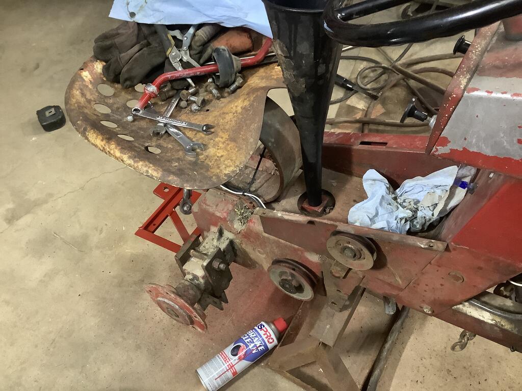

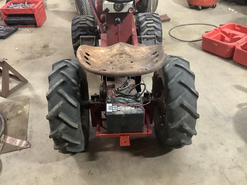

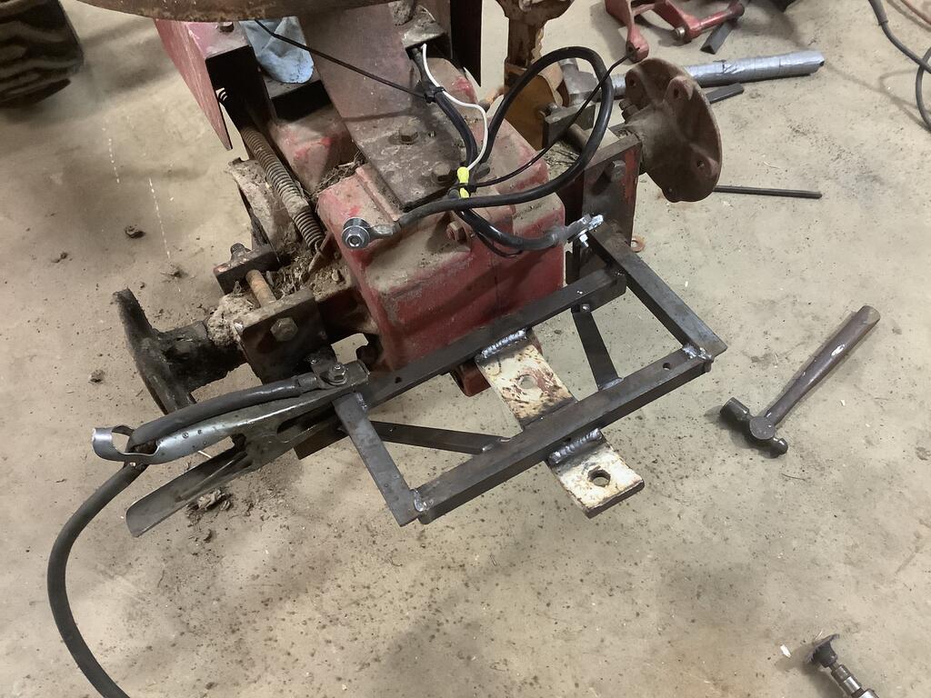

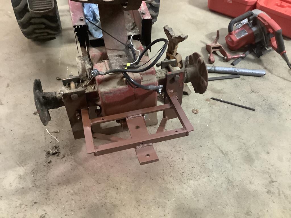

Pullstart 70,770 #118 Posted March 5, 2021 I modified the custom snow plow hitch into a more reasonable battery tray this morning. I didn’t realize I’d be pulling much with this one. A splash of Regal Red in a little bit and we’ll be good to go! Up next, a new belt, engine and transmission oil change and I need to adjust the choke cable just a tickle. 2 1 Share this post Link to post Share on other sites

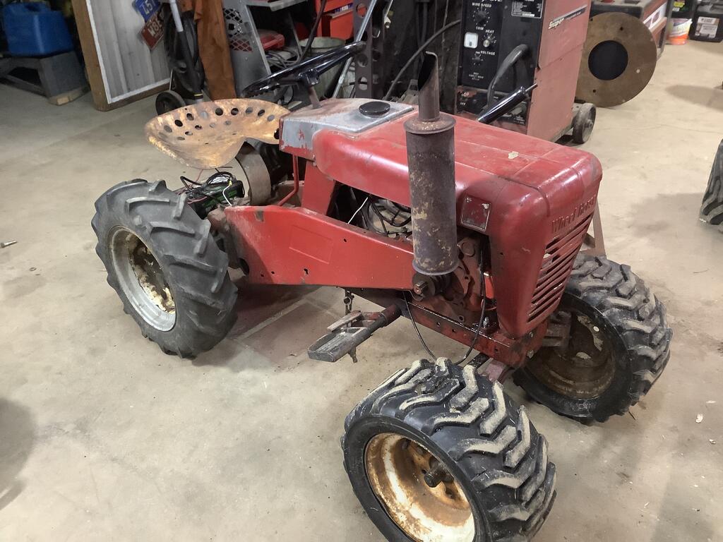

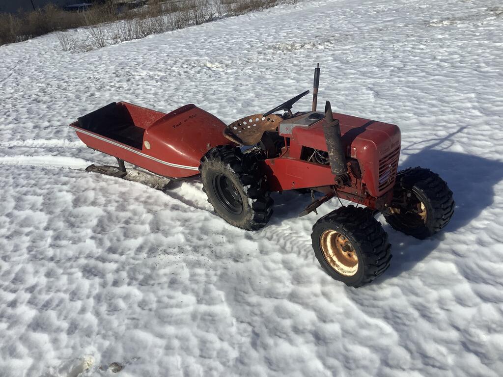

Pullstart 70,770 #119 Posted March 5, 2021 Transmission is clean and happy. This one likes to hold onto a gear while shifting, so I went with a 30 W / 90 W blend. Hopefully it will free up the shift rails. And just for some excitement, a set of 6-12’s on the rear! Actually, my niece is staying with us for a couple days and I have a feeling the girls will be having some tractor sleigh rides with their cousin. This will keep everyone safe from big tires. 2 Share this post Link to post Share on other sites

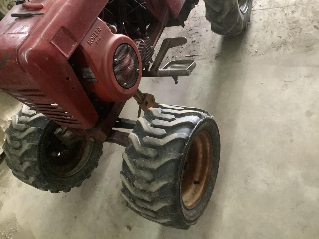

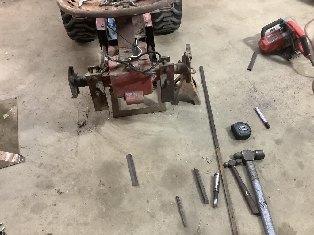

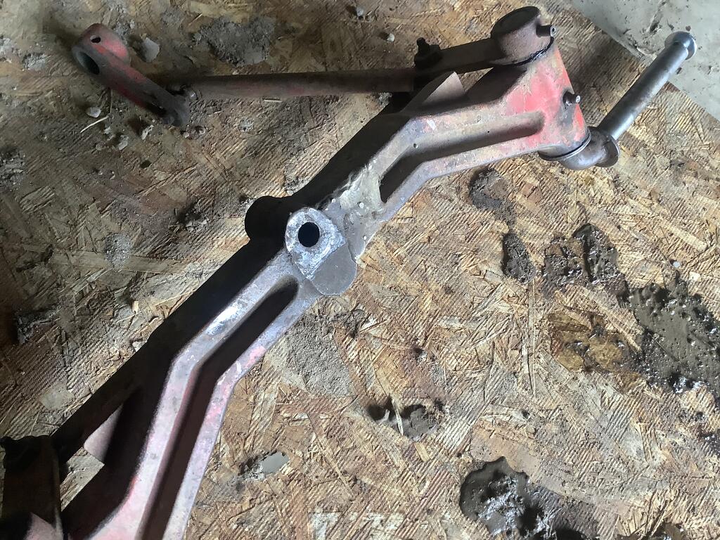

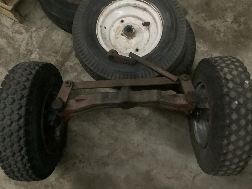

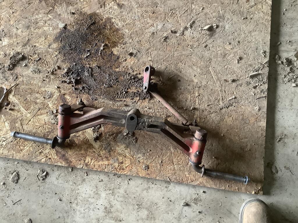

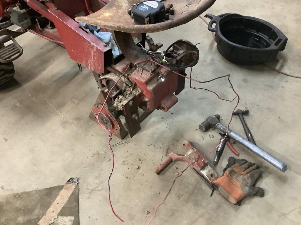

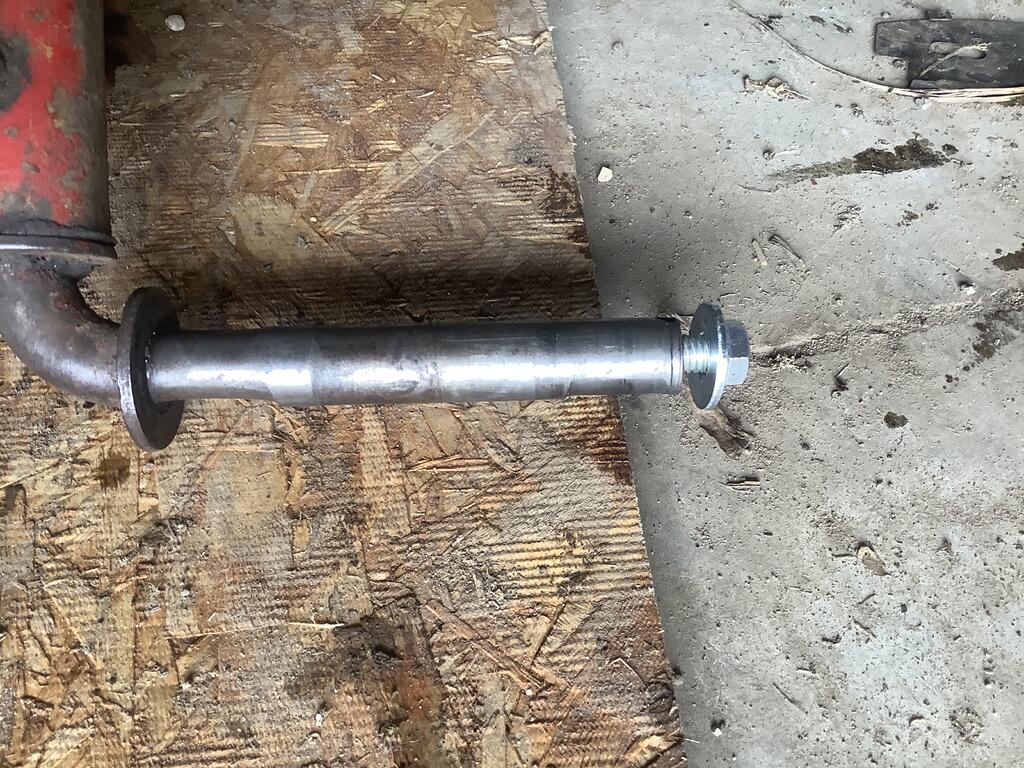

Pullstart 70,770 #120 Posted March 10, 2021 In a quest to find some decent ‘61-‘62 steering parts for Uncle Jim and his Sidekick Dan the Pirate, (what is that on your head Jim, a toilet seat riser?) we decided to pull Poppy’s front end apart. This old assembly was from Putt Putt, when I upgraded to a ‘64 frame. I drilled the steering arms and spindles out to fit a super spring 5/16” roll pin back in the day. The rest of this steering system I tightened up as well back then. I popped the spindles off and tapped them to fit a 3/8” bolt. They used to have nails holding the wheels on. Those things sure are worn! Putt Putt lived a rough life before I got him, check out the weld job on the front axle beam! Share this post Link to post Share on other sites
Pullstart 70,770 #121 Posted March 10, 2021 @Achto Dan, these spindles are in much better shape! Since Poppy’s front hubs are drilled all the way through, I have plenty of stock to ride on with the other ones 2 1 Share this post Link to post Share on other sites
