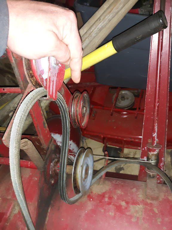

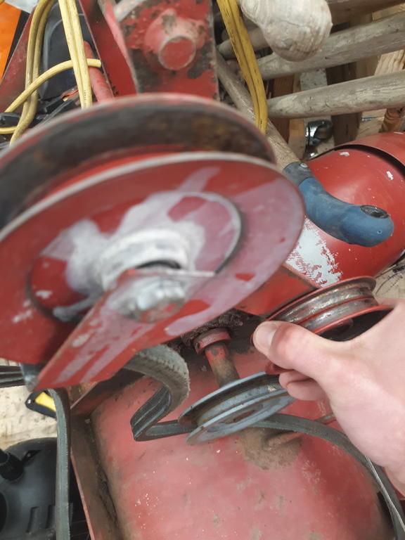

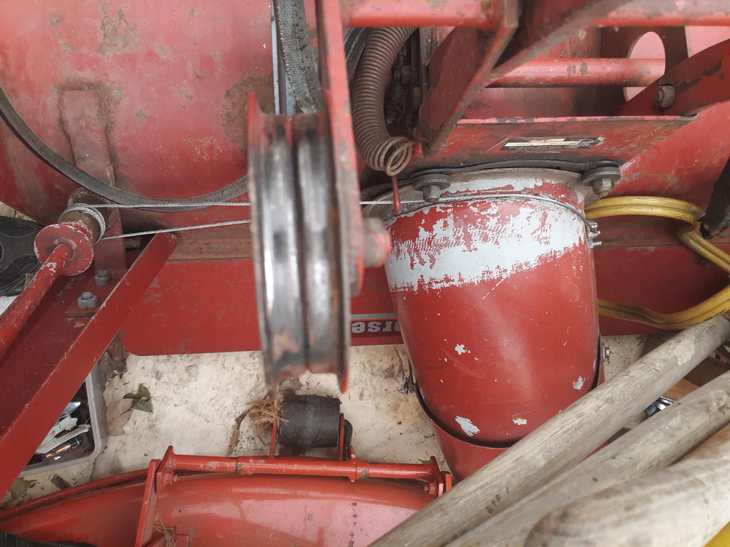

Cee245 877 #1 Posted June 2, 2019 This is my 42" short chute snowblower... Just noticed this today. The pulley I'm holding and pointing in the pictures is seized. I didn't know anything about it! I used the snowblower all last year and had no issues at all. It seems like it quit on the last use. Dumbfounded on this. There was no noticeable noise and the belt wasn't slipping. Seems that I just got lucky. Cory Share this post Link to post Share on other sites
Ed Kennell 47,821 #2 Posted June 2, 2019 Cory, looking at the belt, it appears it may have been sliding on the pulley for some time. Is there a shiny spot on the seized pully where the belt would have made contact? Anyway, now you have a tall chute for back up. 2 Share this post Link to post Share on other sites
ZXT 2,402 #3 Posted June 2, 2019 I agree with Ed. Looks like its been slipping a while, and that's probably why the belt appears to have a groove worn into it. Share this post Link to post Share on other sites

Cee245 877 #8 Posted June 2, 2019 I think you guys are correct. I'm surprised I didn't notice it and luckily didn't break the belt. Yes Ed, I'm looking forward to using the tall chute blower this winter. How much better is it than a short chute or isn't there much difference? Cory Share this post Link to post Share on other sites
Cee245 877 #9 Posted June 2, 2019 (edited) @Ed Kennell, you and the others are correct. You can clearly see in the pic of how it was rubbing on that pulley. Cory Edited June 2, 2019 by Cee245 Forgot pic... Share this post Link to post Share on other sites
Ed Kennell 47,821 #10 Posted June 2, 2019 Amazing how these li'l Red Tractors just keep on working....Even with seized up bearings. I've had people bring me running tractors with " noisy transmissions". I pull the belt guards off and find the idler/tensioner pully has no sign of a bearing. They still run fine If you can take the noise. 1 Share this post Link to post Share on other sites
